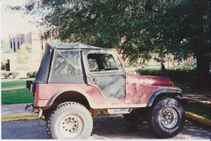

I'm in Cedar Park, TX outside of Austin in the Hill Country. My name is Jason, 48 years old. My first jeep was a CJ5 with a 4" lift, 304 V8 and 35" BFG's I bought in 1991 in college. I'm still sad I sold it when I got married after college to get a stupid Ford Explorer for work, ha. I went 2 full years with no top at all in that old girl, and loved every minute.
