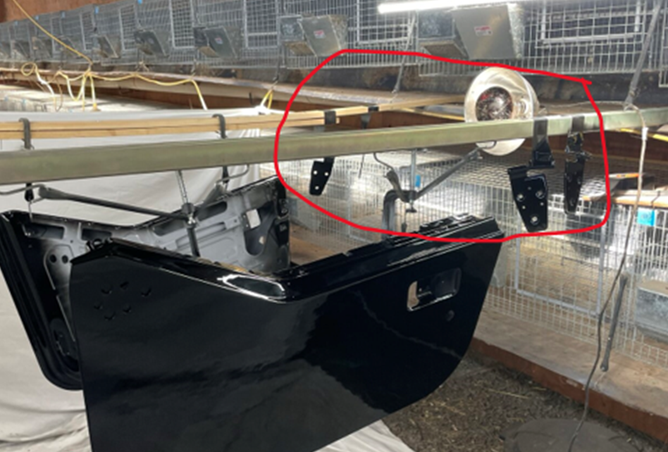

Nice work, Kiwi. How did you handle the door hinges?
So i saw that lots of people just painted with their door hinges still attached, but i thought if i was doing all the work to strip the doors down i should do it properly. Most of the torx screws stripped, so i drilled them out and replaced them with new hardware. And then just prepped the door hinges the same way as the door, taped off the hinge post so it would still fit in the jeep hinge side, and then painted them.

Believe it or not that was the best method to paint them lol
I tried first by hooking them by the hinge post, but they are not evenly weighted and fell off the hook multiple times during the primer. I also considered poking them in a cardboard box by the hinge post, but then was worried i would miss the underside of the hinge. Some duct tape on the post kept them sturdy and allowed me to get all edges!

I’ve got a couple sets of doors that need work I’ll probably steal your technique.

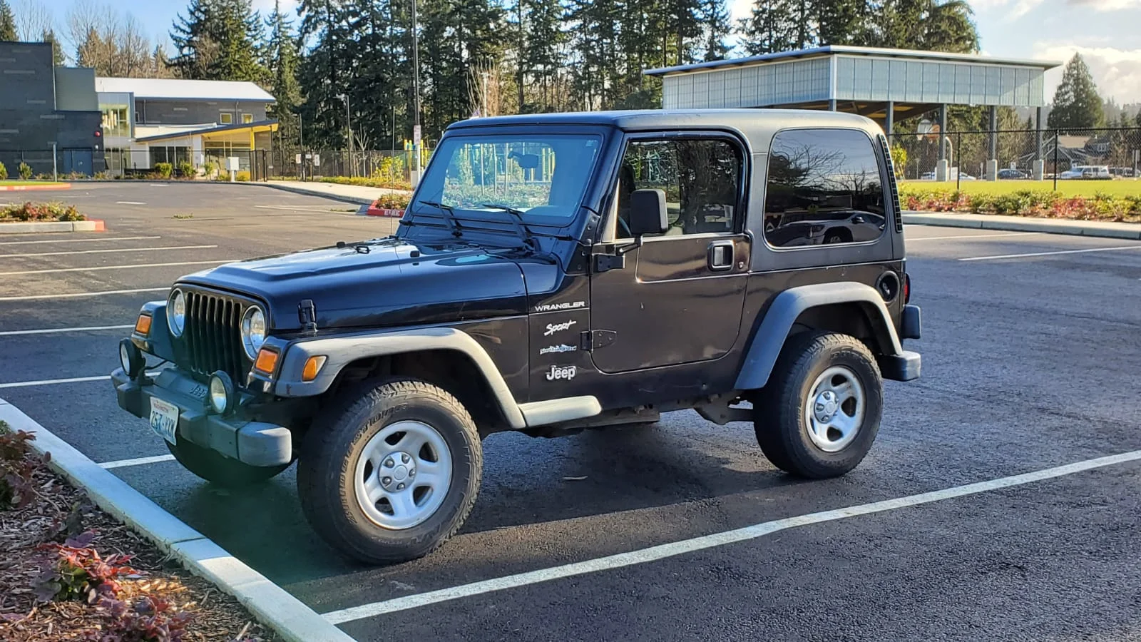

Hey everyone! I'm new to this forum, and new to jeeps, and wanted to document my build for anyone interested
After a long search for my perfect TJ, i finally found one. Jan 13, 2021, drove 4 hours round trip and picked up a 2002, one owner, 96k miles, manual, 4.0, and it was mostly stock too. This will be my daily driver, as it's my first vehicle ever. Over the past couple months I've given it a huge clean, replace a dented body panel, replaced the front u-joints, and cleaned up the frame. All while saving up for a lift and some new wheels and tires.
Here it is the day i got it (Came with a hardtop and soft top)

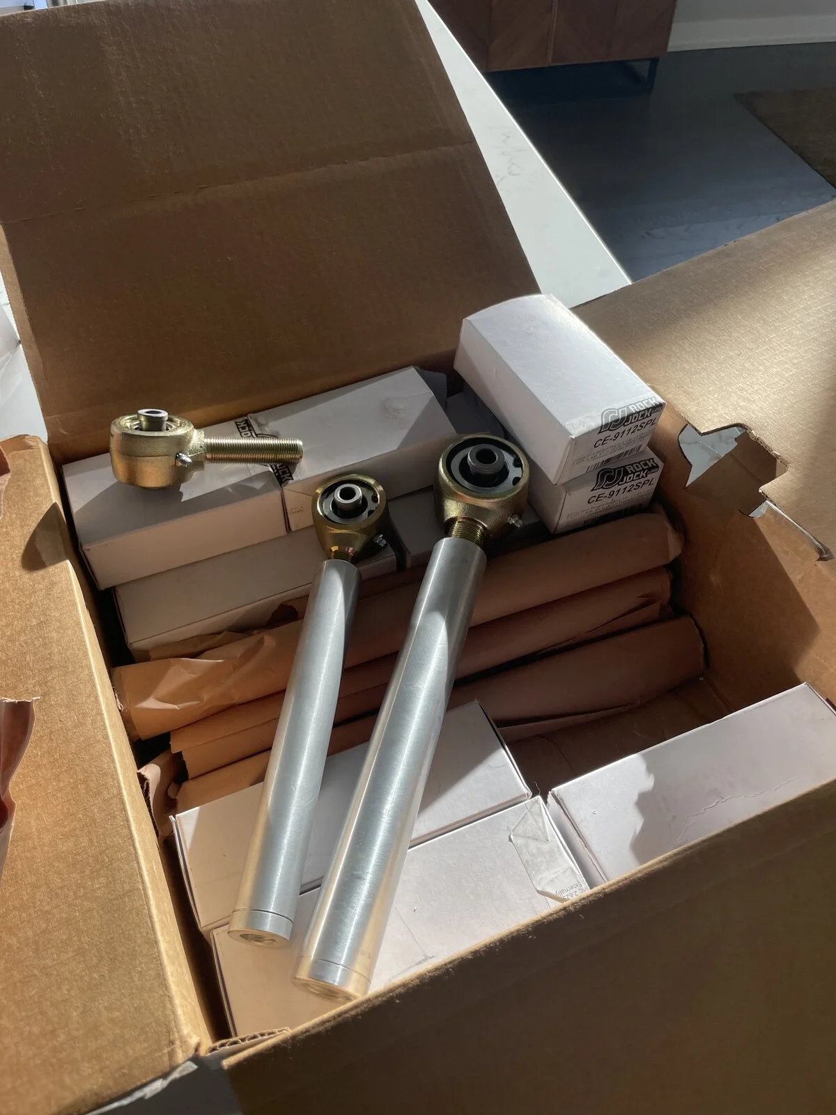

Expensive week
Picked up some barely used currectlync, rubber boots are even still in good condition
Then decided to finally pull the trigger on a york OBA kit. Just need to get the compressor itself
And finally ordered a Savvy CA set. Want to try and get a TT done, and wanted to get these in case savvy stops production on them

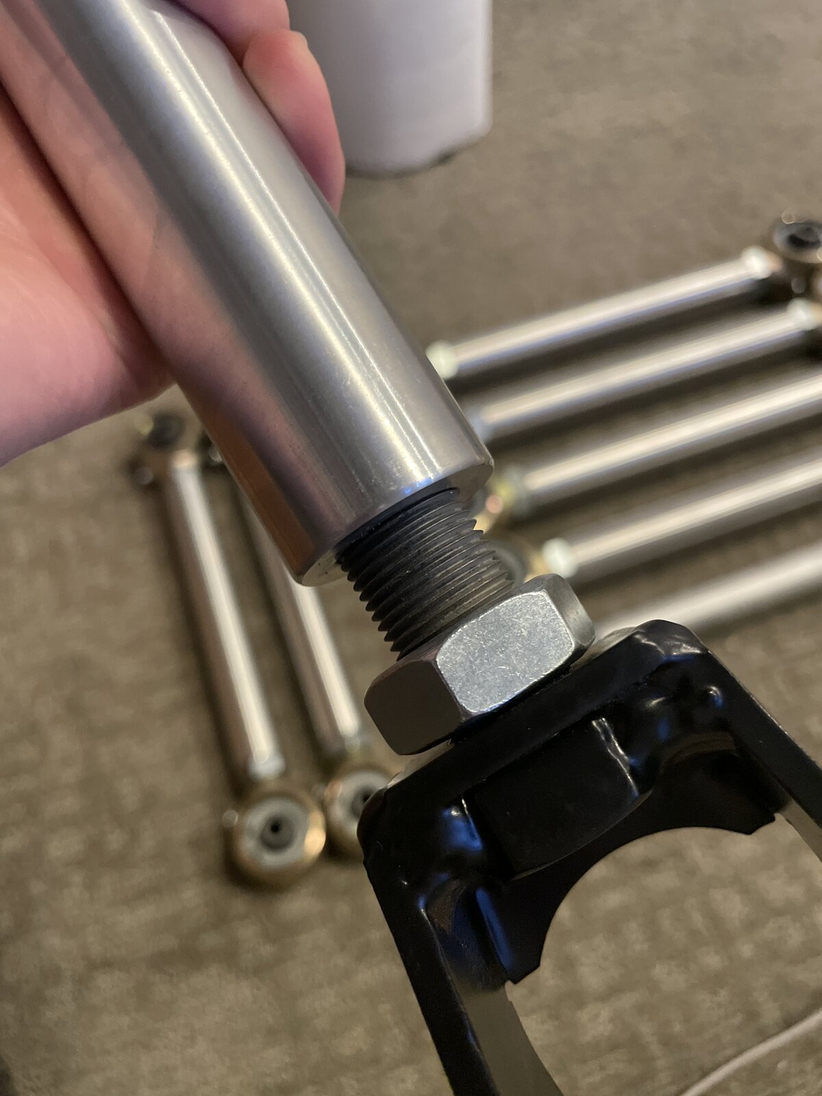

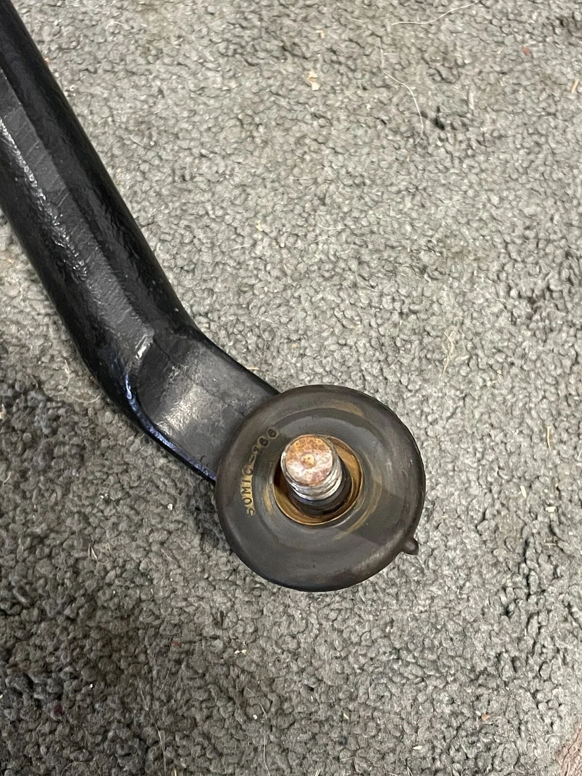

I am however having issues with the axle bracket. It does not want to thread in fully. Looking in, it seems like the threads just stop before the bracket is fully threaded in. Has anyone had this issue before?

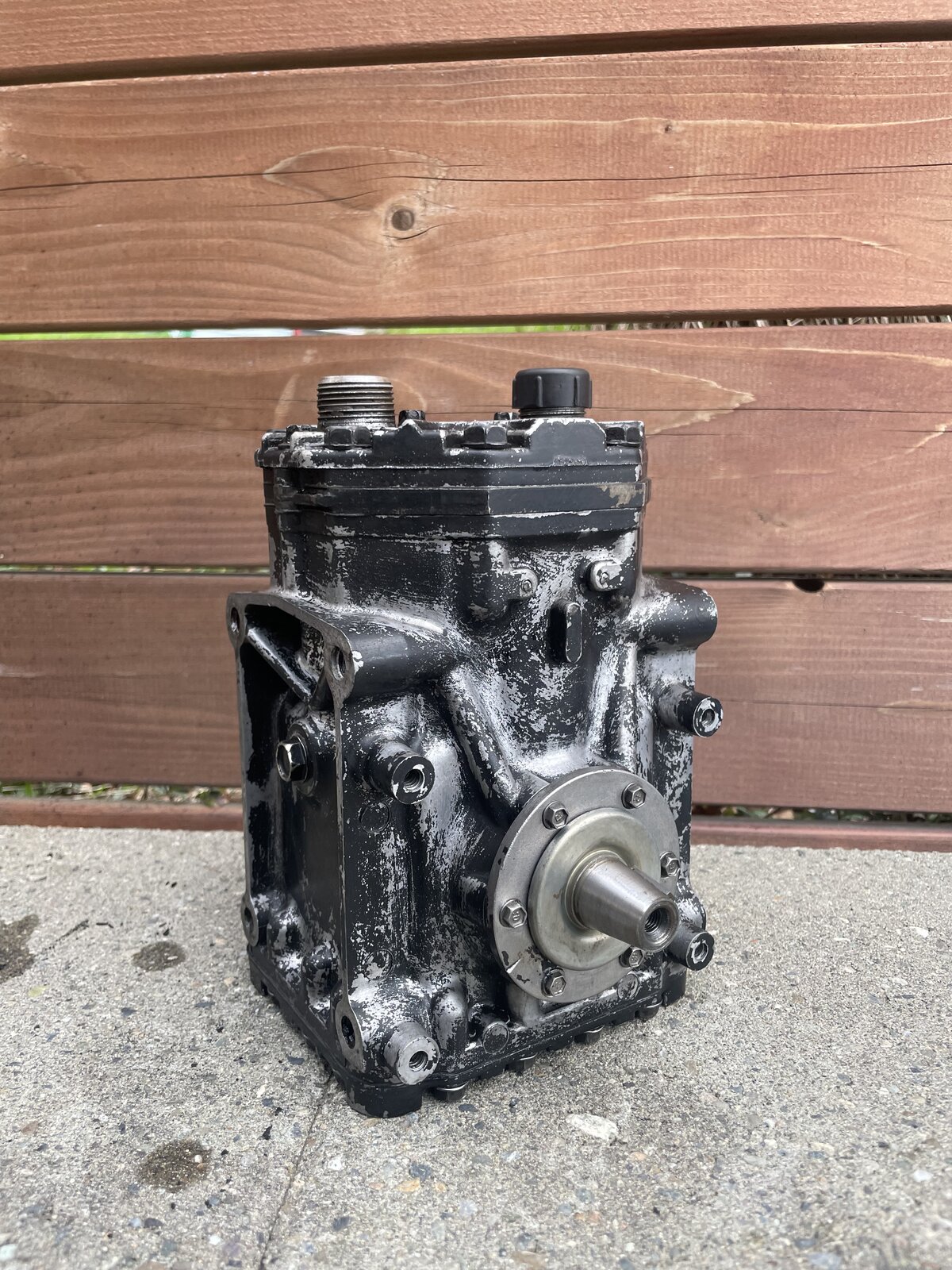

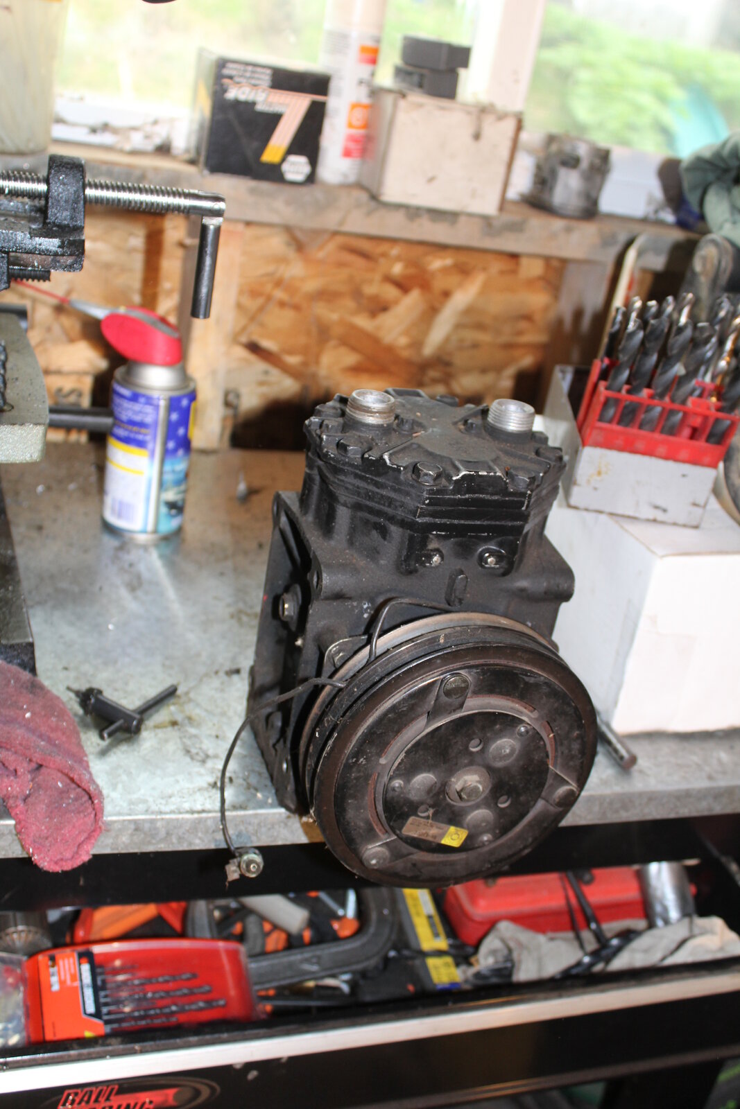

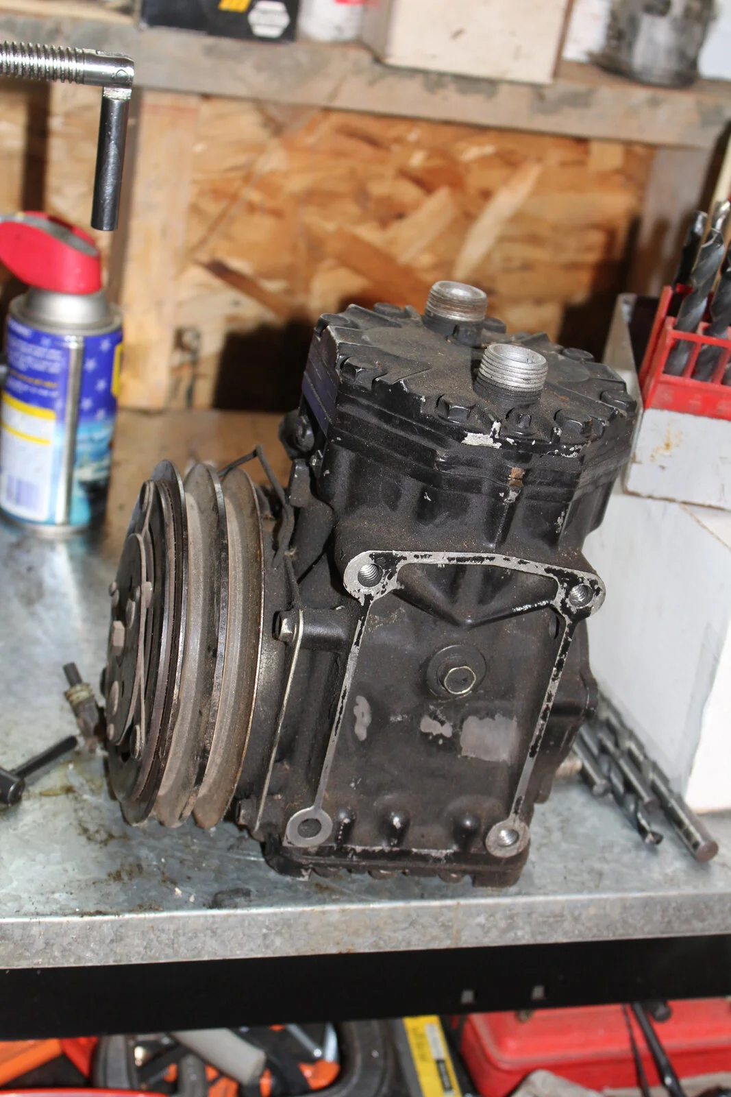

Finally went and picked up the York compressor from @Wildman

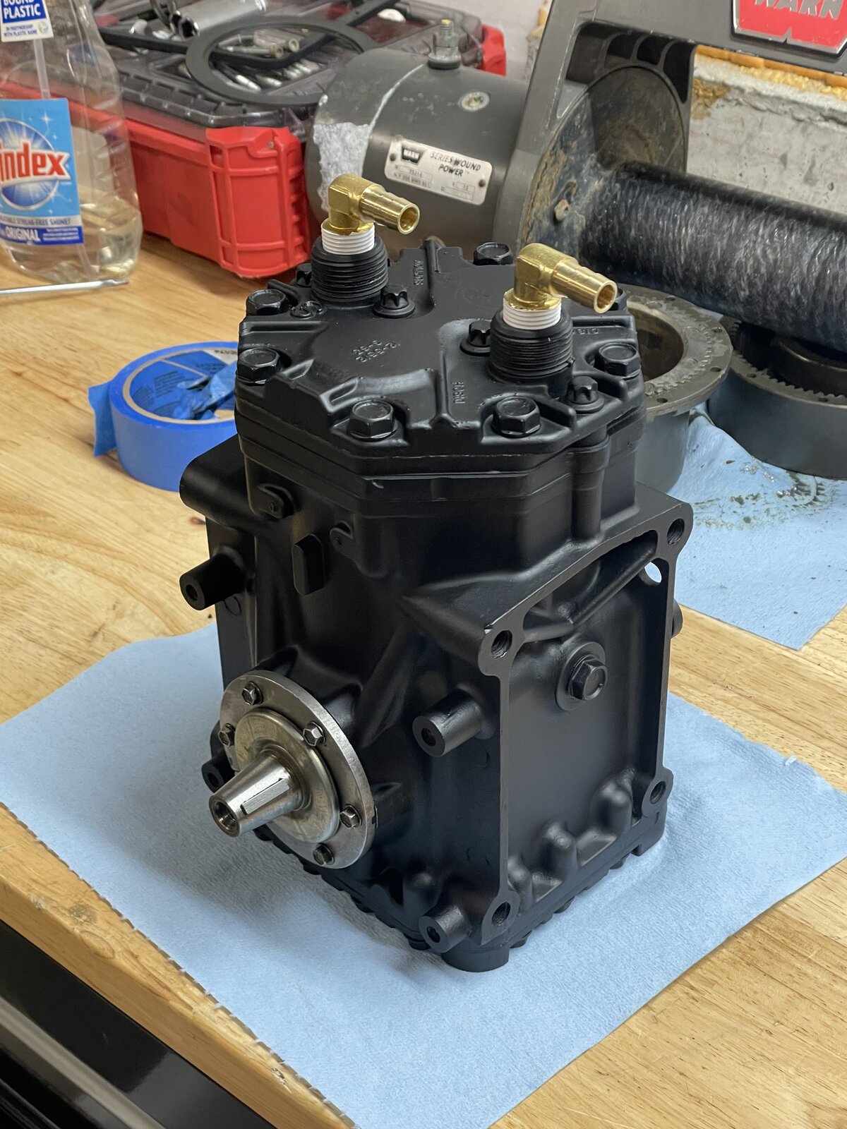

Cleaned it up a bit and gave it some paint

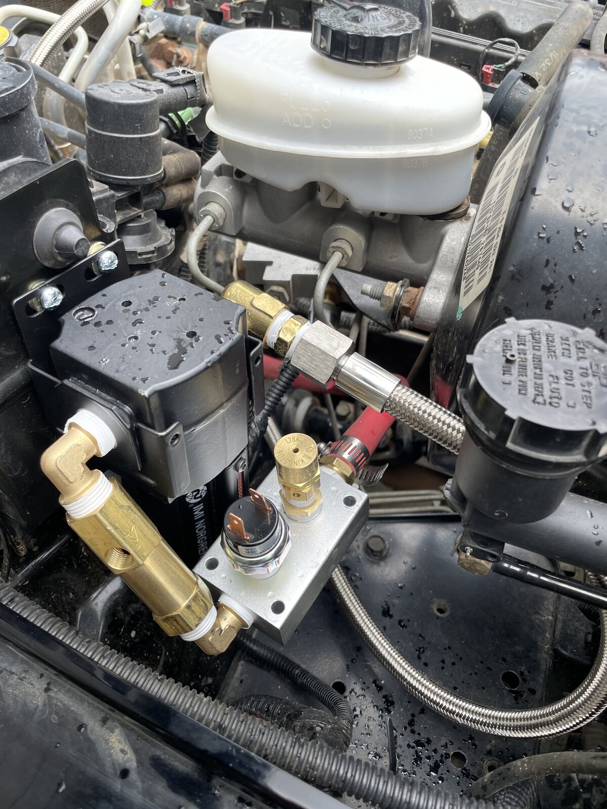

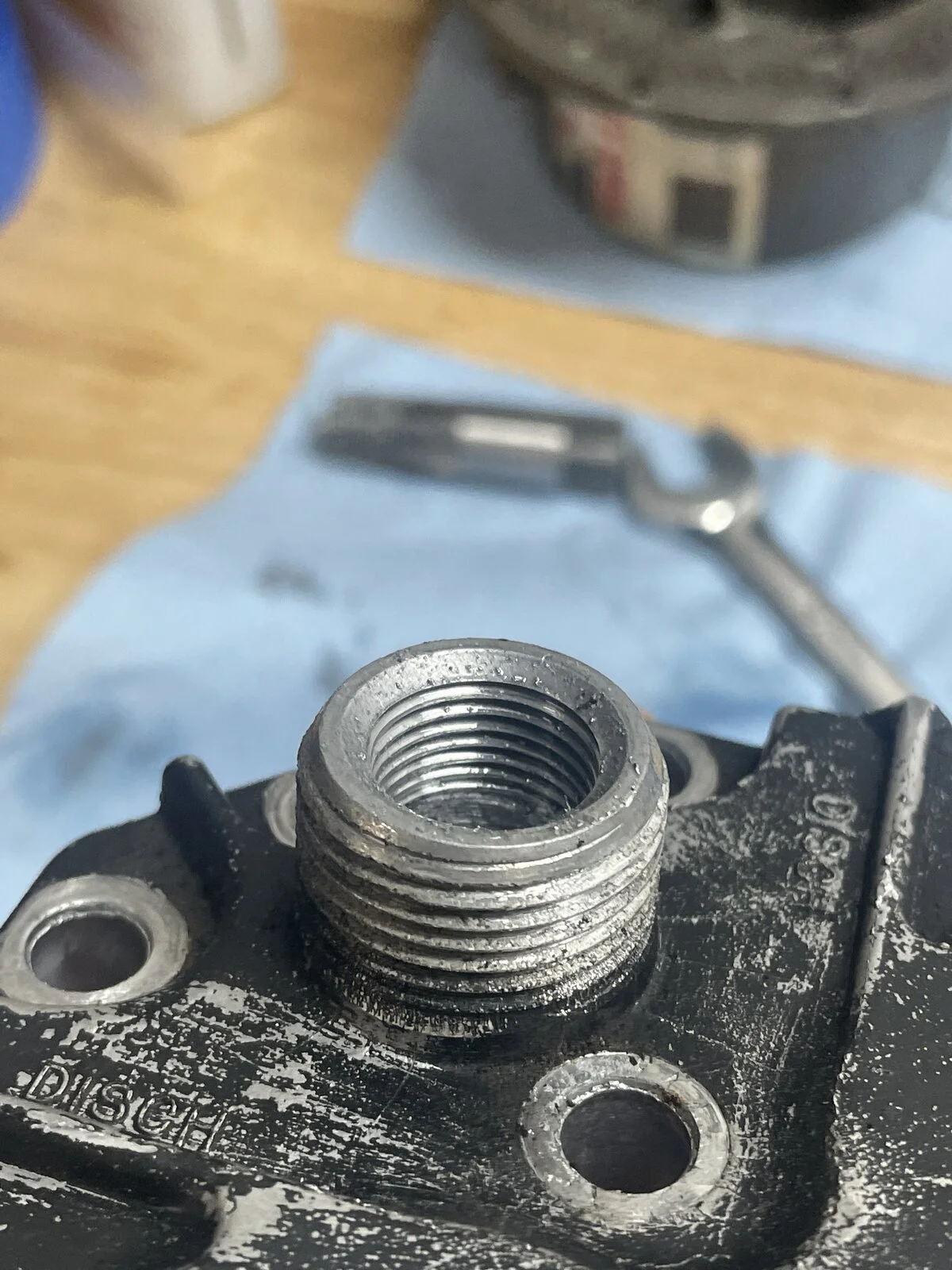

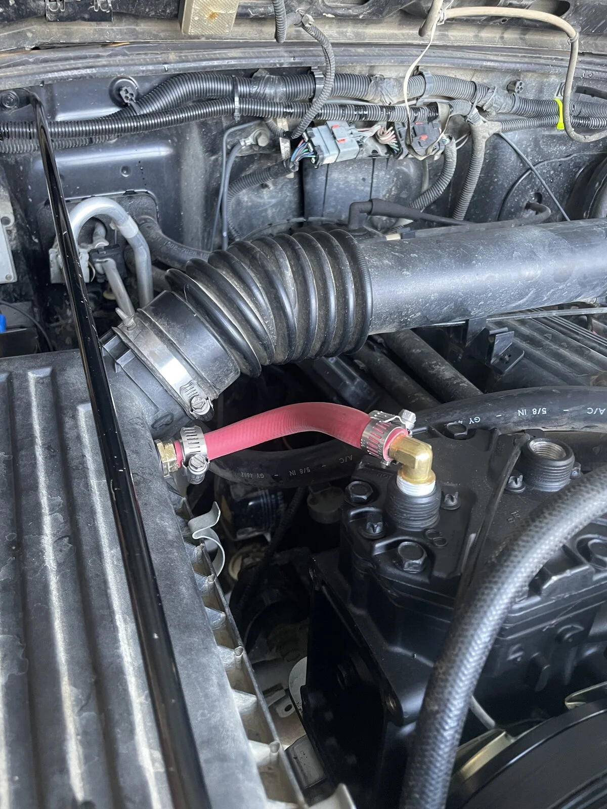

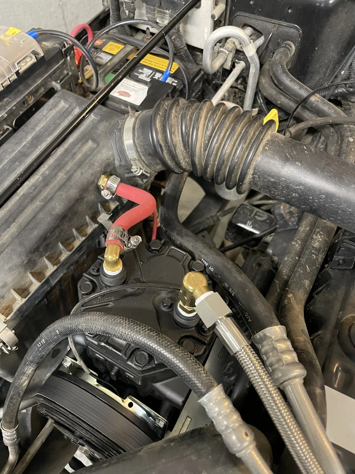

I also didn't want to spend 100$ on some York fitting's, so i drilled/tapped the inside of the head with a 3/8th NPT tap to accept 3/8th elbow's

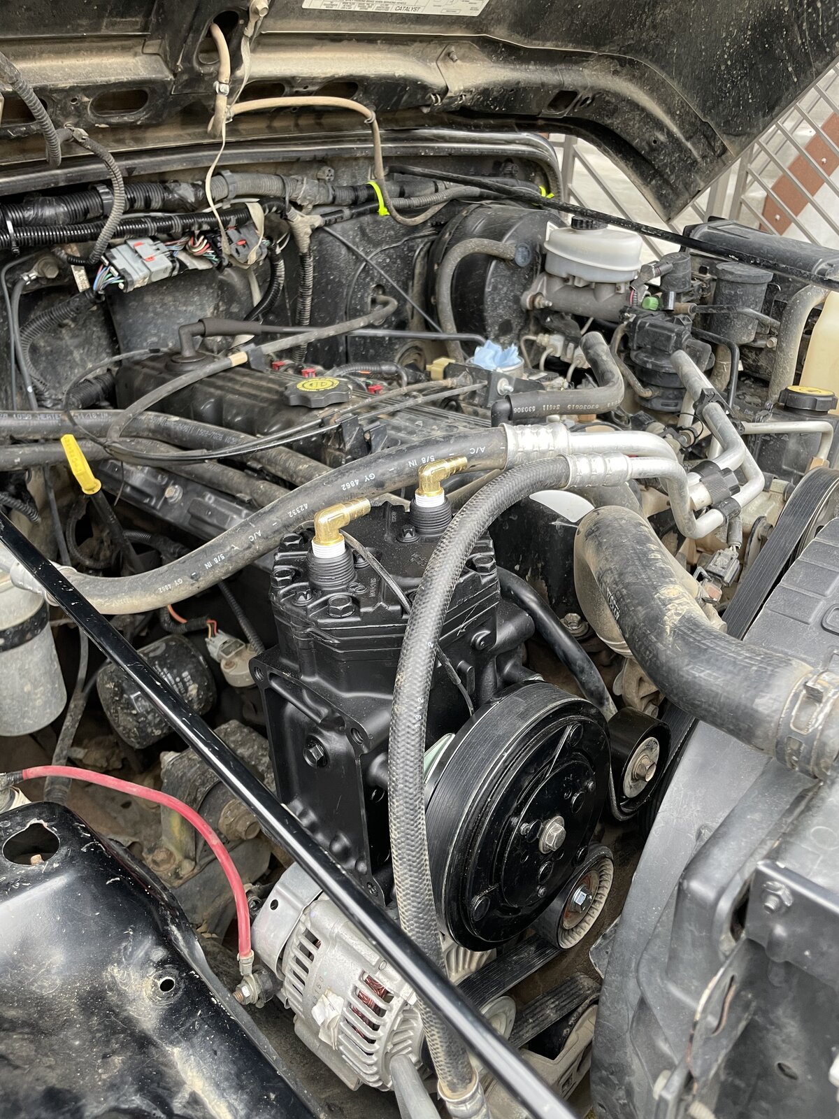

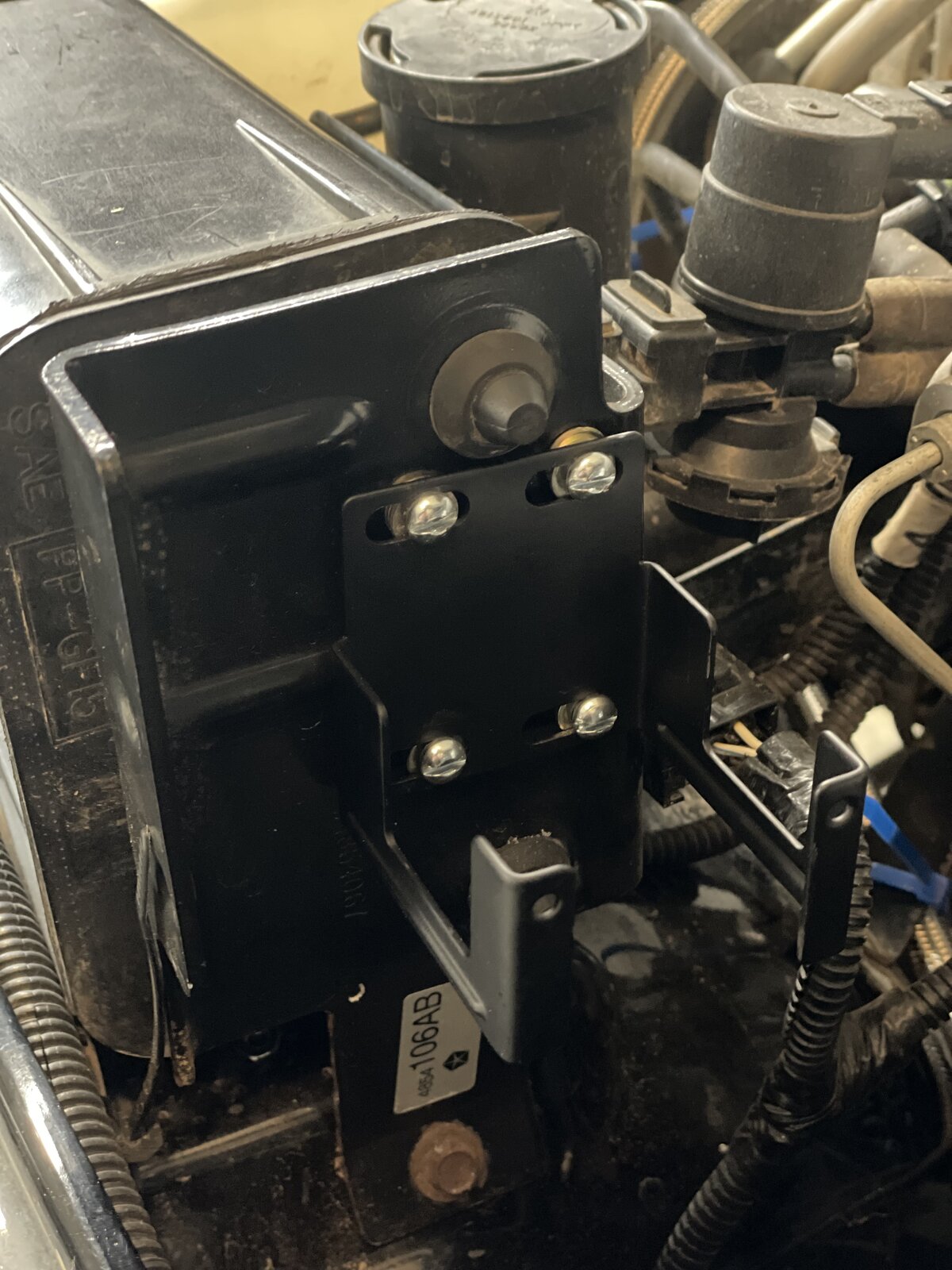

Got it mounted with the ORO bracket kit, which went in trouble free except the belt was slightly too short so i replaced the idler pulley with a slightly smaller one and it works fine

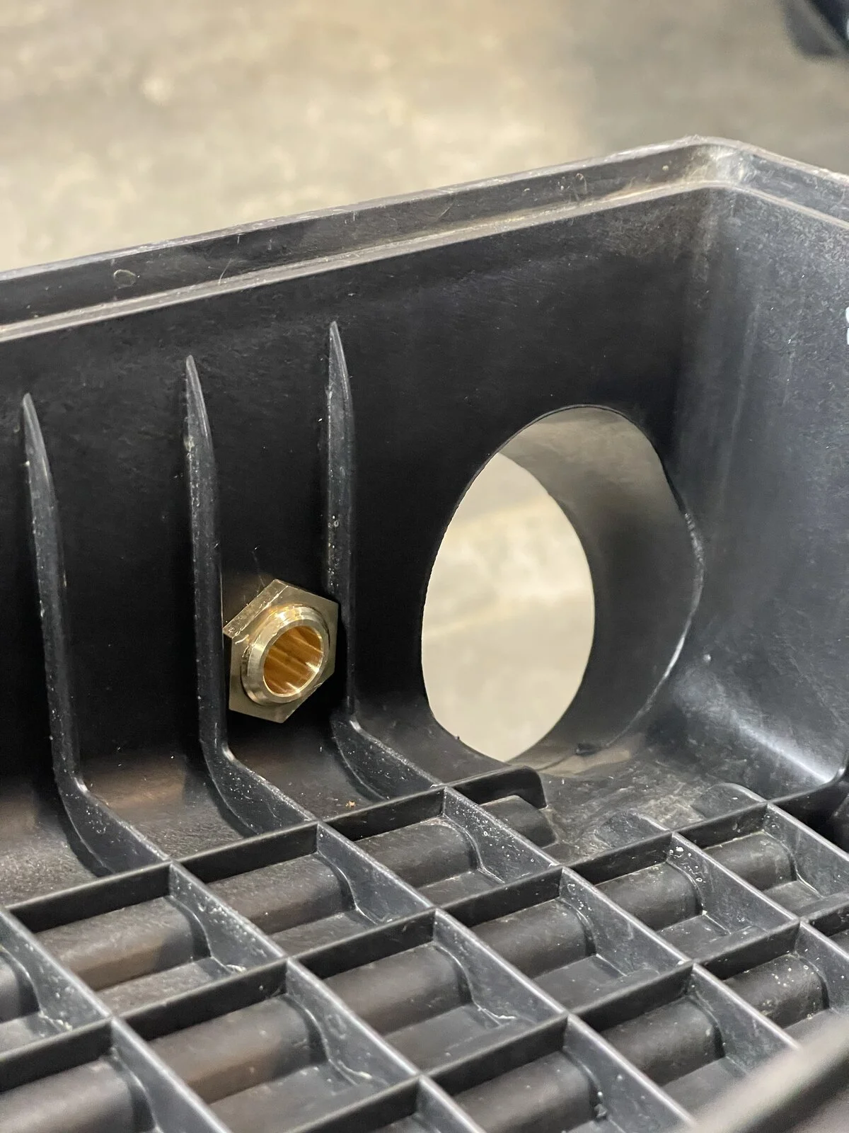

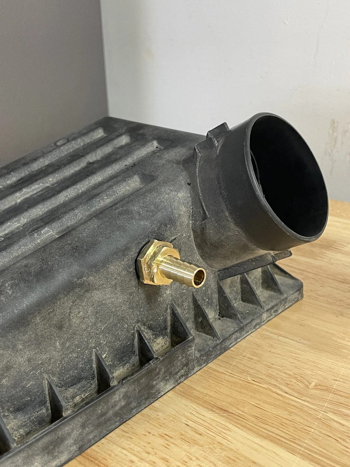

For the intake I drilled into my airbox assembly and added a 3/8th barb

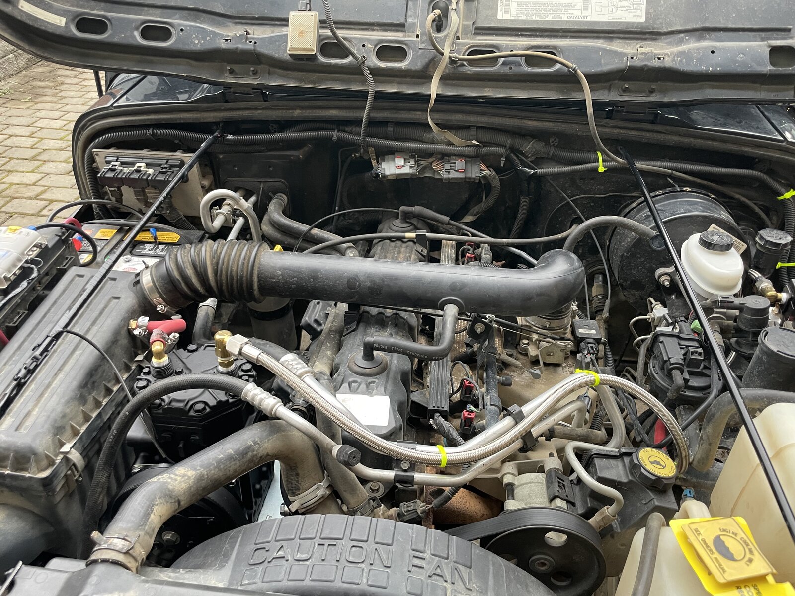

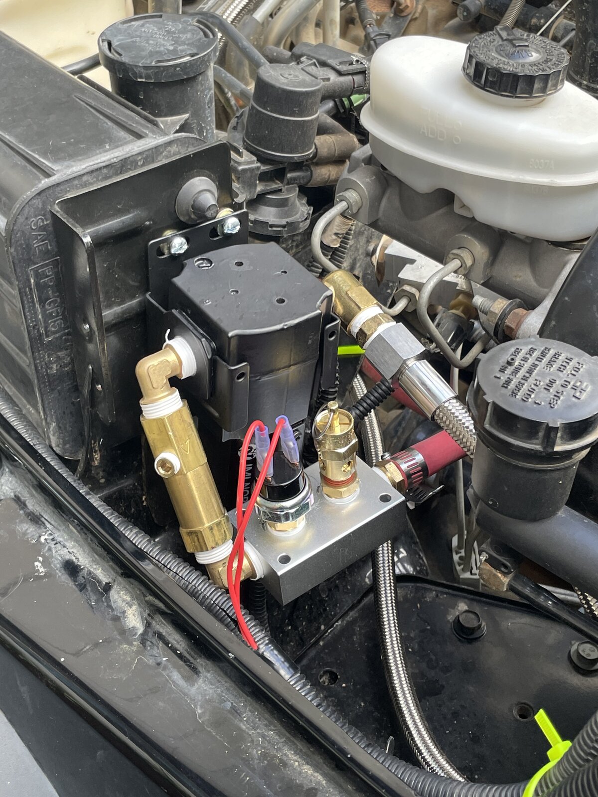

For the Manifold and the rest of the routing, i initially planned on doing something like @DylanM345, with everything mounted beside the York with an in-line cooler, but after mocking up a few brackets it was clear that it wouldn't fit with the stock air box, so i eventually decided to mount it across the engine bay
I ran a braided hose from the York so that it was temperature safe

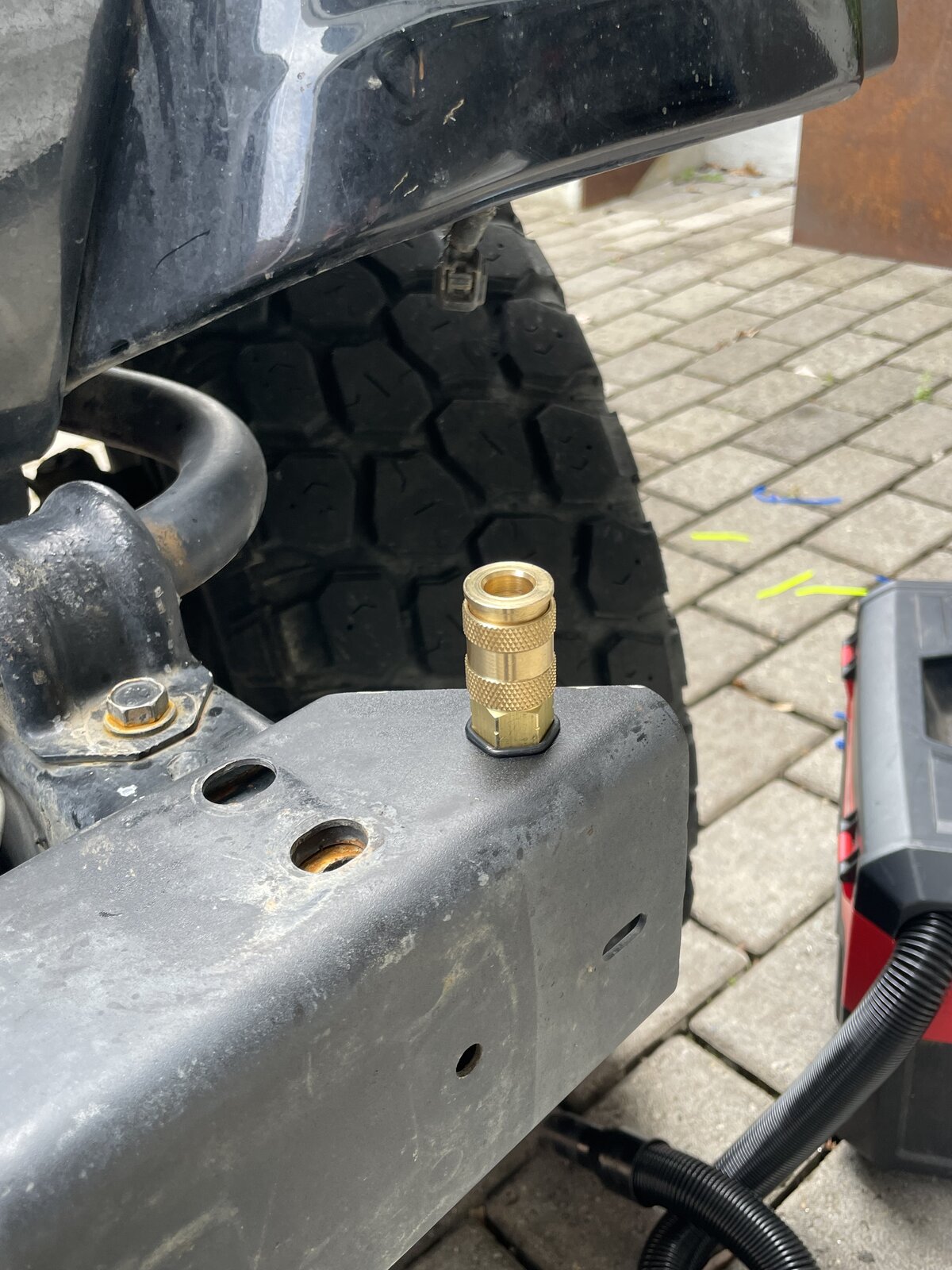

And for the quick connect i routed it to the front bumper
I might eventually have one going to the rear bumper as well, but for now i have a long enough air hose to reach all four tires

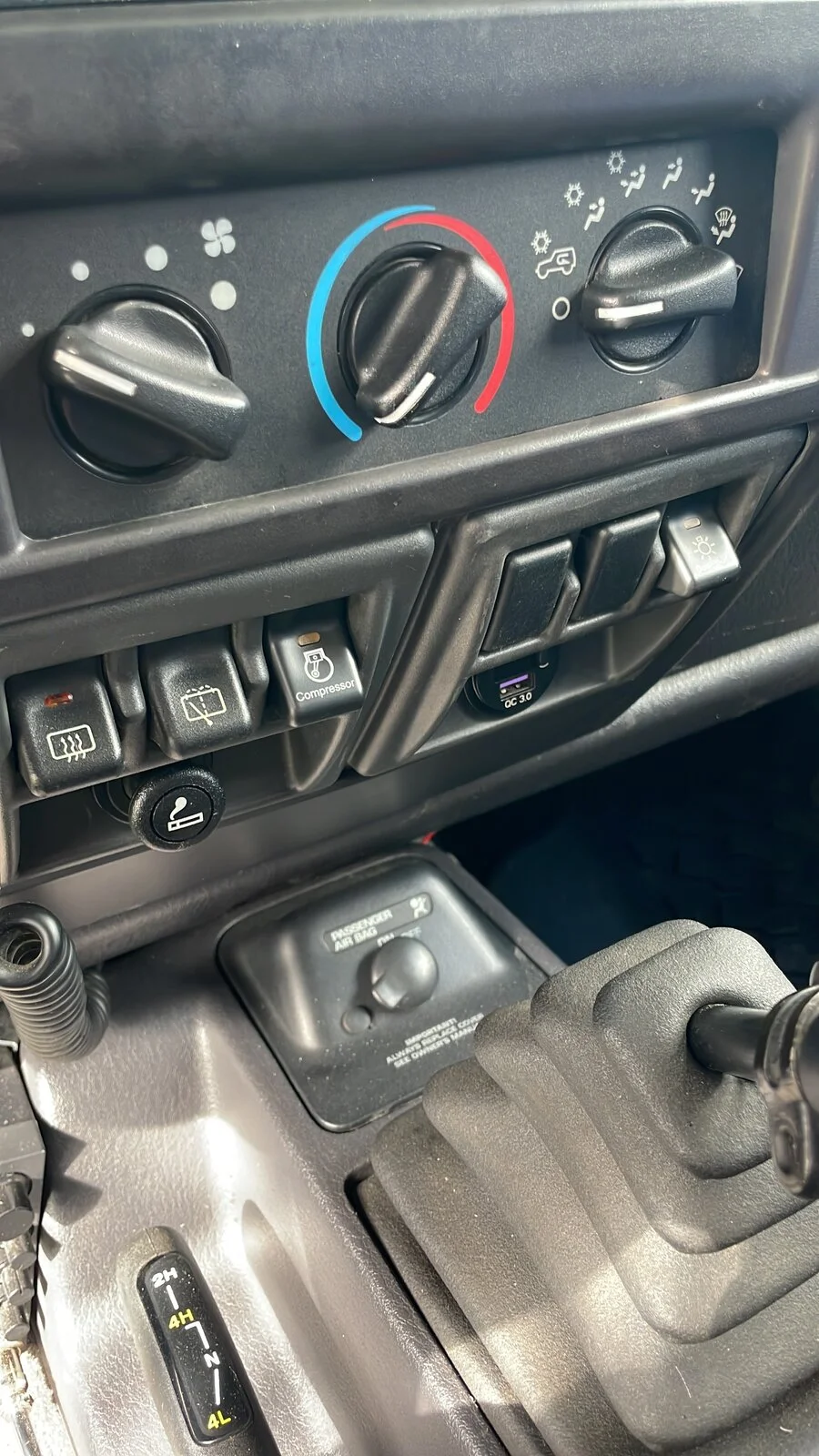

Then for the switch i wanted an In-cab factory looking switch
Heres the final product:
Everything works great and fills from 12 - 26 psi in about 30 seconds. Thanks again @Wildman and @DylanM345 for answering my many questions

Looks like your quick disconnect needs a pacifier.
https://absolute-wits-end.com/engine/on-board-air-oba/
