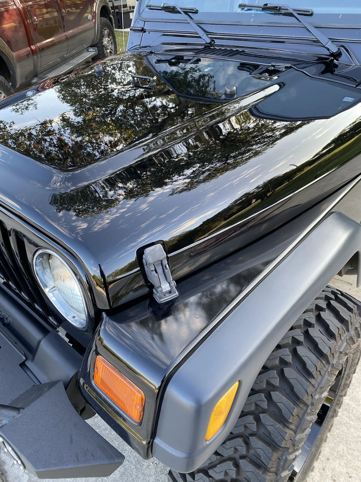

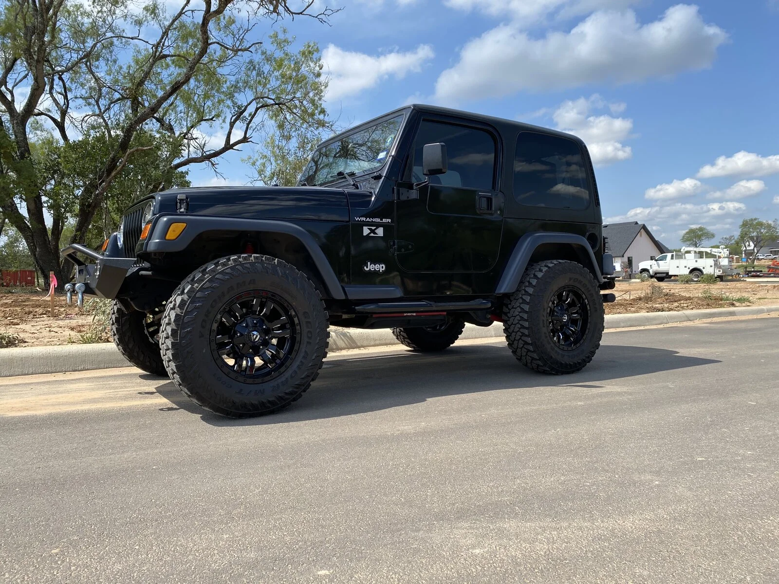

Alittle at a time I have been replacing various bushings, spark plugs, engine maintenance, front bumper, wheels and tires etc. Removed the hood and wiper cover and had it painted,
But man she is a dog on the highway with the the new 295’s. Also currently building a rear bumper with swing away tire carrier.
Really been fighting that $1700 gear swap. Is it really worth it?

Looks like pretty big meats you have there. I went from 3.07; to 4.10 and was like a new jeep....but I found axles with 4.10s on craiglist for $200 for the pair so a much easier decisions for me. They were d30/d35 not the d44 but had a d35 so really no lose.
Jeep looks great!

Also, try to keep the weight down with aluminum parts. That steel bumper isn’t helping one bit 😉

Man, the hood looks great, and you have the right color IMO lol! I've gotta do something with my hood as well. I bought another black one but I gotta clean it up and likely buff it.
