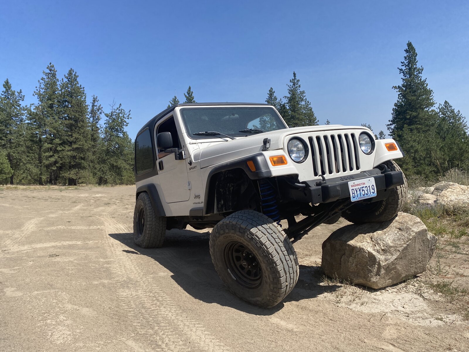

Virgin run. Trying things out. They were amazed at what they could do. I may be in trouble. This might not have been a good idea after all!
Yup - the wheelin’ bug is crazy contagious - and chronic! Great to see you enjoying this with your boys, JMT.

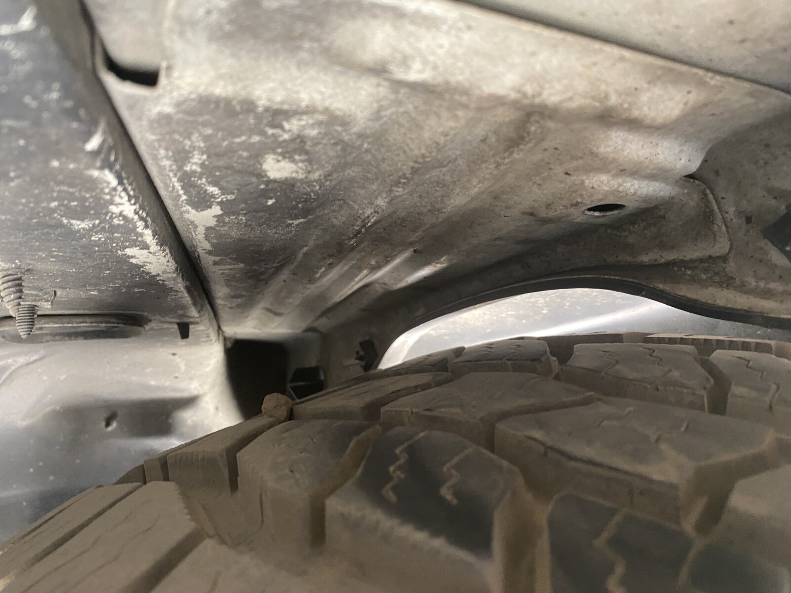

Talked to the boys after yesterday's short run and they want to add the 1.25" Savvy BL and remove 1" of bump. I think it's a good choice. I also think it will look better, but I am used to a lot of space between the tire and the fender.
Agreed, it will prob look better than this 😏🤞
Reactions: JMT
You better watch out, of they're going to have 35s before your do!
They were already talking about 33’s tonight! They were asking, ”Can we do the MML and BL and adjustable rear trackbar? Do we need a bigger spacer to get where we can run 33’s?” I said, “No, no, if you add the BL, you can run 33’s and your bumpstop will be the same because you’re adding 1.25” of clearance for the tires and 1” of tire. “But what if we want to add a spacer?“ “Then you’ll be into SYE and CA Land.” “Oh, okay, let’s just do the MML and BL and adjustable rear trackbar for now. Then can we do a real trail like Denver Creek? Except I don’t think we can do the Waterfall yet.” “Me: “Yeah, we’ll go. You can try the Waterfall.”

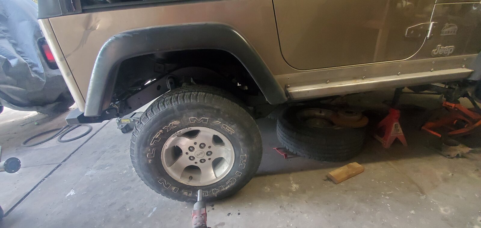

After the first outing to wheel this rig we got home and they couldn't start the rig. The battery had only 9.5 volts at the terminals, so I went to Costco and got a Group 34 Interstate 800CC Amp Battery. They were also having some strange transmission feedback when starting since the day we dropped the pan and added 4 quarts of ATF+4. So we warmed the engine up and checked the levels. It was low, so I added a half a quart and we will see if things are better. Topped off the radiator with some coolant after the thermostat and water pump debacle. That's in order now. We're just working out kinks.

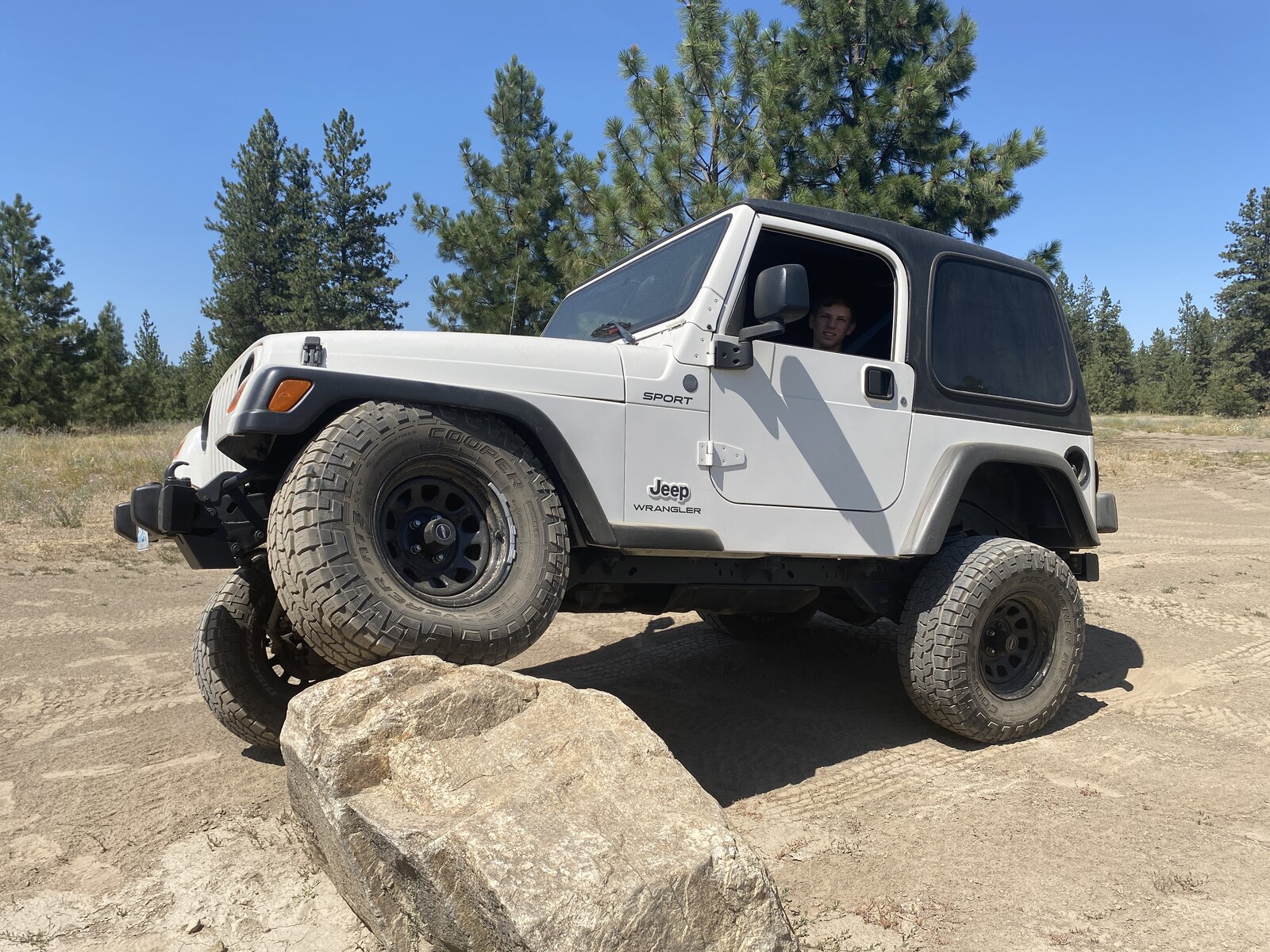

Afterward we went out for our second wheeling trip. I'm not sure there are many places I can go that they can't go. That thing is amazing on 32's open! Very instructive after 4 years of fiddling with mine.

So many people underestimate what stock-like Jeeps can do. I've wheeled them with 30" and 31" tires in some very difficult terrain and, as you said, there are very few places they can't go that a rig on 33" tires can. Teaching your kids about maintaining a vehicle, coupled with off-road driving techniques are valuable lessons they'll never forget.
I'd argue that driving a Jeep on smaller tires is more fun than driving one on larger tires. You need to listen to others, concentrate, and learn the consequences of not picking the correct lines. You sir are a fortunate man to be blessed with two Sons that share a passion with their Father. You would think this is common, but it's not as common today as it should be! 🇺🇸
