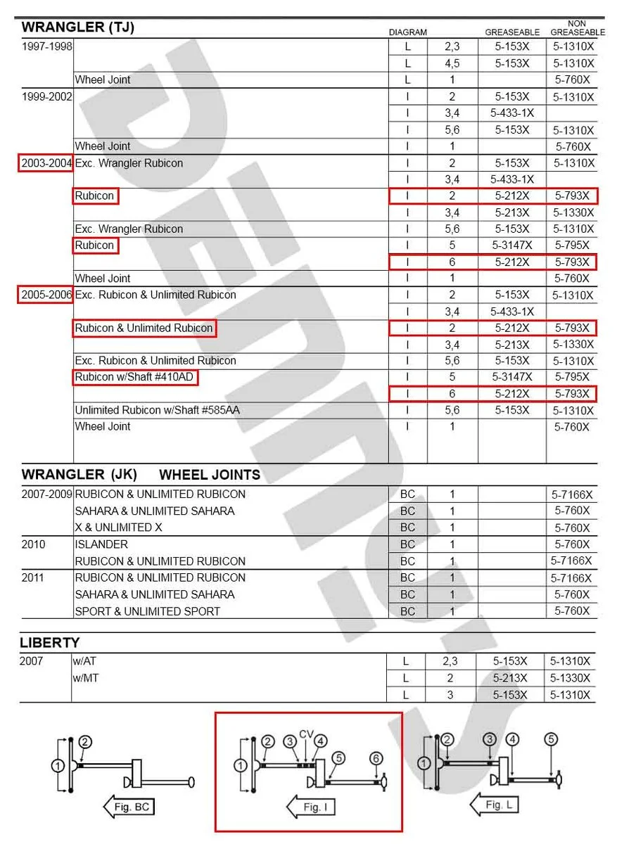

Hey y'all,
I recent lifted my 04 Rubi 4" and I believe my drive shaft u joints need replacing. What do you recommend and (dumb question) are there only 2? I need both front and rear driveshaft u joints. Thanks!
-Lou
How about this as a reference?
