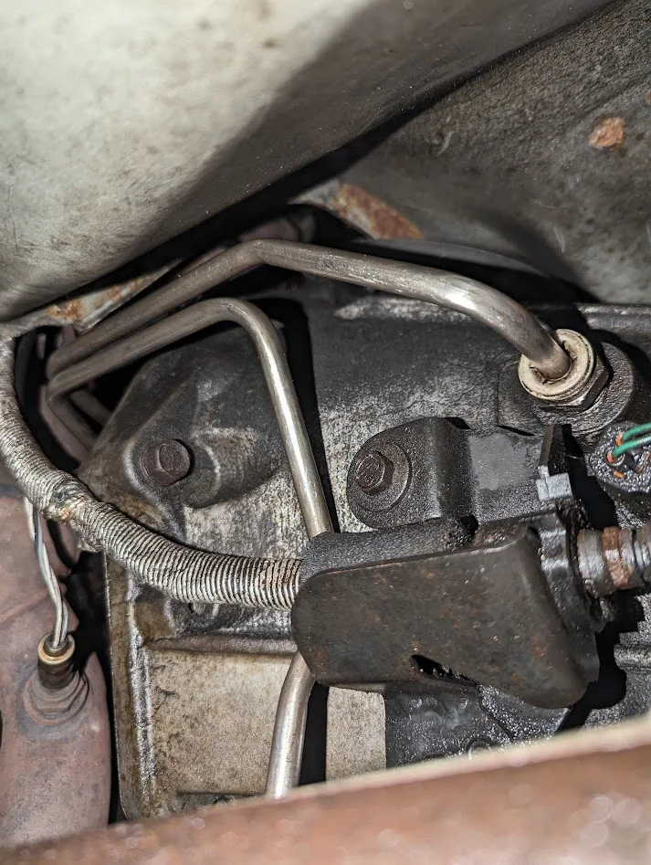

I had my exhaust out. I don't see any way you could do it without moving the exhaust.
I'm pretty good at sneaking the exhaust out by twisting, turning, tweaking etc. to get it over and around bits on the rear axle and I can see no way to get the trans cooler lines in without dropping the exhaust and I've tried.
Sadly I was kinda thinking that, just by the path of the lines. 🥹🥹 I have my rear main on my to-do list too.... Maybe I try and get the exhaust down and tackle that to. Bolt access on the exhaust is like zero too erghhh
Maybe my mechanic's method of cutting the lines and installing them in two halves wasn't so crazy after all. :unsure:

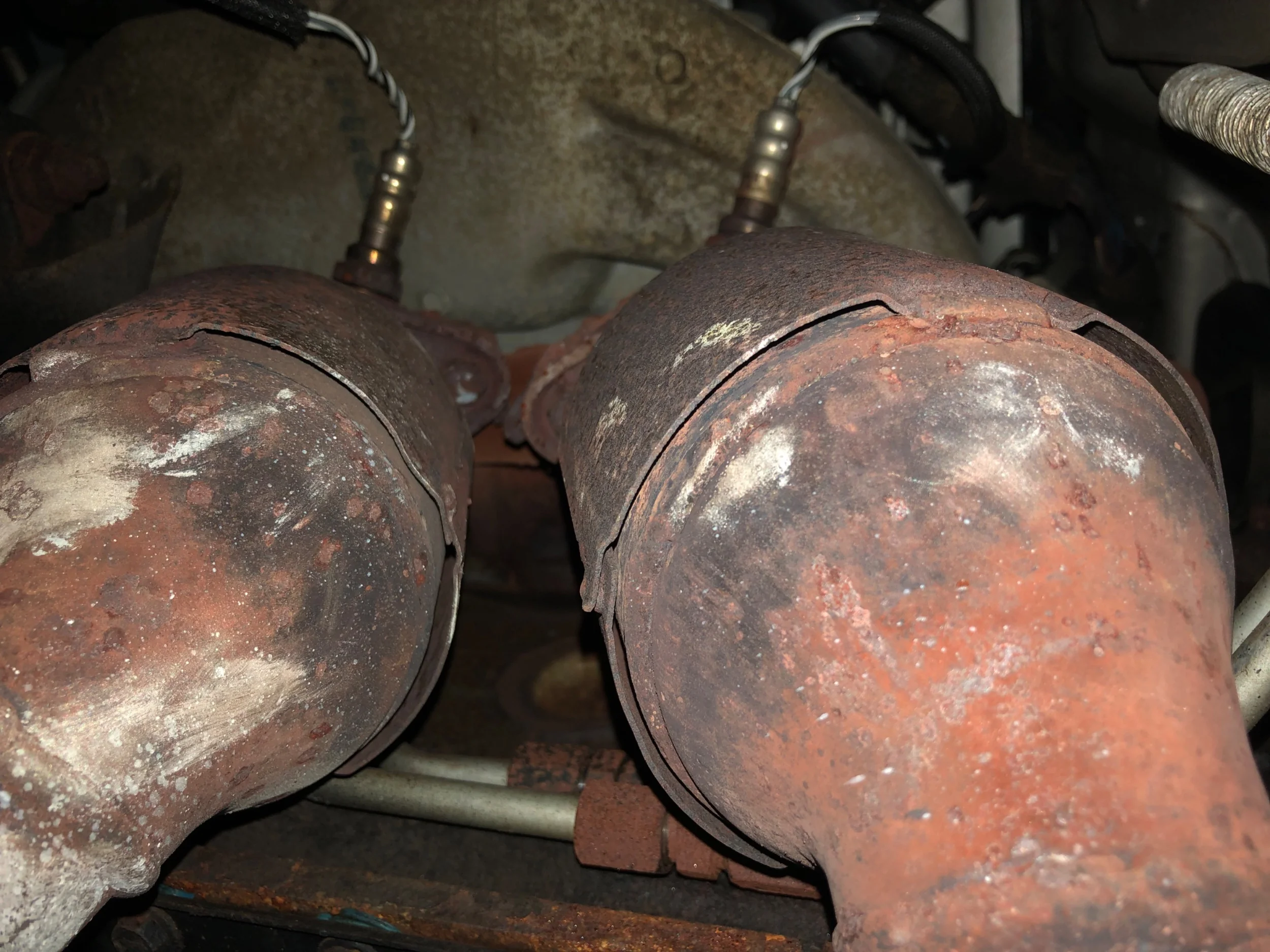

But - update: Was able to relatively easily disconnect the Y pipe portion which gave enough wiggle room to get the lines in. I disconnected my 02 sensors to get the wires around, but did not remove them. What worked for me was feeding from the transmission side, towards the front. I can't say it was pretty, and took them in and out 4 times because I was not sure it was right, but think its good to go. I ran out of Brakleen and wanted to clean everything up before making the connections, so that will come later in the week, fingers crossed should be good now.
@mrblaine thanks for the suggestion on pulling the mud skirt - gave a great line of sight for the exhaust. From that angle I looked through and used a socket on each bolt, barely able to move 1 or 2 teeth on the socket at a time, but slowly got them all out.

Update to close this one out.... Once i disconnected the exhaust downpipes, I was able to twist and turn and slide and otherwise coerce the new lines into place. It wasn't the easiest, and was like a rubiks cube over and over, just upside down with rust falling in your face. But they are in! Having the mud skirt off was the only way I was able to get the exhaust disconnected. Even with wobble extensions, I was only able to get a good line on one of them and ended up just peering through over the frame and using a socket to get those bolts out, then back in. Not the most straight forward, but at least I no longer have transmission fluid dripping :-)

I can try to get a photo, but it was just forward (8-10 inches) of where the fittings go into the transmission.
