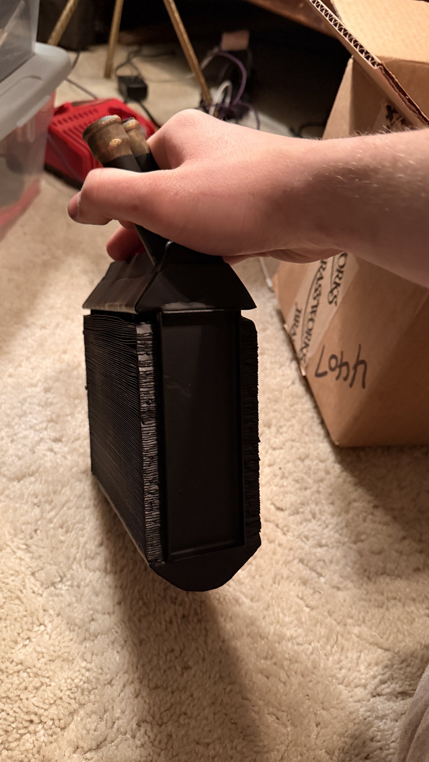

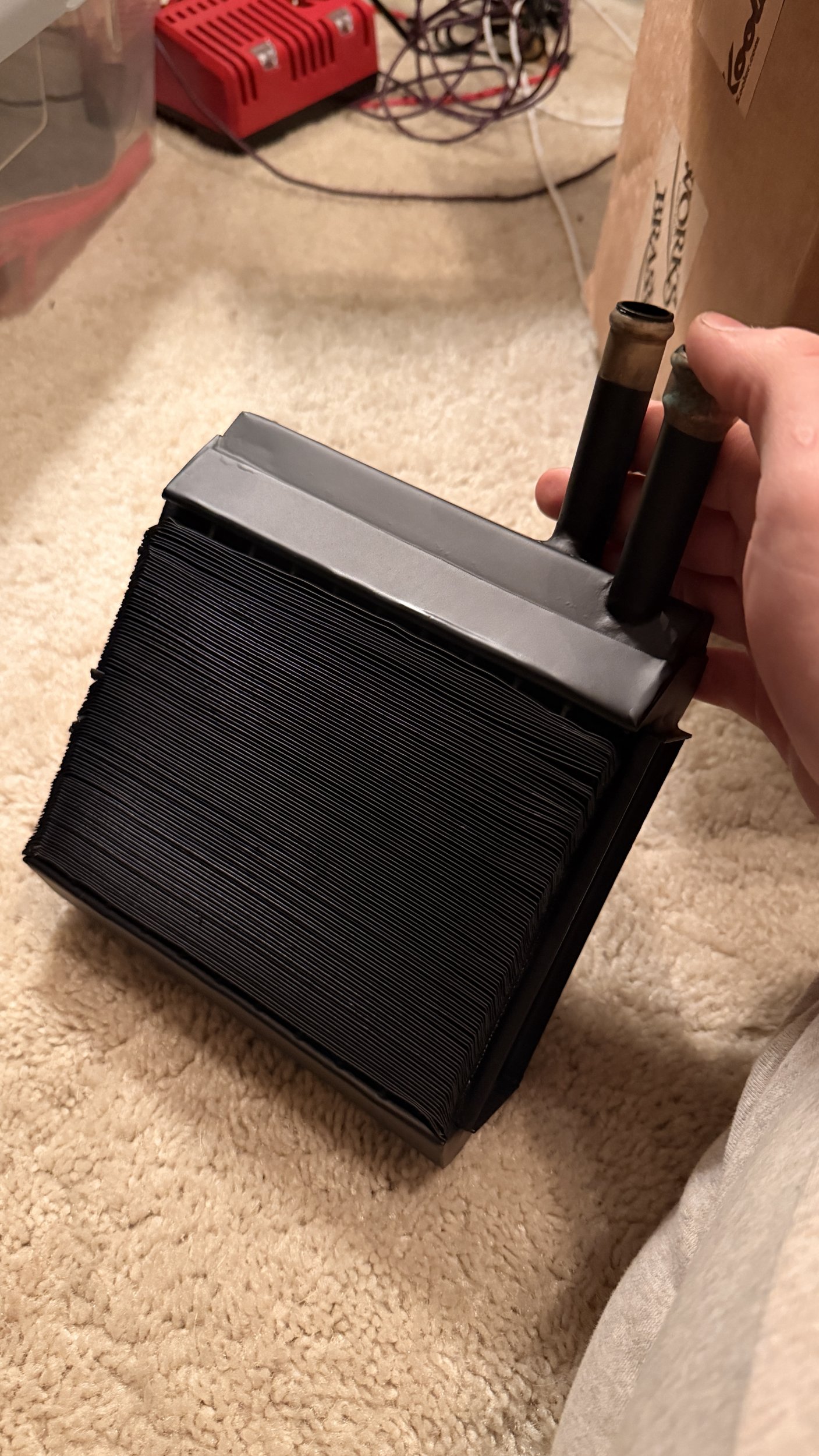

Just got mine in today, ordered it on the 4th of December. Hoping to replace it sometime soon and see if it’s good after hearing good news about it. Gonna replace my thermostat with a 190 since it seems I’m stuck at 180 atm after building the stroker.
Just got mine in today, ordered it on the 4th of December. Hoping to replace it sometime soon and see if it’s good after hearing good news about it. Gonna replace my thermostat with a 190 since it seems I’m stuck at 180 atm after building the stroker.View attachment 662225
Dang the fins look tight! Can’t wait till you get it installed. Hope for the best.
My factory heater core had tight fins like this guys has. My aftermarket summit one are wide but seem to work fine for where I live.

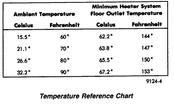

And the Brass works core puts out really good heat
At 60° outside temp i saw 161° out of the floor register
