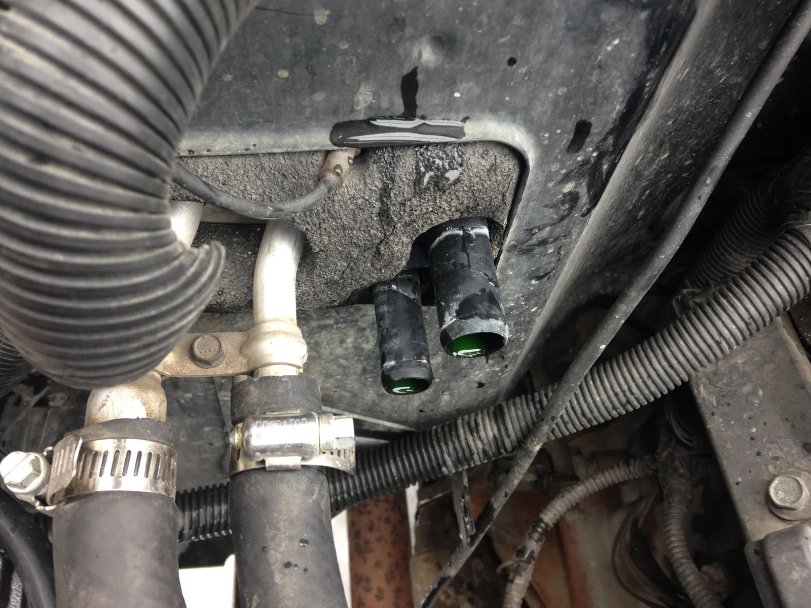

If you have AC and don't use it, just switch ther hoses. I did this cuz my TJR is a daily driver and it was a 5 minute fix.
Incredibly the heat off the AC evaperator was 130F, the heat off the heater core was 100F.
