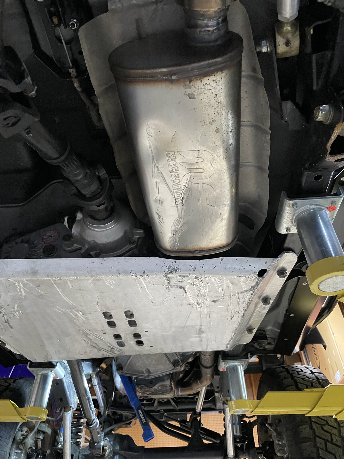

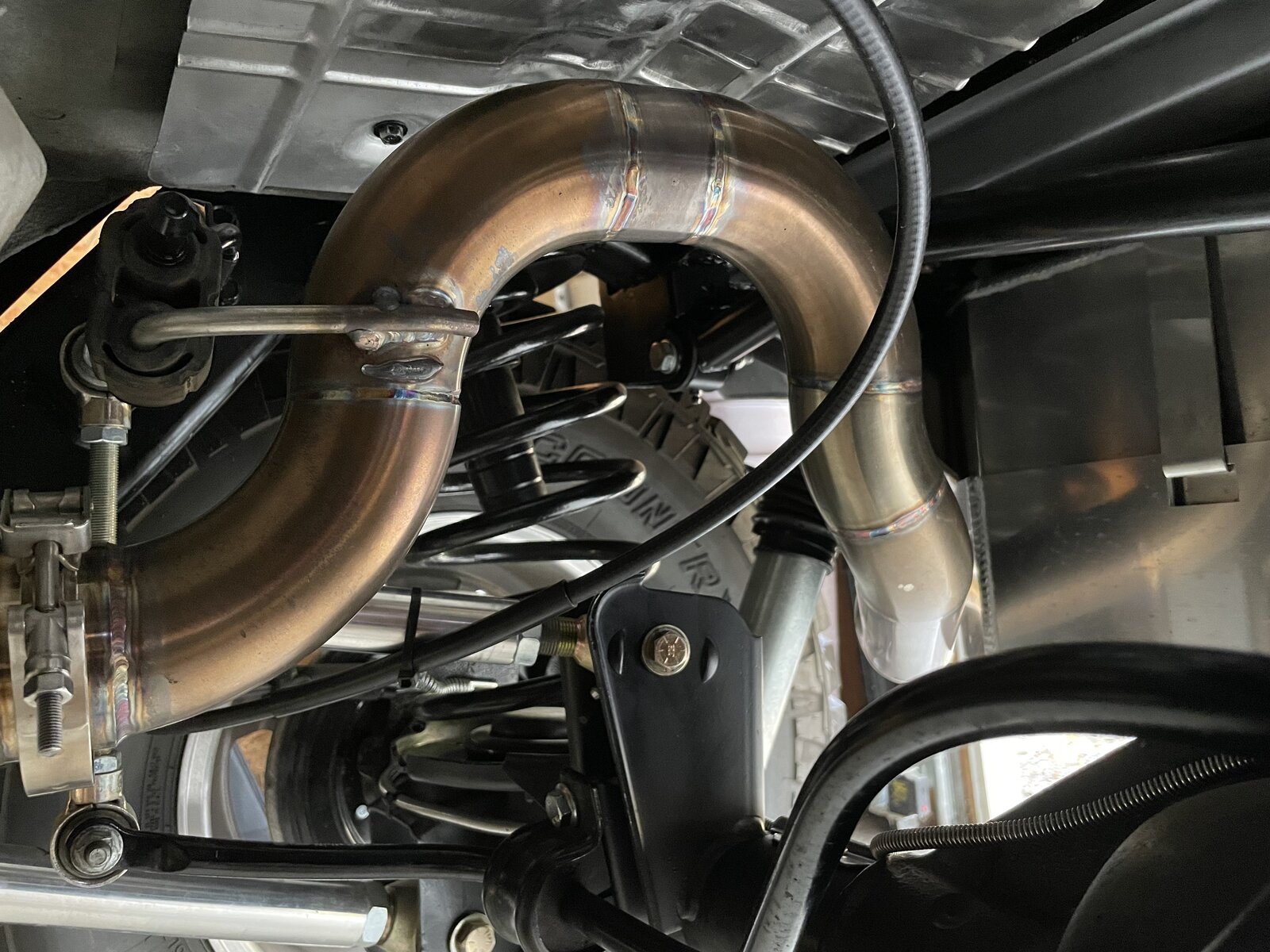

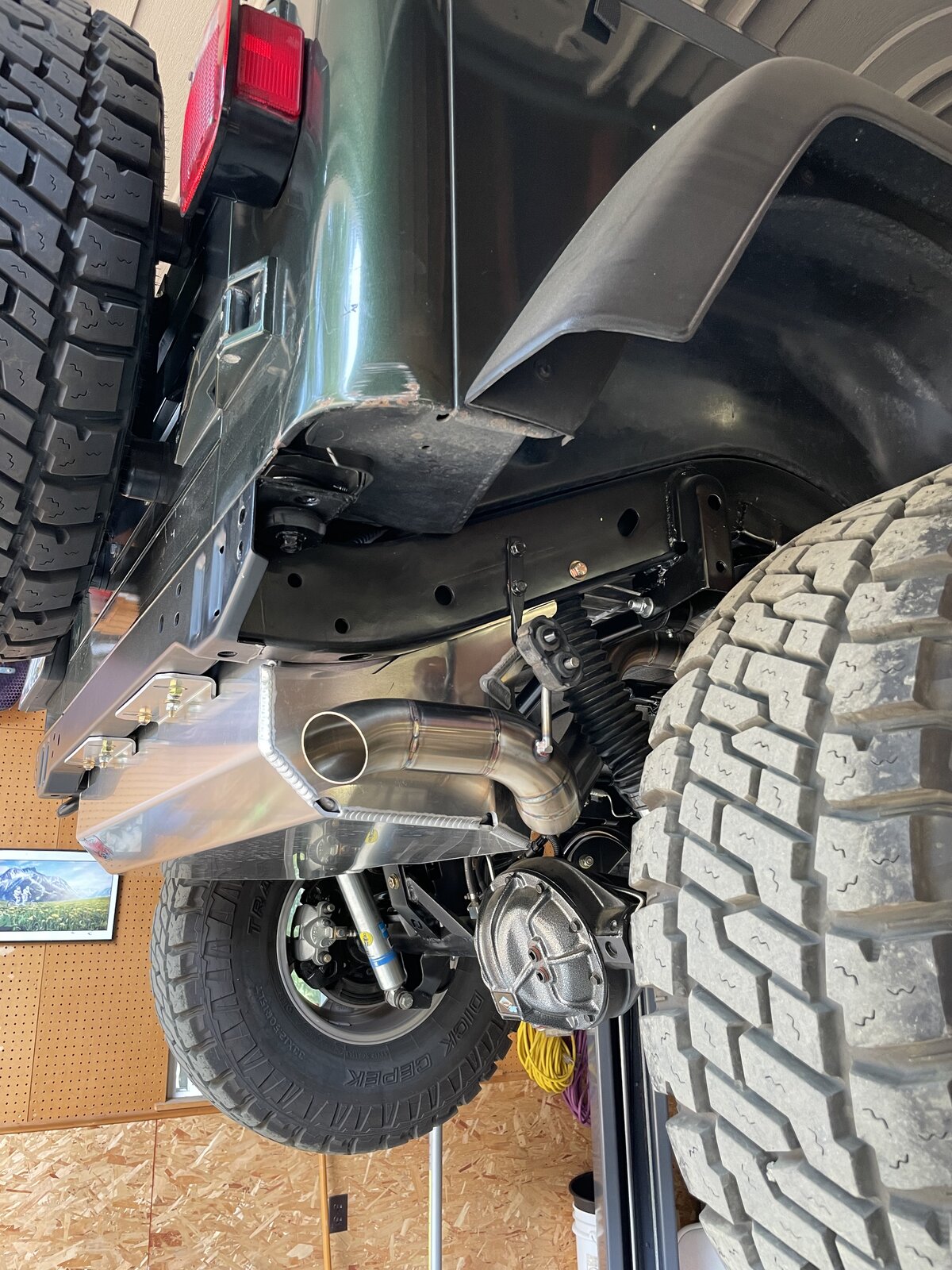

Mine has a full 2.5” custom system. Stock is 2.25” from CAT back. I also have a tuck and a Genright tank so not directly applicable. I’m chiming in because its amazing how much harder it is to get a 1/4” bigger diameter pipe to clear. I don’t really recommend it for a stock motor. People will argue this, but there is little to no HP gain to be had and you may actually lose some low end torque. It MAY help my stroker but not much. With the Magnaflow muffler it does sound nice, however.

Your Jeep is too clean underneath. ;) (y)

Dude.......that setup is a work of art
Also get that damn thing dirty your making us jealous over here 🤣
Jokes aside, what a beautifuly setup jeep man 👍🏼!

Thank you. It IS nicely done. Done by a local guy who is a whiz w/ SS TIG. It is also less pretty at this point and in need of another round of modification due to my current project (BL, Atlas and higher tuck). Since I recently for the 1st time did some MIG welding of stainless on my tow rig and that turned out OK, I’m going to try the next round of exhaust changes myself on the TJ. That is guaranteed to be less pretty.

Whoever did you exhaust did a very nice job. I think you may be dealing more with the bend radius vs the extra 1/4”
