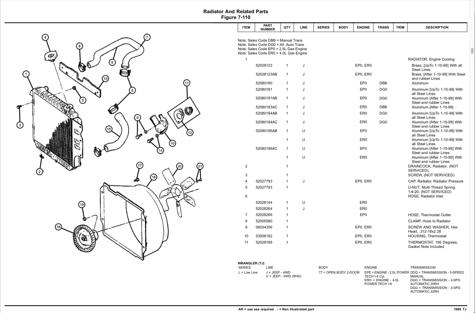

Are they the interchangeable?
So I have been seeing my highway temp climb to just a shade over the 210 mark. I can run all day on the trail and it will stay just on the left of the 210 mark. Get out on the highway and it moves up a bit. Not overly concerning but it is telling me I have an issue In the works. So I begin to look for a 2.5 radiator as mine appears to be factory and 180,000 miles. Today I noticed my belt routing sticker is for a 4.0, so it appears my radiator is for a 4.0. Are all manual transmission radiators all pretty much the same?
Here is the info from 1999 Jeep Parts List:
