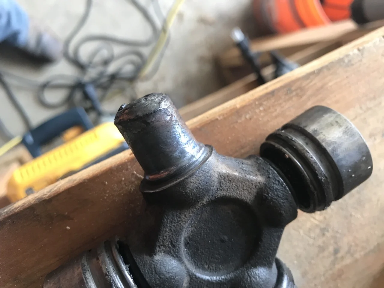

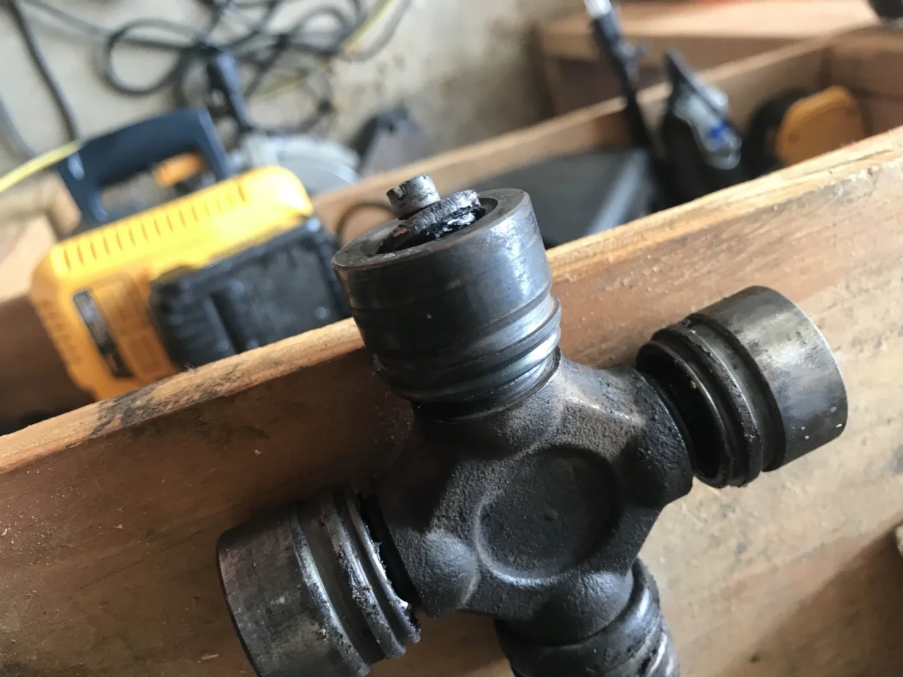

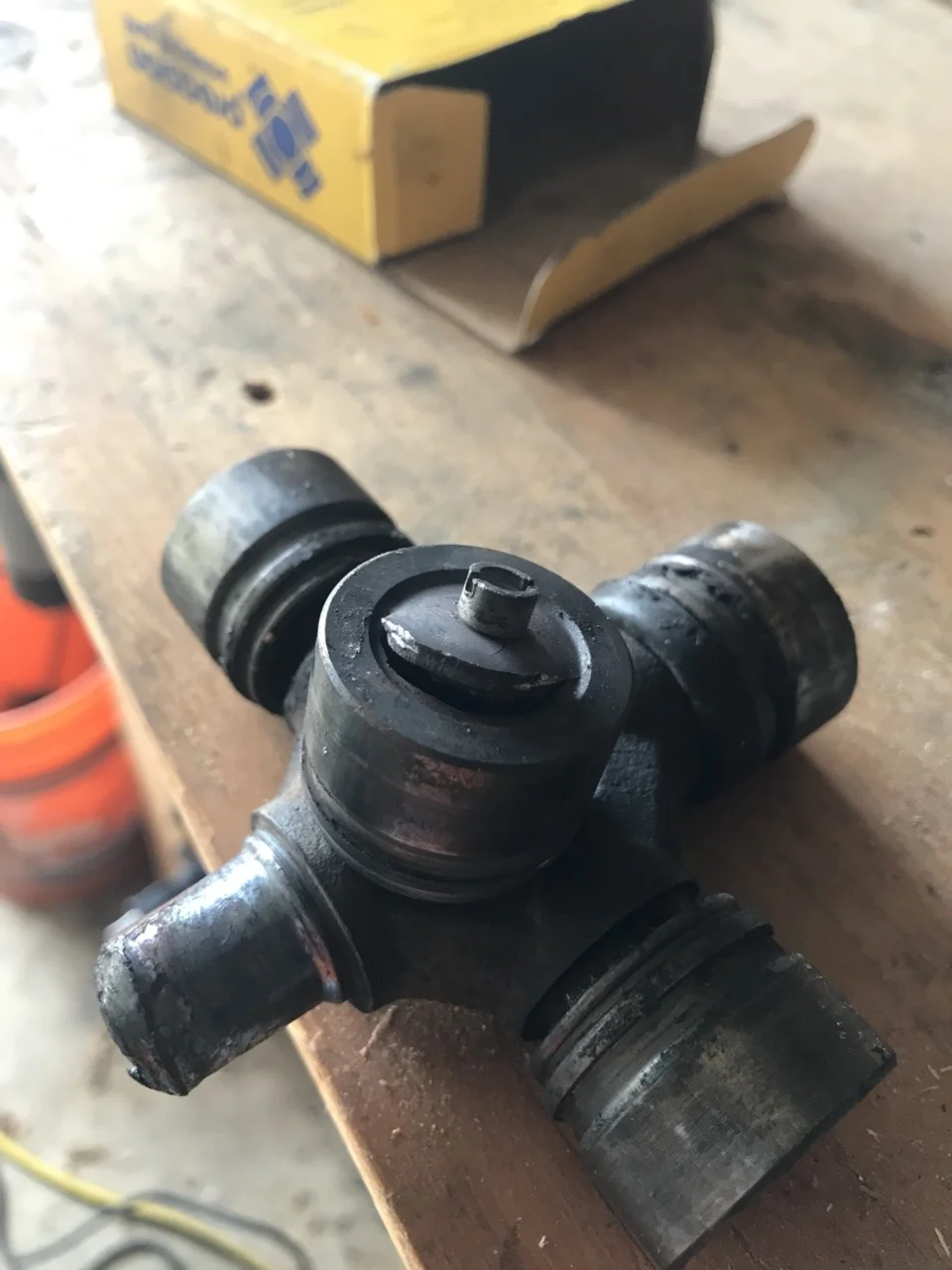

Chris, I had a separate post about vibrations. You recommended me taking and having the tires balanced, well I had them balanced and rotated. It still vibrates. I took video of it, is there a way to share it? Maybe thru pm? If not can I email it or text it to you?

Upload it to youtube and paste the link here.

Hmm...good video, especially the 2nd one with your commentary of what’s going on. I’m thinking someone here will have some good direction.

The video sounds more like driveline vibration. You will need to check angles, u joints, suspension components, etc and see what you find. You need to square that away because it will likely worsen with a gear swap due to increased drive line speeds.

Found the source of the vibrations, I double checked the U-joints and sure enough the front uj on the rear shaft was bad. Thanks guys for all the help.
