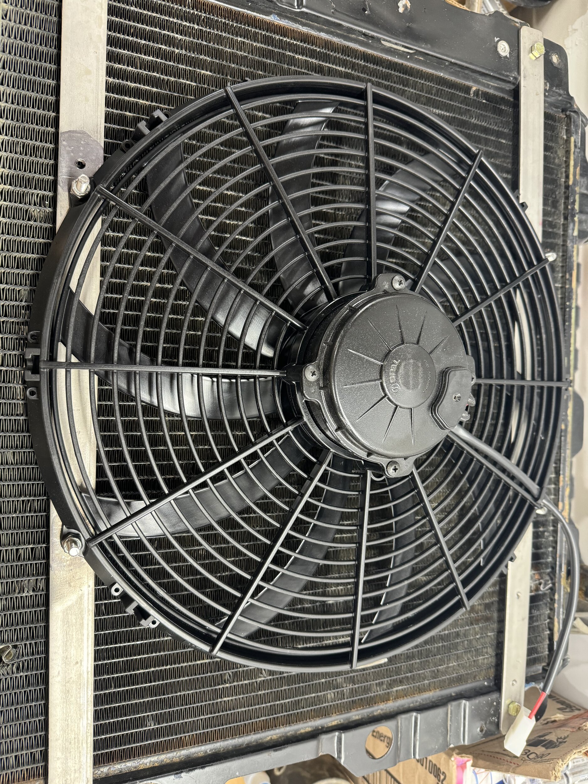

Someone was asking about doing a electric fan on our 4 poppers in a thread, but it'd been too long since I'd done mine to really remember what it was like. If I find that thread again I'll link it here for you.
Yeah there has been a few threads. Curious how this new one is going to go.
Reactions: Wildman

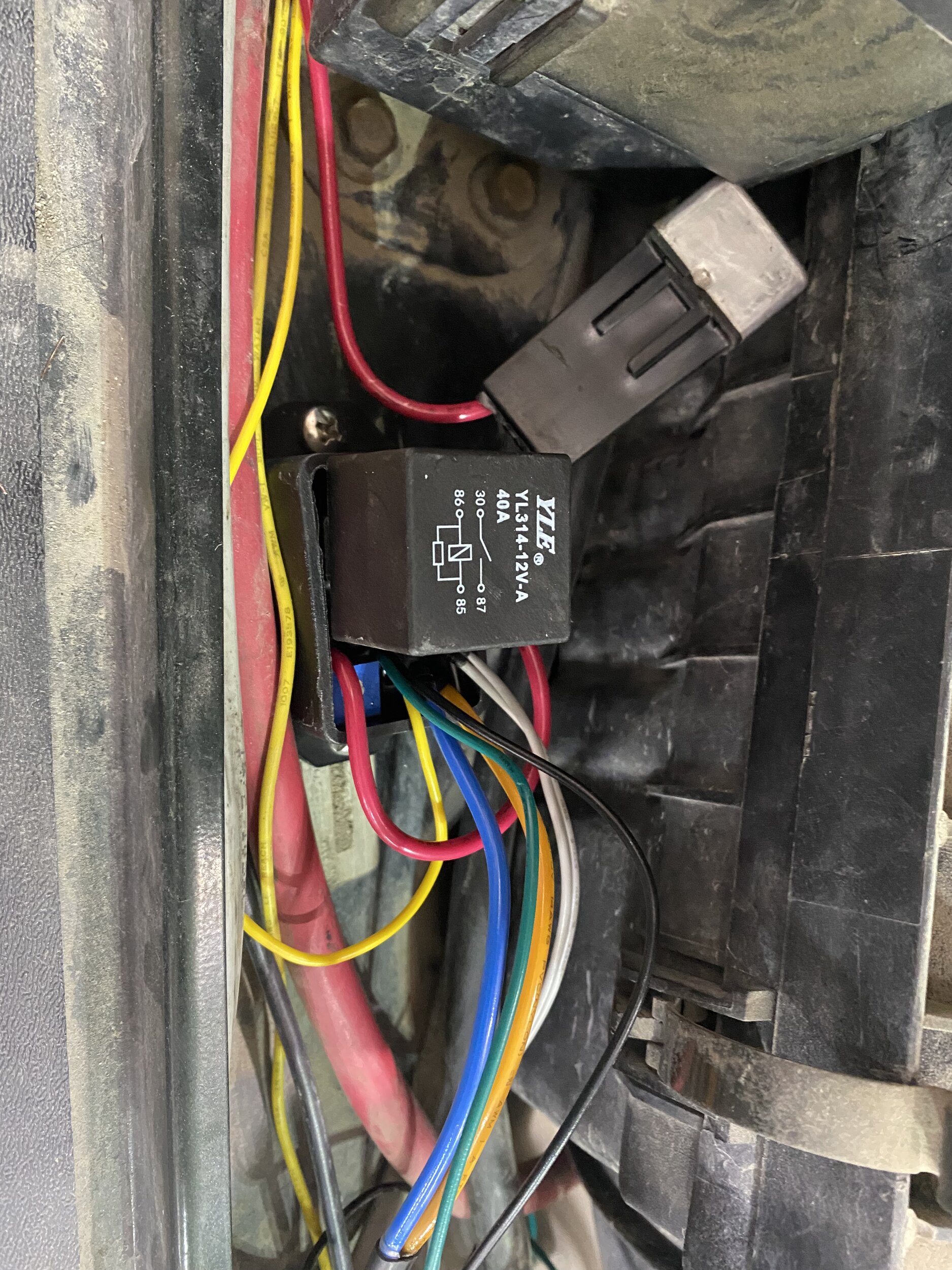

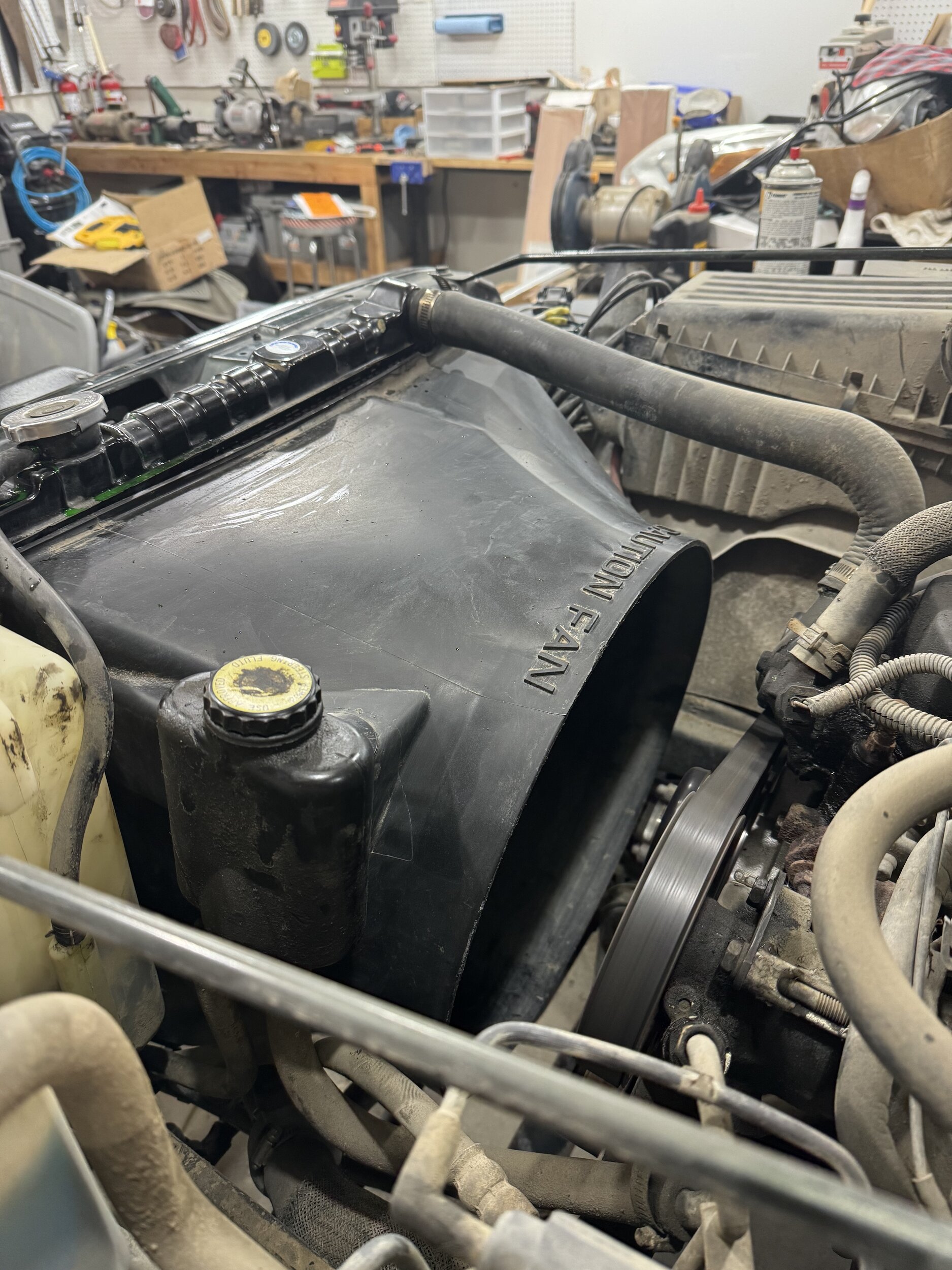

Well got the radiator back and everything is installed and no leaks and water pump does what it’s supposed to. Done a bit of testing with the fan and have concluded that the old Derale controller has a dead spot after all these years so I guess it is time to step into the 20th century and upgrade controls.
Found an Imperial/Hayden controller here in town and will give it a shot. Would have preferred the one with the actual sensor versus the probe but it should still get the job done. This control is the same one a lot of companies use and it is OK. I really wish the Chinese would stop using such crap insulation on their wires.
Did not take too long to install and now I just have to test and tune then clean the wires up.

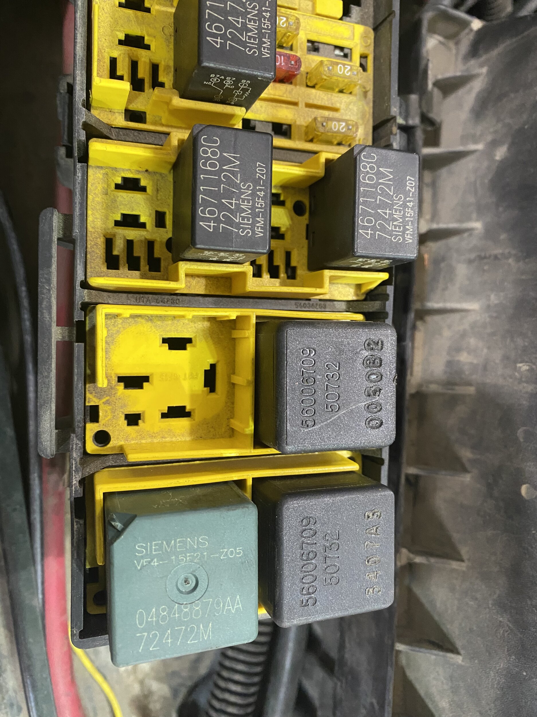

Since had to go into the PDC to remove fan wires I took a moment to put the driving and windshield lights in there instead.
Just about every new circuit I've put in the rig I've added to the PDC. Both fuses and relays. I enjoy the challenge of making everything look stock (for no good reason, I guess...). With my abilities, I am quite certain it will burn to the ground at some point.
Nice work, Dan.
Nice work, Dan.
You guys just keep pushing me. I thought I had upped my wiring game a little (I have, but the starting point was in the abyss). Now I need to figure out how to use all those empty slots in the PDC…
What I did to get started was to buy a second PDC with all the wires, connectors, relays and fuses from Davey's. I've been scavenging from it ever since.
A cherokee or grand cherokee might be a local source for one,eh? Or maybe even a dodge?
Look at a Liberty (1st gen). I got a spare pdc from one of them that was really similar from a pick and pull. It was like 15 bucks vs buying a TJ or Cherokee one for 50 or more online. I never see TJs in the junk yards here, and rarely see Cherokees
