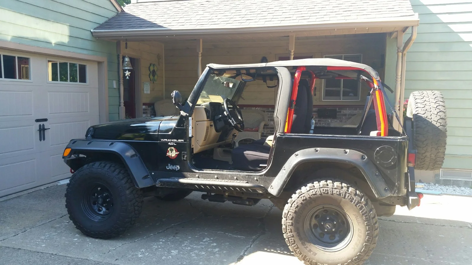

2000 Jeep TJ Restoration Project
Forgot the "before" pic!
Reactions: Ephry73 and Chris
Wow, great job so far! I applaud you for taking this on. You're giving @Ranger_b0b a run for his money!
Thanks Chris. I can't add much to the forum in the way of proper suspension set-ups or common TJ improvements/repairs but maybe I can help members tackling their own rust issues. These are great vehicles and actually very easy for people to learn bodywork/rust repairs on. I welcome anyone's questions on how to begin, what is needed, etc. I have seen the threads about people accidentally buy a "problem" Jeep and many are salvageable. Maybe I am just too dumb to run away, but I figure if someone else can do something, so can I- maybe not as fast or as good, but I have to at least give it a shot. After seeing what many of you experts do with your builds and mods, fixing some rust pales by comparison! I learn something new from this site every time I log on!!

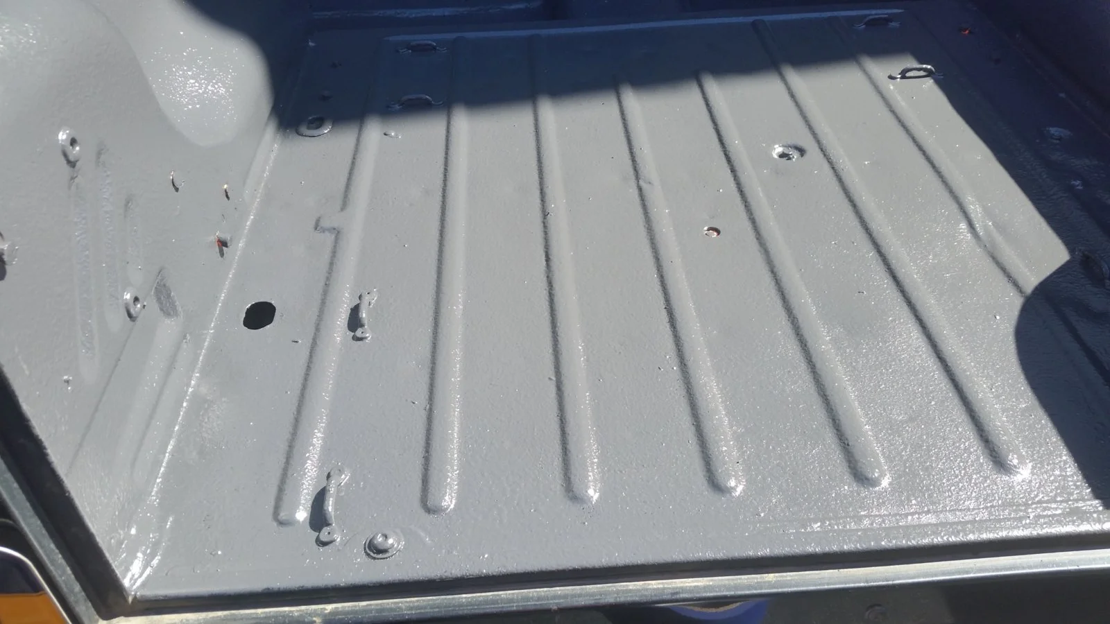

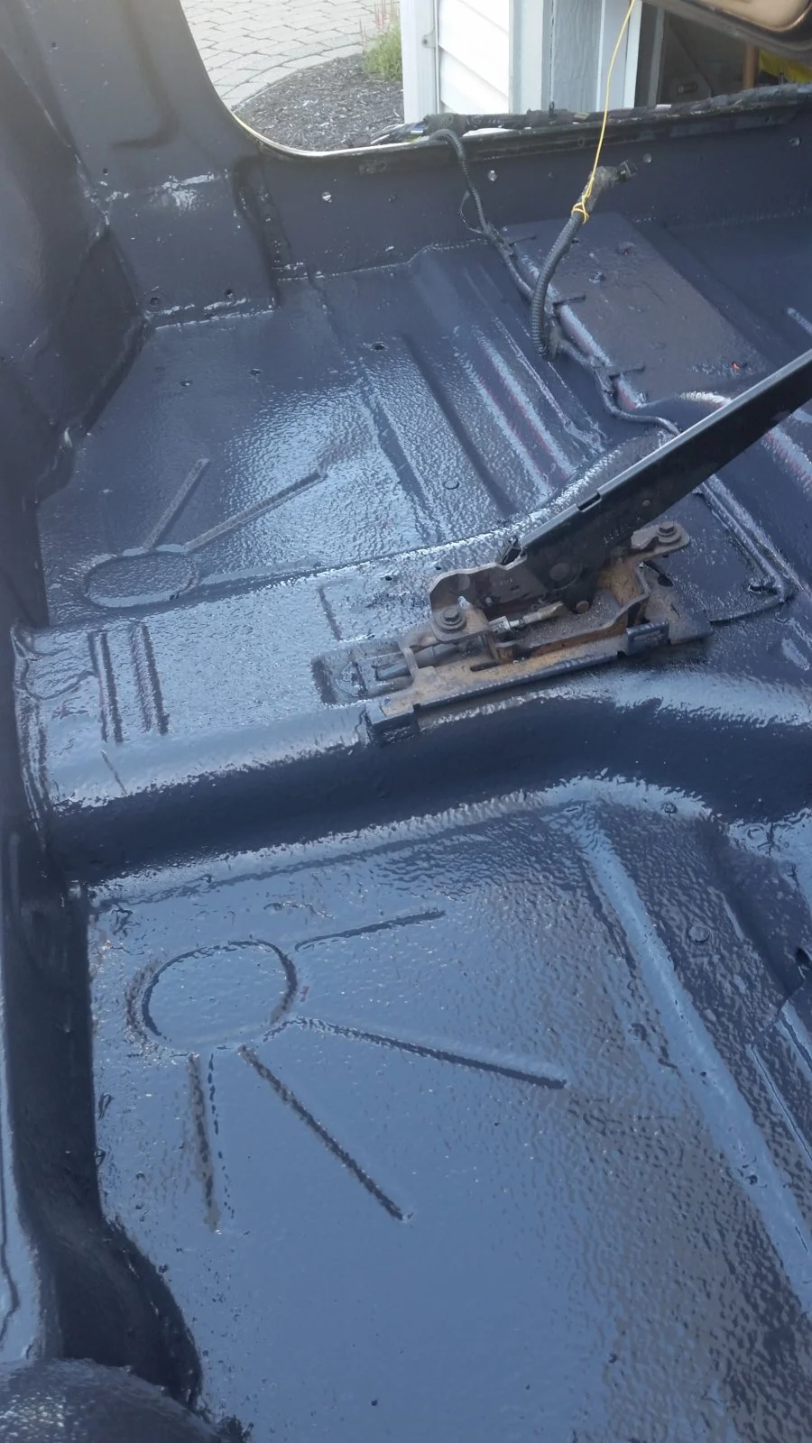

Since I was on here last, I finally got everything back together, drove it and then took everything out of the interior to Monsta-line it. Went with the Pyroclastic color, kind of a weird shade of grey. I actually go worried about the color when everything was out, but once we re-assembled it, it really looks great. Since this is ultimately my son's Jeep (my wife isn't convinced that I will actually give him the keys since I drive it so much), I had to relent to painting the roll bar red. To be honest, it doesn't look bad, although I am personally a bit less flashy than a teenage boy.

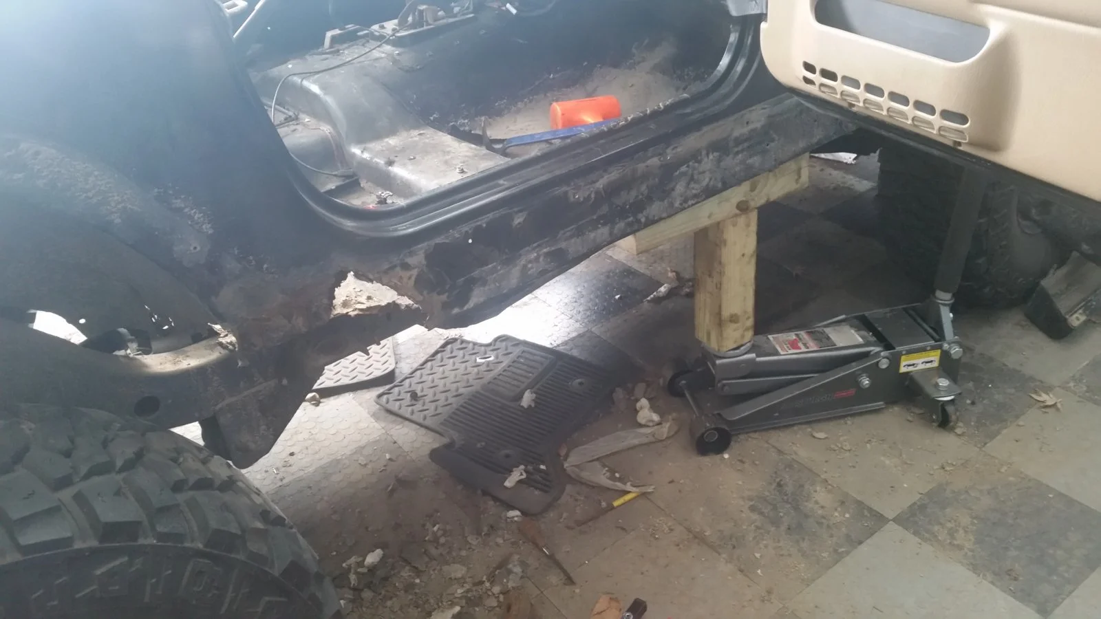

Glad you stuck with it.I finally got my 2000 tj on the road.I was the guy from Ontario Canada that bought mine in dec and spent 3 months under it as you did. I did the frame repairs,all new brakes,mounts,new floor pans,new fenders etc.
