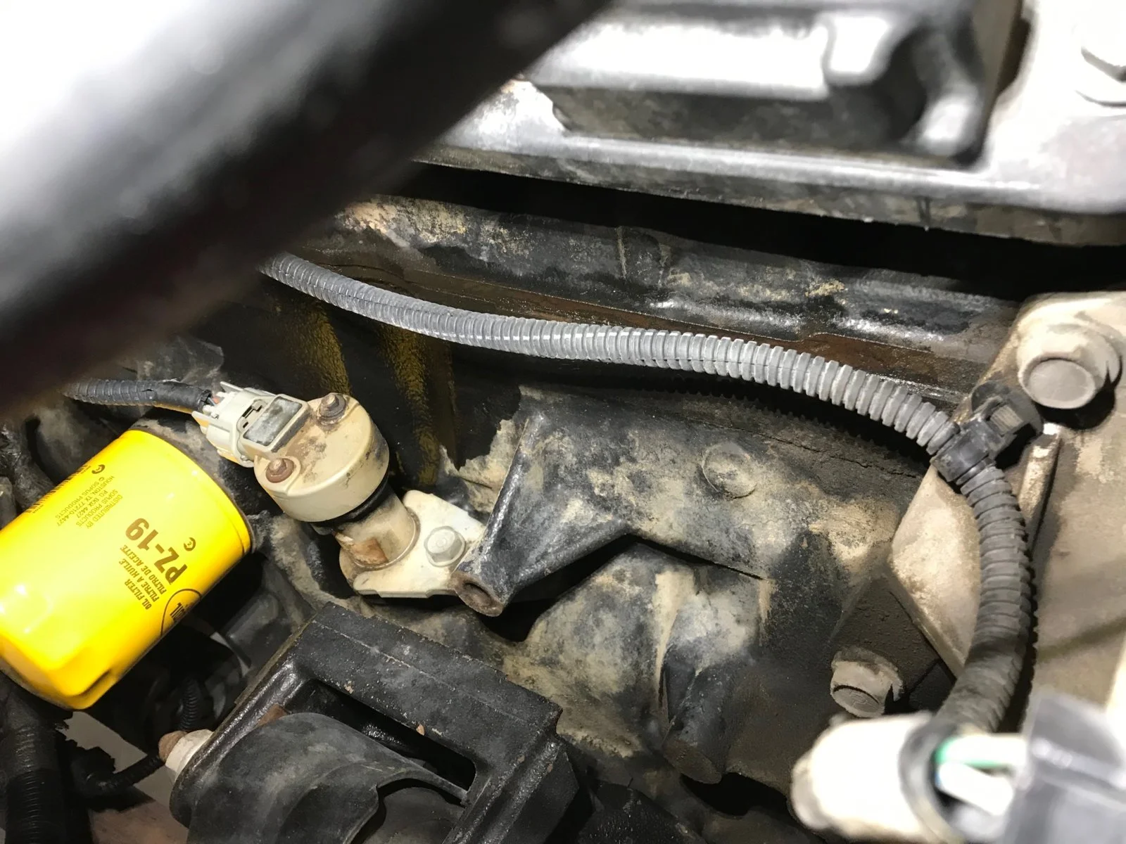

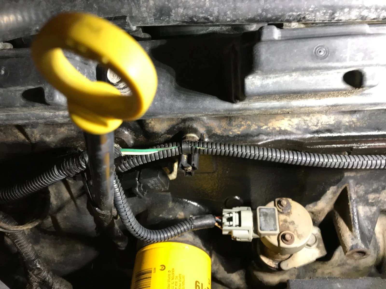

One of the things I wanted to do was to degrease the engine, which I did last week. There was a LOT of built-up oil and grime all over the place. After the degrease with 2 cans of degreaser and a power washer, it looked MUCH better!! And I was hoping that it would stay oil-free... Well unfortunately, it hasn't. It looks to be leaking oil from the head gasket (see attached pics from the passenger side). Is this also a common place for these engines to leak oil from? Is this a major concern? How hard is it to replace the head gasket? What should I expect a shop to charge to replace it for me?

If the head gasket is leaking oil, it should be replaced as soon as you have time. A bad head gasket can cause oil and coolant to mix, which can destroy the oil, in turn causing engine damage and even failure.
Check your dipstick frequently to ensure your oil is not becoming cloudy, milky, or like a milkshake. Search Google images for "oil with coolant in it" to see some examples of what to watch out for. If you see that, stop driving as soon as possible. Otherwise, a leaking head gasket isn't as big of an issue, for now.

I "googled" to refresh my memory regarding oil seepage on 4.0L engines passenger side between the block and head. The following was the general consensus...the usually small seepage is on the push-rod gallery side of block (passenger side) and does not interfere with compression. They talked like the coolant gallery was on the driver's side of block which makes sense cause that is where the 0331 heads are known to crack. Some say their Jeeps have been seeping oil for years on passenger side with no issues.?
Thank you for the additional info. Everything you shared here sounds like what I'm seeing. Oil looks good, antifreeze looks good and level is rock steady. And it is a very small seepage...so small that it has yet to drop a single bit of oil on my garage floor (in a month). No overheating and engine performance is fine.
Any insight as to the cause and fix(es)? Does it mean my head is warped? Or maybe just a gasket has aged and needs to be replaced and should be good for another 100K miles?
