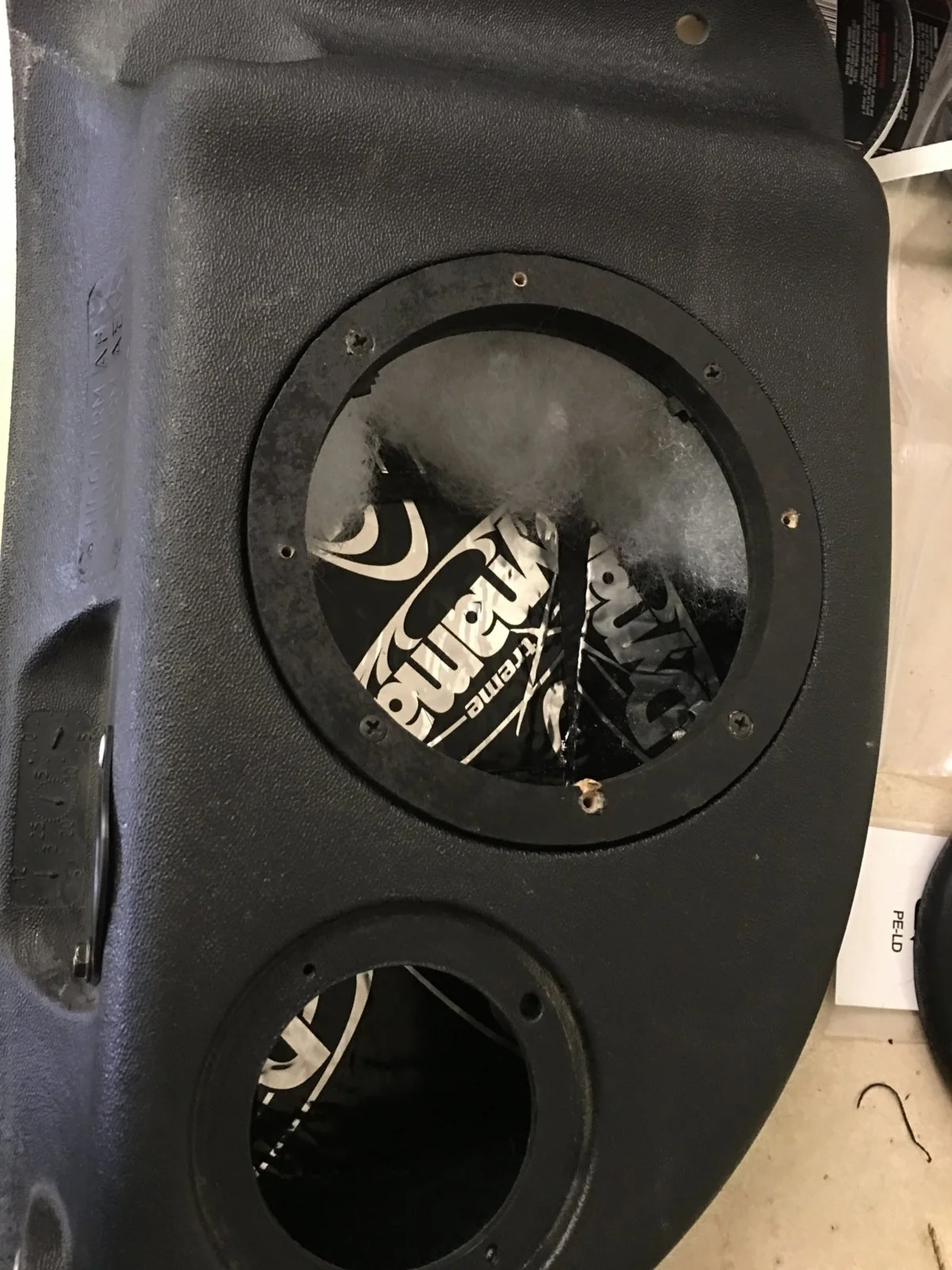

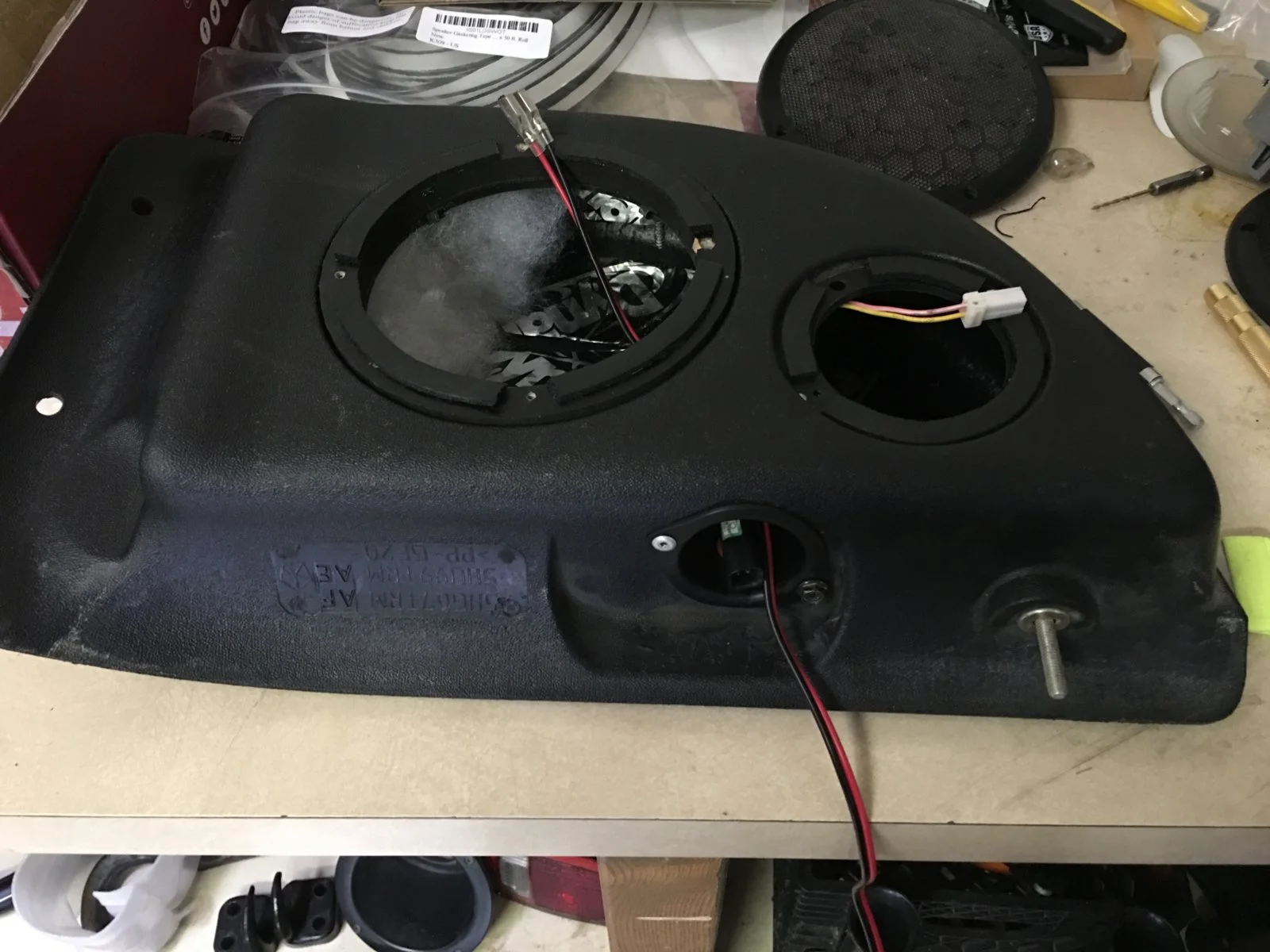

Taking off the Sound Pod is very easy, you do not need an instruction manual. Just a couple torx screws and it comes right off. Once you have the sound pod off the jeep you are going to want to unscrew the factory speaker faceplate and disconnect the speaker from the plug in the back. After this is done, do the same thing with the light except to pull off the cover on that you just take a flat head screwdriver and pry it open. Disconnect the wires and unscrew the mount and take the whole thing out.

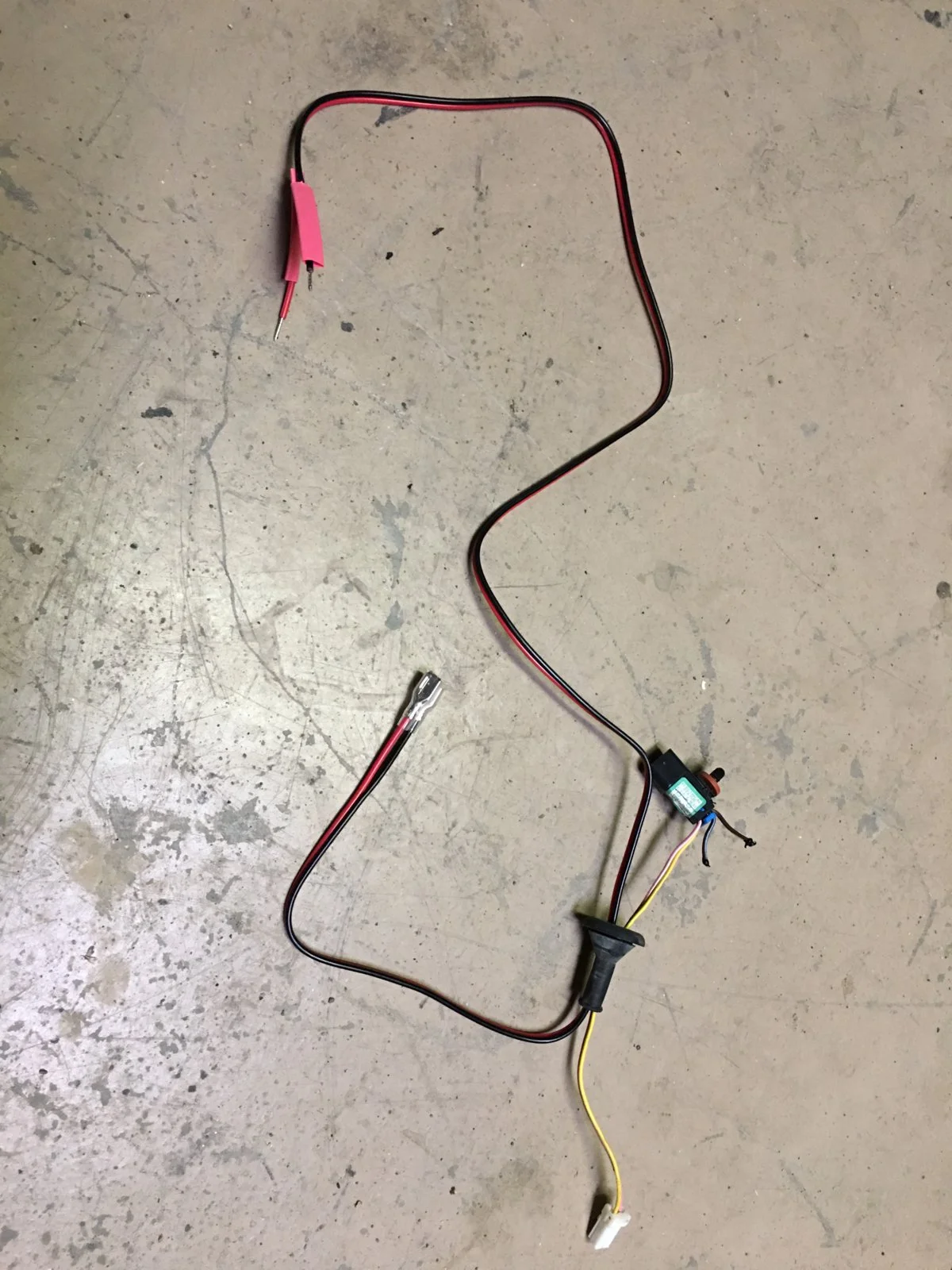

At this point, you should have an empty sound pod with only the wiring left in it. Now this is a fork in the road, you can either take out the factory harness like I did or just keep the old stuff in there and shove the new speaker wires up the grommet. I suggest you take the wiring harness out since it is not very difficult. The grommet pulls right out and then you can cut away the old speaker plug and put liquid tape over it like I did.
After I fed the new wires through the hold which came with speakers I tesa taped some of it together to cut out rattling where I though it may rub with the body of the pod.
Once the wiring harness is out of the pod it gives you unrestricted access to the inside and you can install the dynamat as well as the polypill to give the speakers more air to push and get a deeper sound.

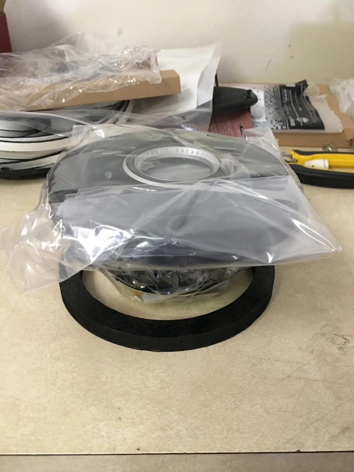

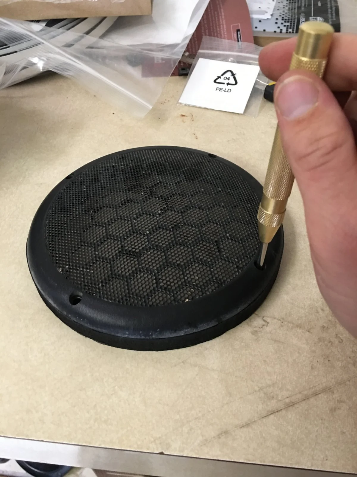

You can also see the black ring that is added inside the hole. Because my Polk speaker faceplates were bigger than the stock hole, I had a audio shop make a wooden circle that fits inside the stock hole and brings it flush and then they spray painted it black. There is a lip at the bottom for those of you that are curious how its staying in the hole and not falling through. I then screwed the new speaker into the wooden adapter plate once the holes were center punched and ready to go in. Speaker gasket tape was also used on top of the wood to minimize vibrations

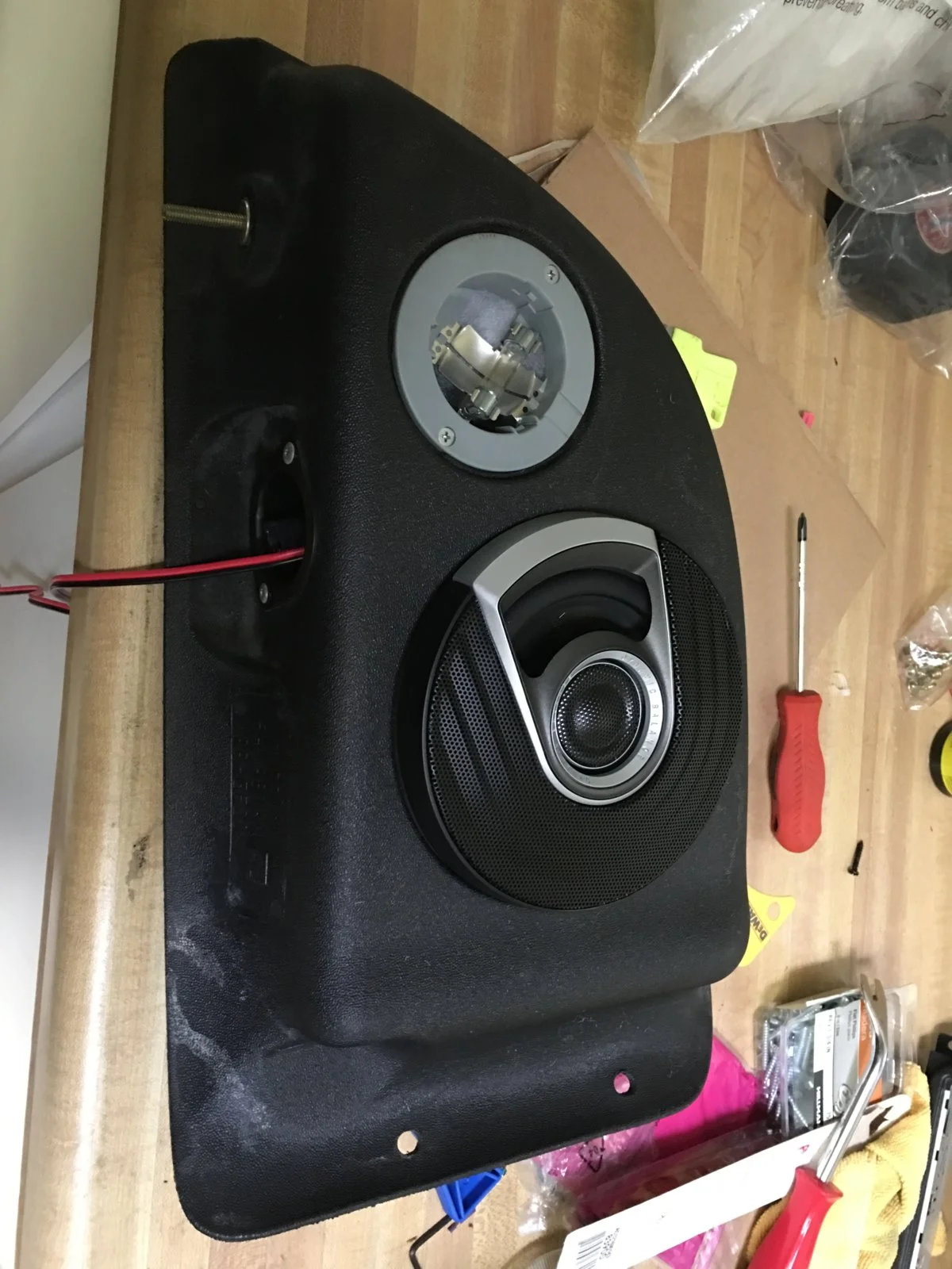

Here is the final Sound Pod assembled and ready to go back in the jeep. All thats left is soldering the wire or crimping it into the new speaker wire routed through the jeep. I suggest not using the stock speaker wire if you are installing better speakers to not hinder them.
Please let me know if you have any questions!

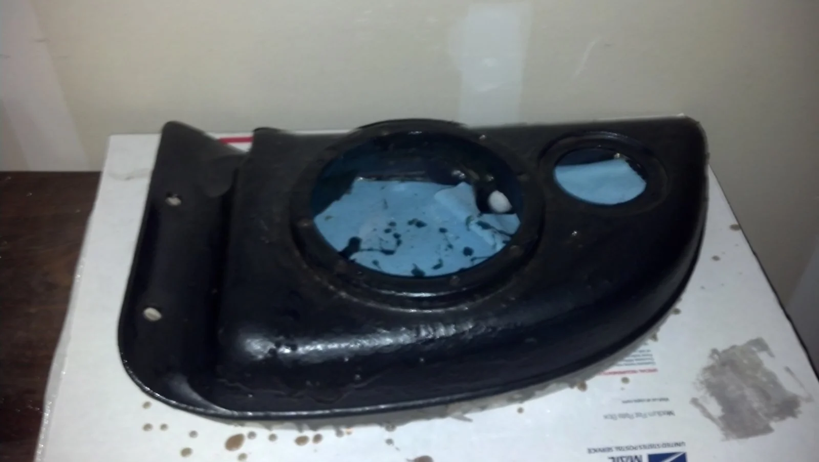

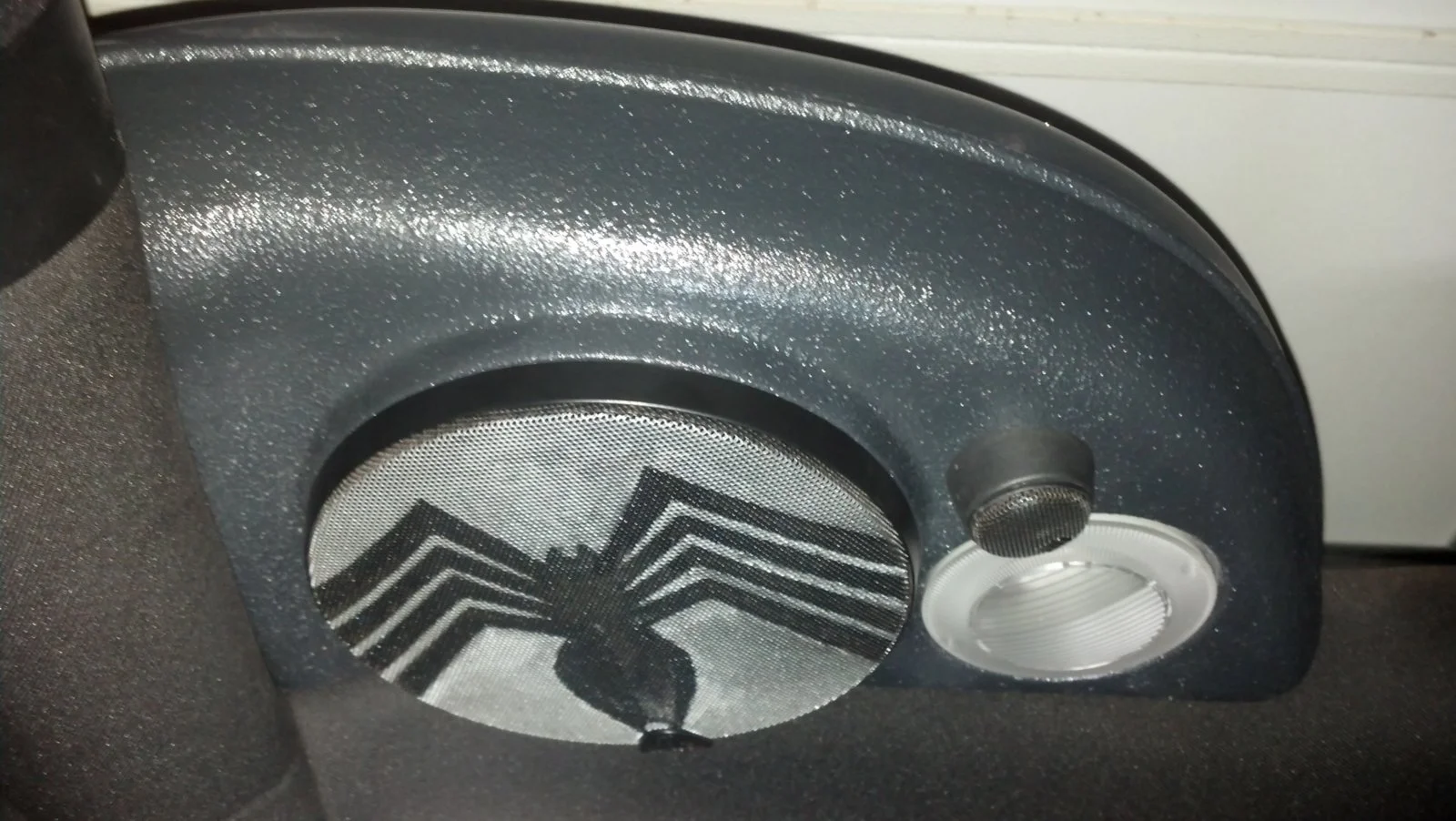

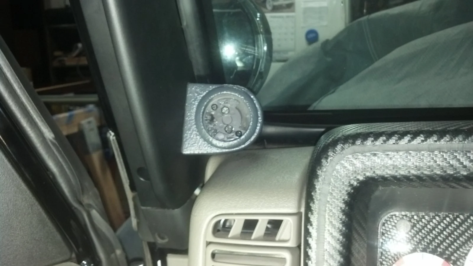

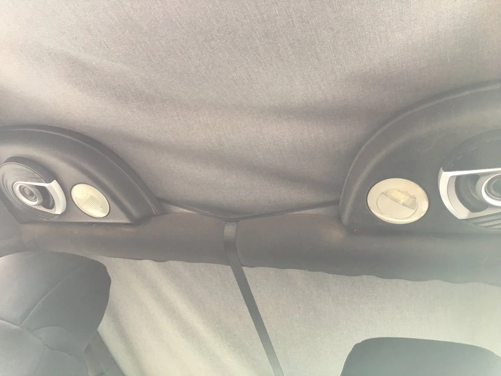

I did a similar modification to my speaker pods and went a couple steps further. I wanted to add components into my pods with 6-3/4" mids and 3/4" highs. The pods weren't deep or wide enough for the mids, so being experienced in car audio install and fabrication, I glassed those puppies up. Masked the upper half of the pods, cut out the inner ring, roughly attached a 1/2" extended 3/4" OD ring, slapped on some fiberglass resin and cloth and more fiberglass resin. Next I sanded it out evenly and primer coated it, hit it with texture, primered the texture to lock it in, base coated it best I could to match and matte clear coated it. The matte made it turn out dark gray but you can't tell unless up close or in the pics, lol. Sounds really good though. I can rock out loud and clear down the interstate top down and drown out the wind. More to the system than just those though. Even did some components up front. Molded some pods for my highs and mounted to the A-frames.
View attachment 59617 View attachment 59618 View attachment 59619
Did those components have external crossovers? If so, where did you mount them?
