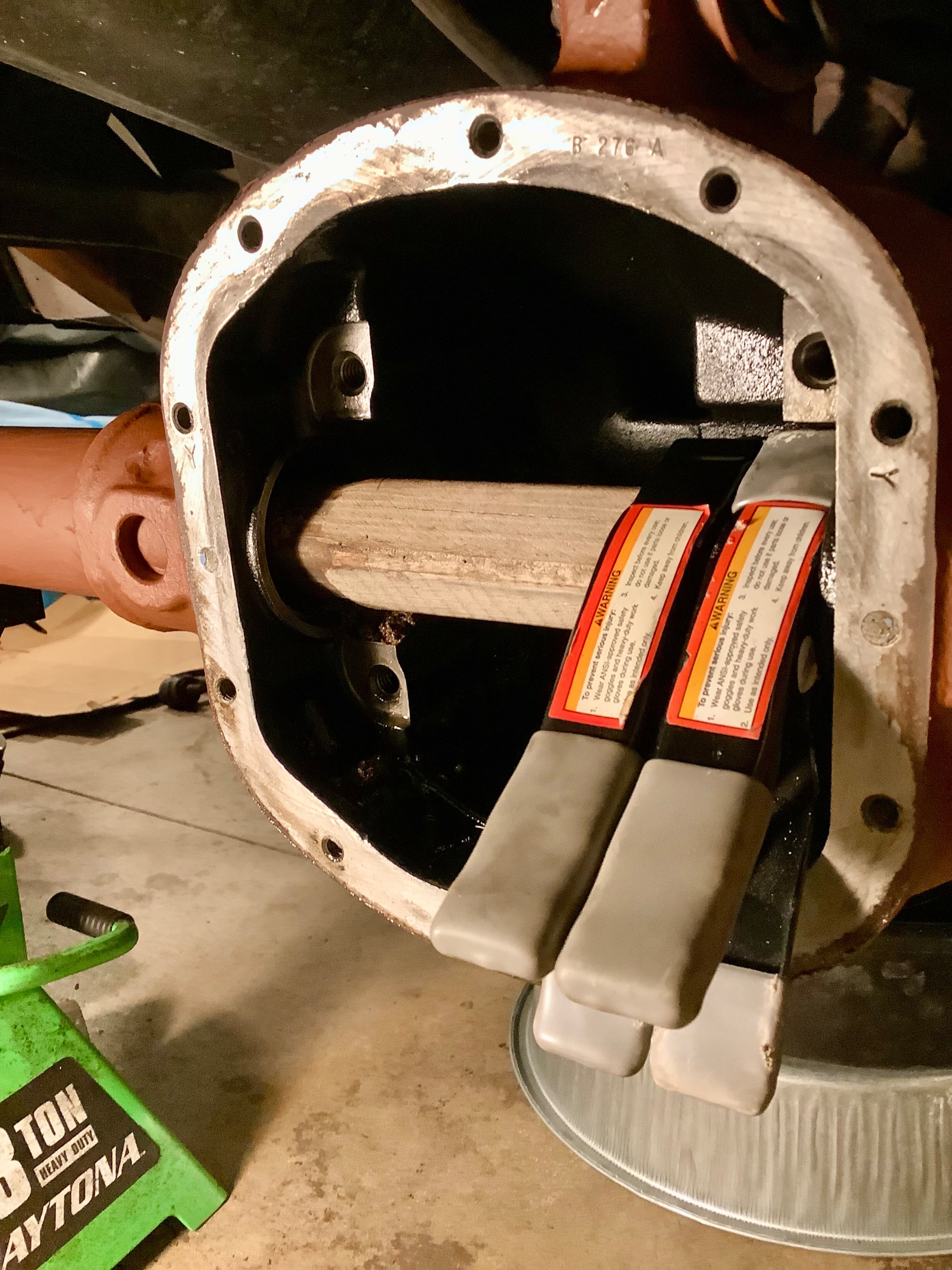

I drained the diff and removed the carrier. The bearings look great.

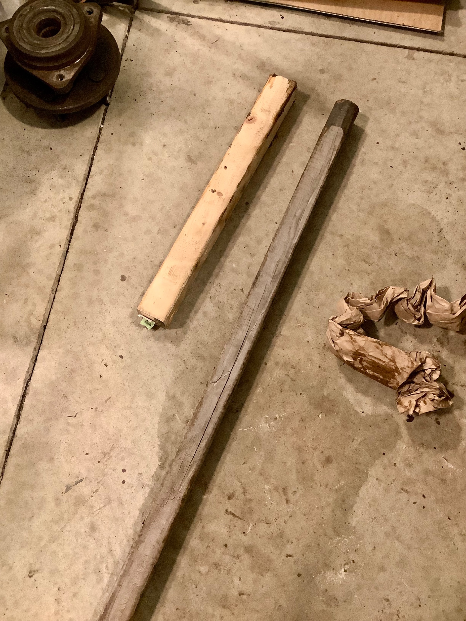

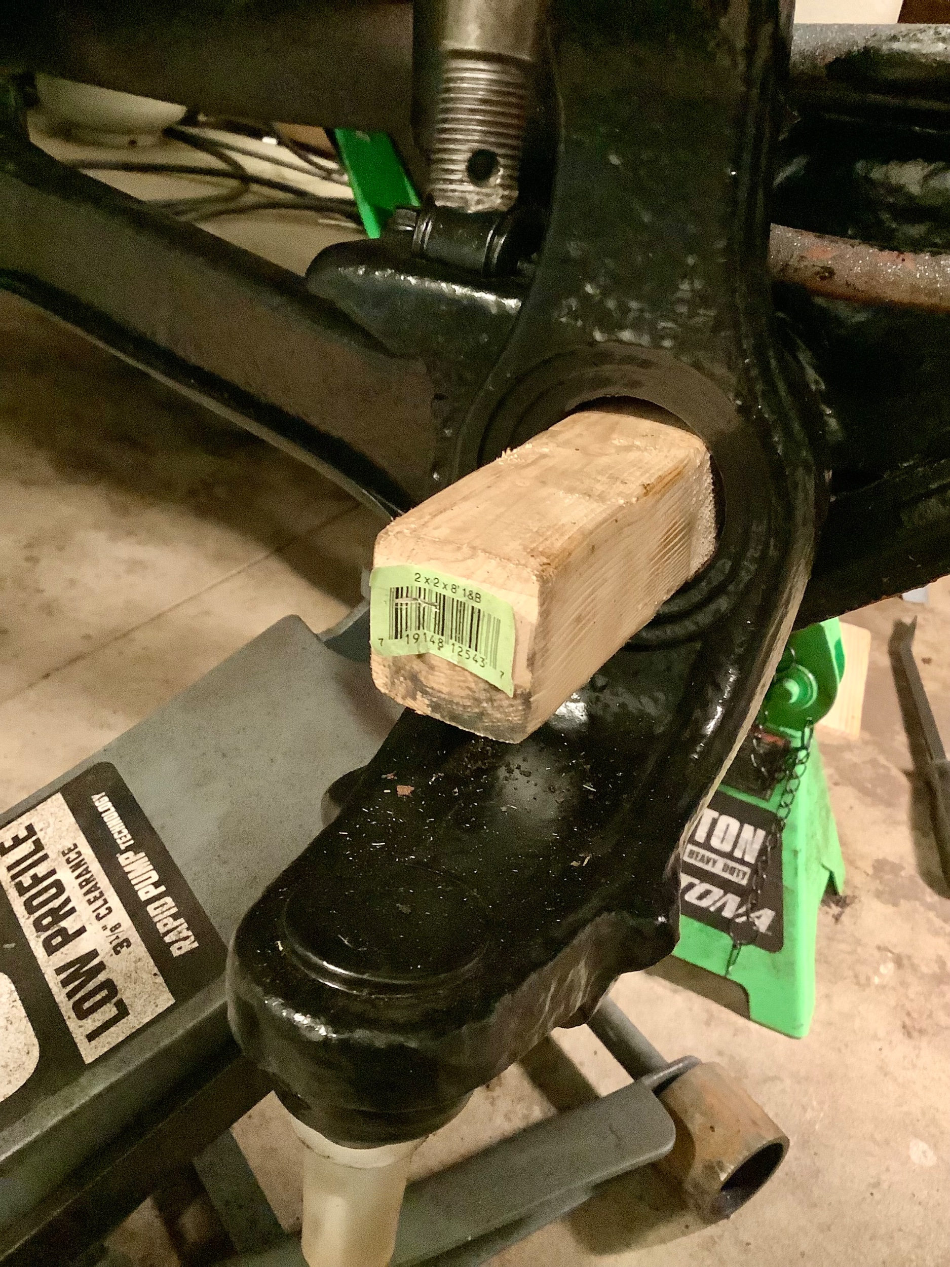

Turns out 2x2" lumber works perfect to knock out the inner seals with no chance of damaging any surfaces. It was a little bit of a tight fit so I tried a 2x2 deck baluster (my fire pit poker) because it has rounded edges instead of square edges but it actually forced it's way through the center of the seal so that didn't work but the baluster did work great as a pusher stick for the short scrap 2x2 square wood.
I waded 3' long sheets of packing paper from the RockAuto boxes that worked amazing with the baluster pusher stick to get most of the gunk out of the tubes.

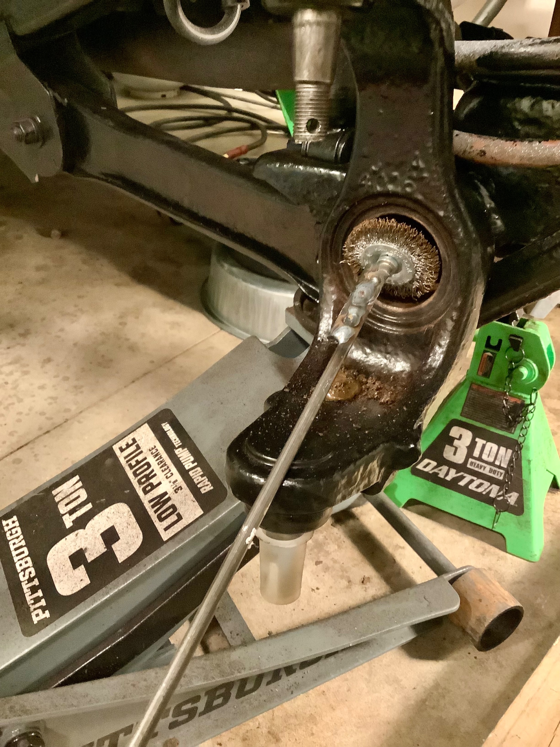

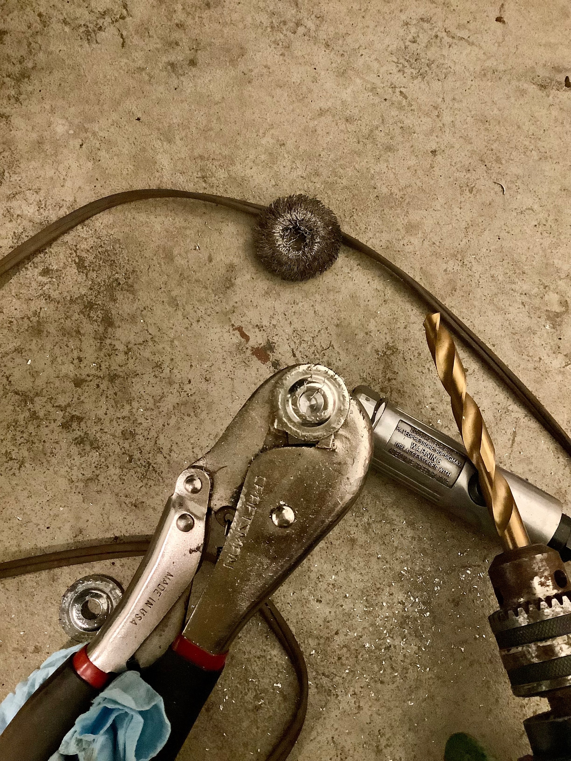

I tried to drill out the rivet/shaft on a wire wheel so that I could run threaded rod through it to make a drill attachment. Unfortunately, it turns out that part is what holds all the wires together in one piece so that was a fail. Plan B is trying a thin solid rod with hose clamps to attach the wire wheel. Plan C will be to cut a short section of the rod to create an offset and line up the wire wheel shaft better. Plan D will be to weld it like Plan C instead of hose clamps.
Plan B: FAIL
Too much torque for the hose clamps, the rod just spun and the wire wheel was sort of stuck not moving
Plan C: FAIL
Too much torque, rod mostly just spun. The wire wheel turned a little bit but mostly the rod spinning
Plan D: SUCCESS
Worked great! 2" wire wheel. 2.5" didn't fit for me. Need to grind a few flats on the drill end though because the rod wants to spin inside the chuck.
I clamped the baluster wood into the tube to block off the machined press fit area so I didn't go too deep with the wire wheel. This was to avoid scratching up the press-fit surface and causing more chance for oil leaks at the metal-metal seal.

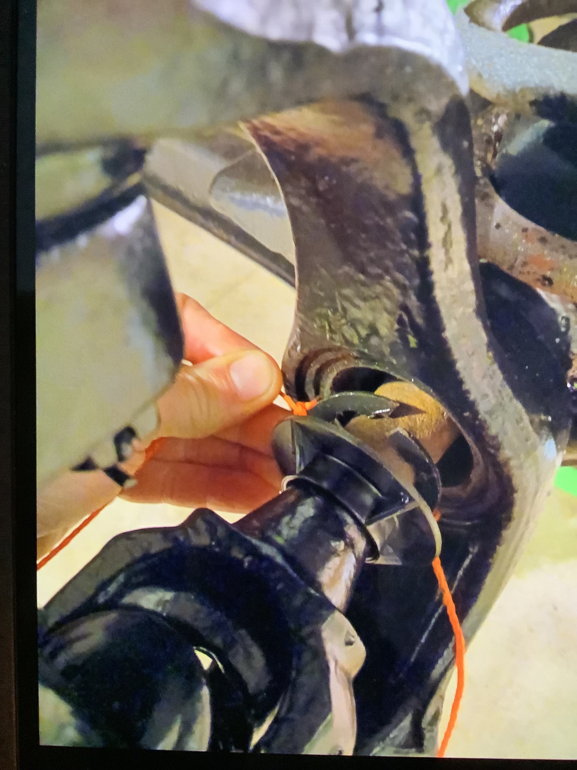

Axle shaft went in easy, didn't touch the greased up splines to the dirty tube, the guide came out easily after the axle was in, I reused it again on the other side, cost $2. Not sure what else to tell ya. Highly recommend - 5 out of 5 stars.
