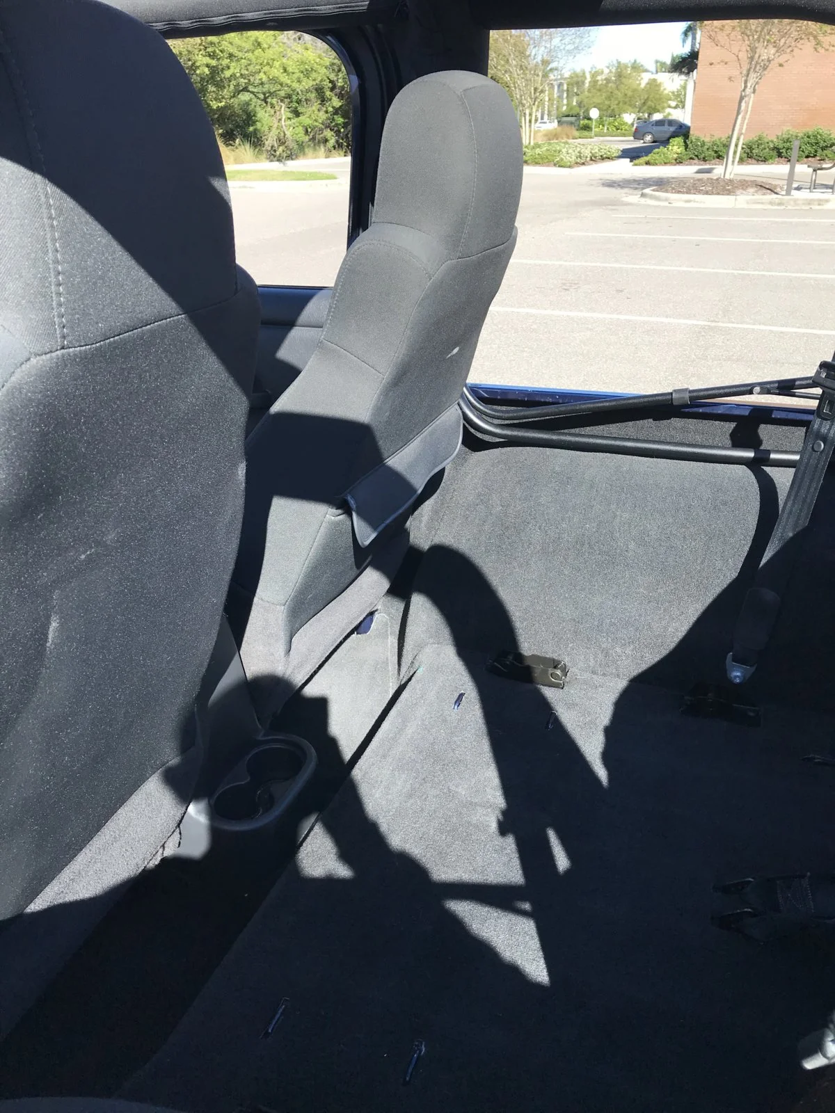

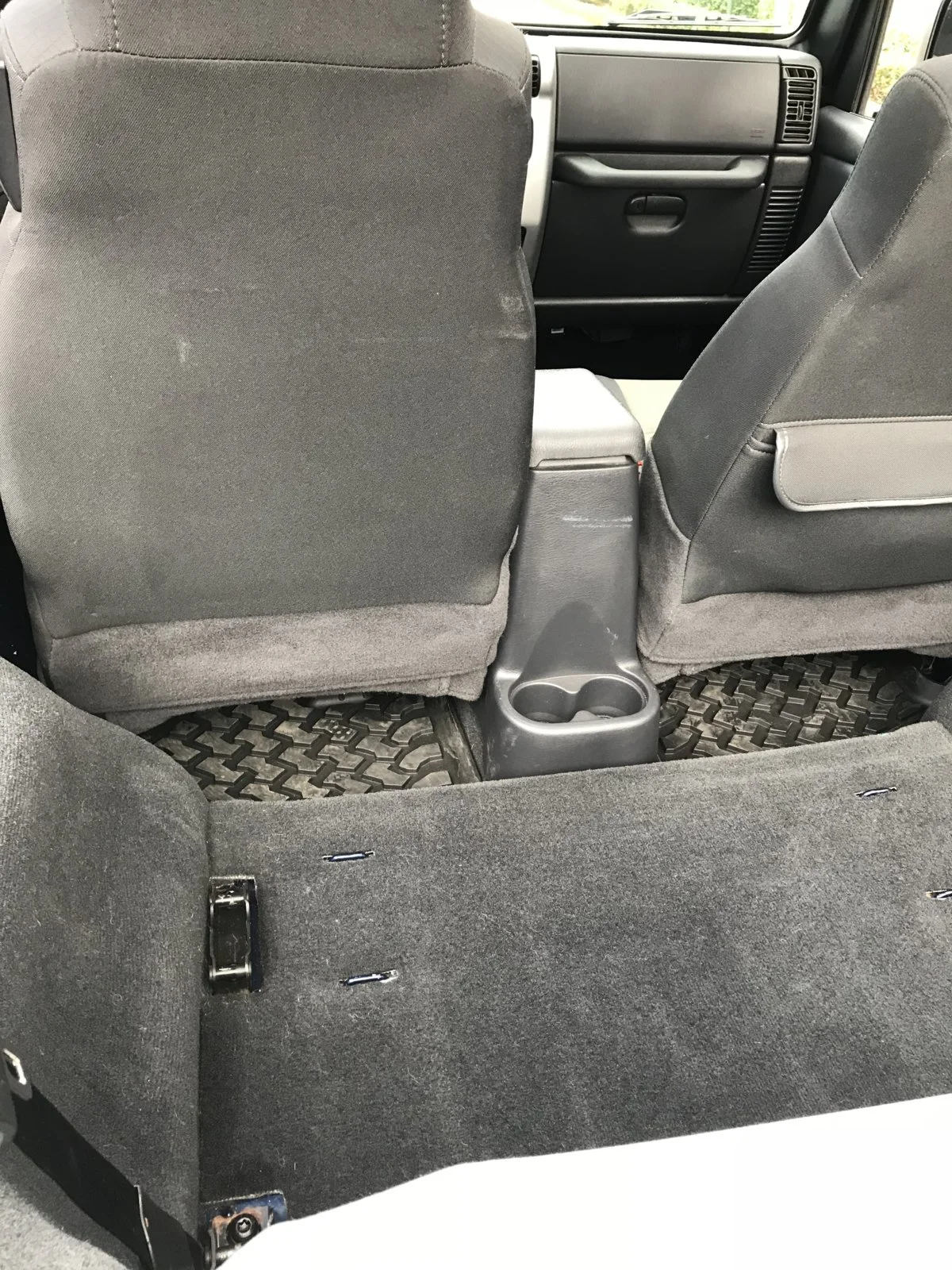

So below are some pics of what I have to start with (note I took the back seat out - just in case somebody asks if it was missing when I got the Jeep...).

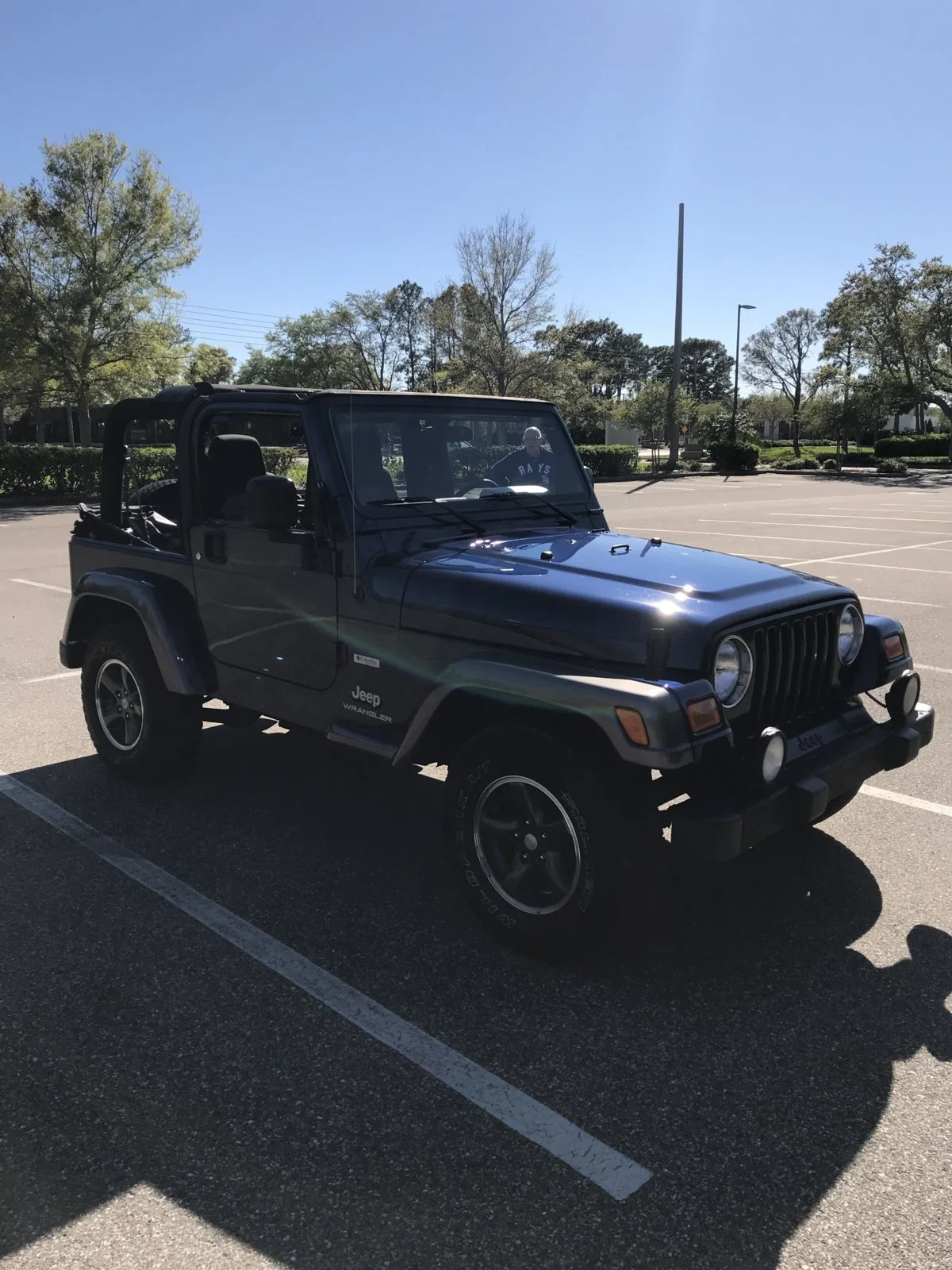

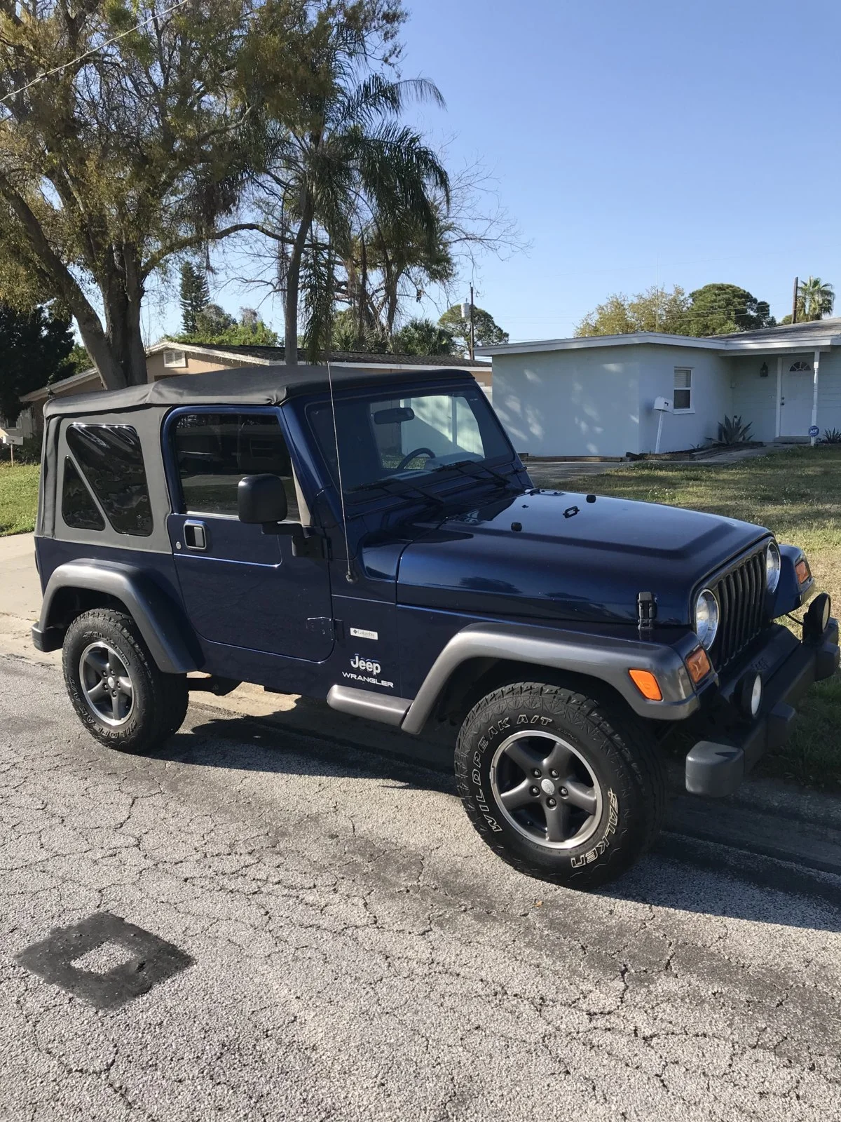

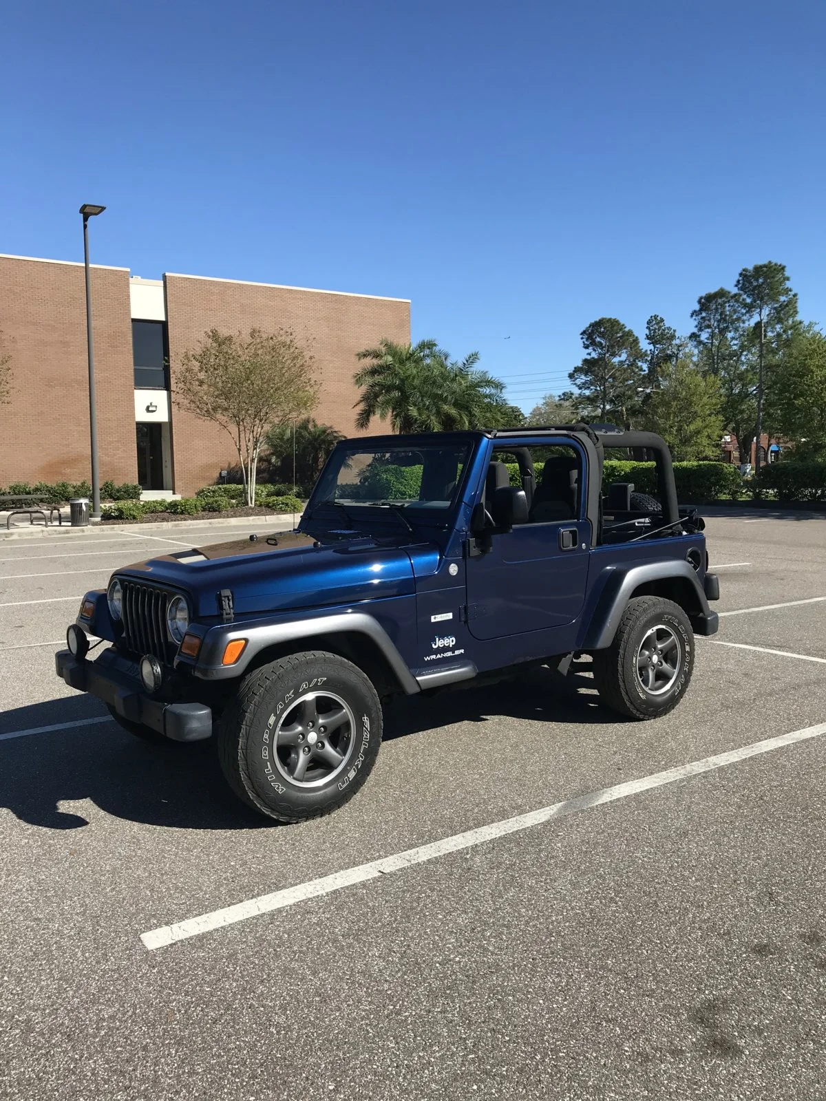

So below are some pics of what I have to start with.
She is a beauty, I'm a little jealous. I didn't want a black Jeep because I like the look of a color with all black trim. When you change out that rear axle let me know, I'm struggling to upgrade my Dana 35 to what was stock on 03 up I.e. traclok with disc brakes and the series 4 gear sets. Aka 3.73 and higher.

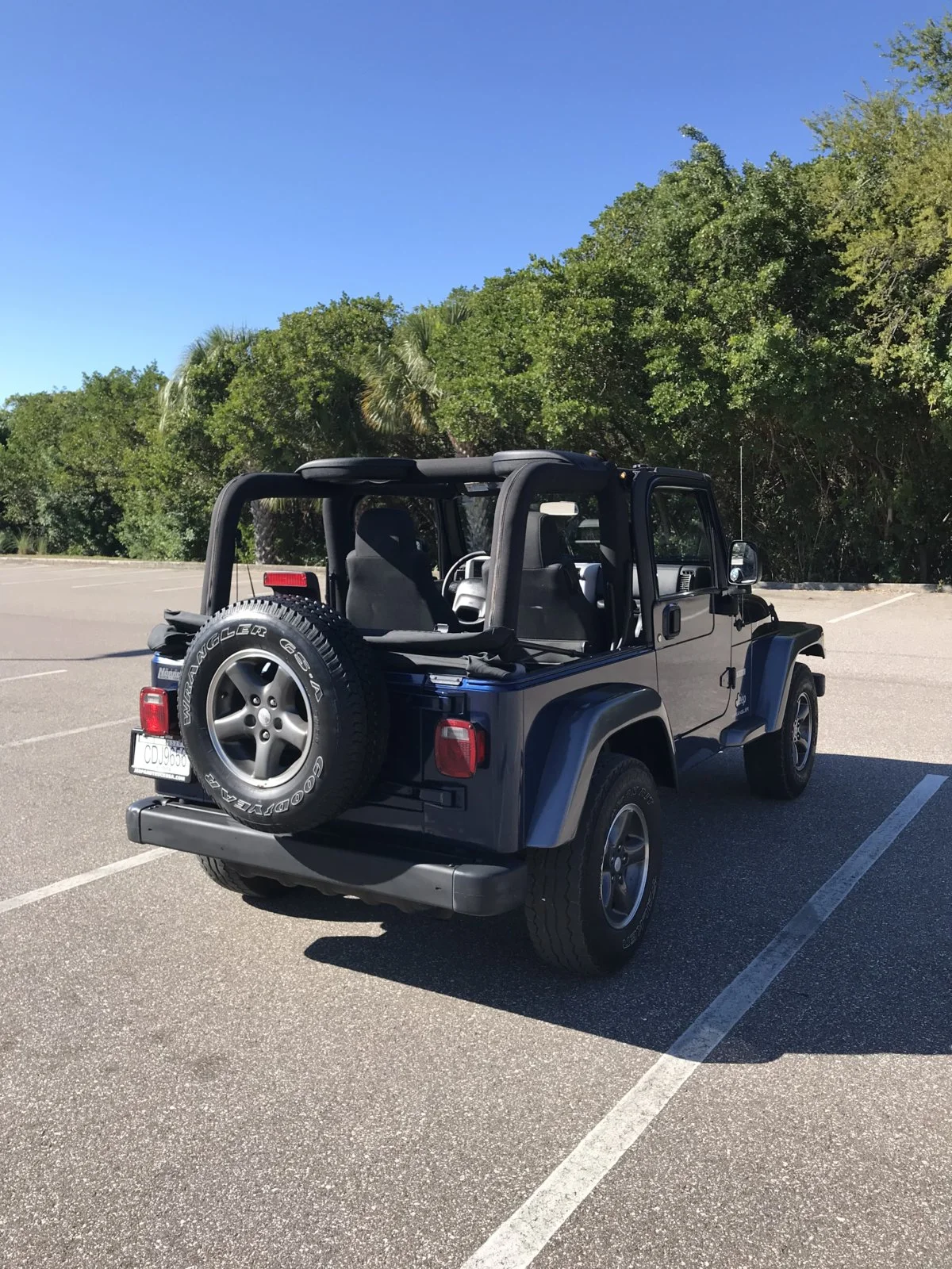

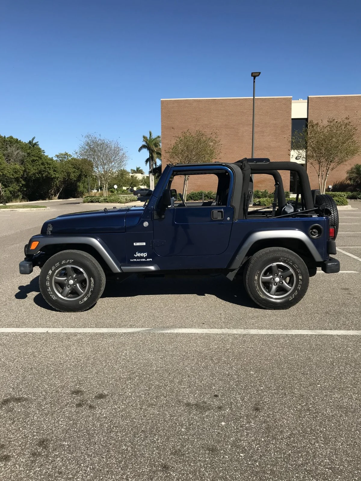

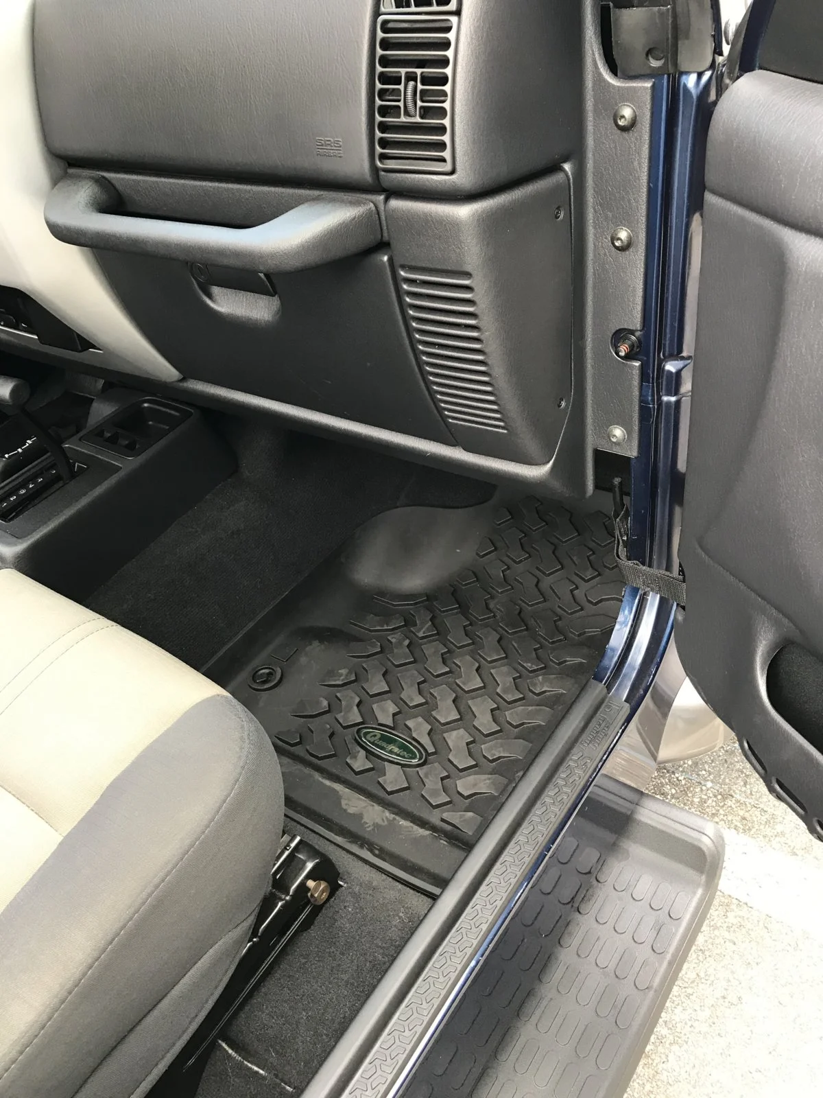

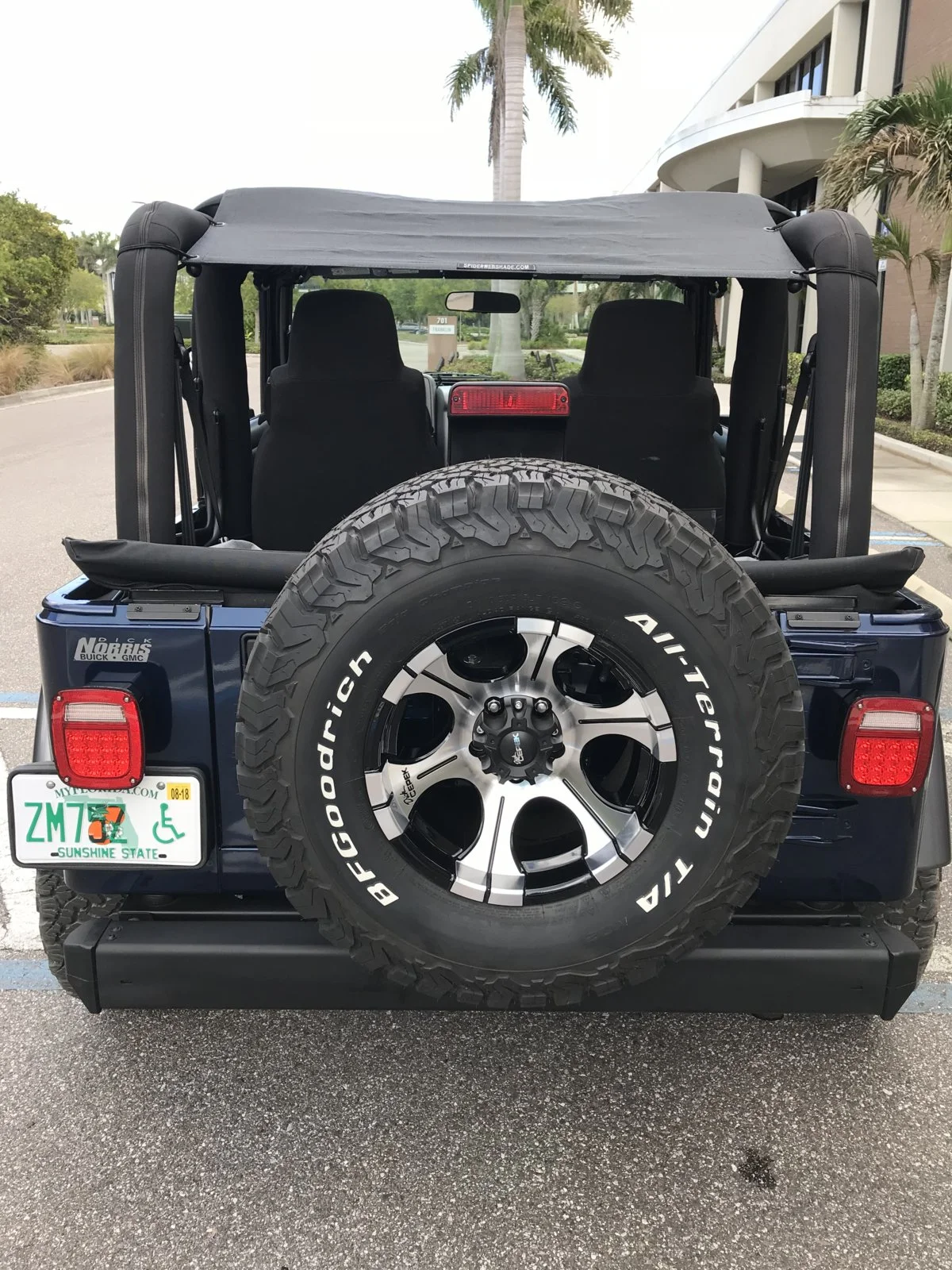

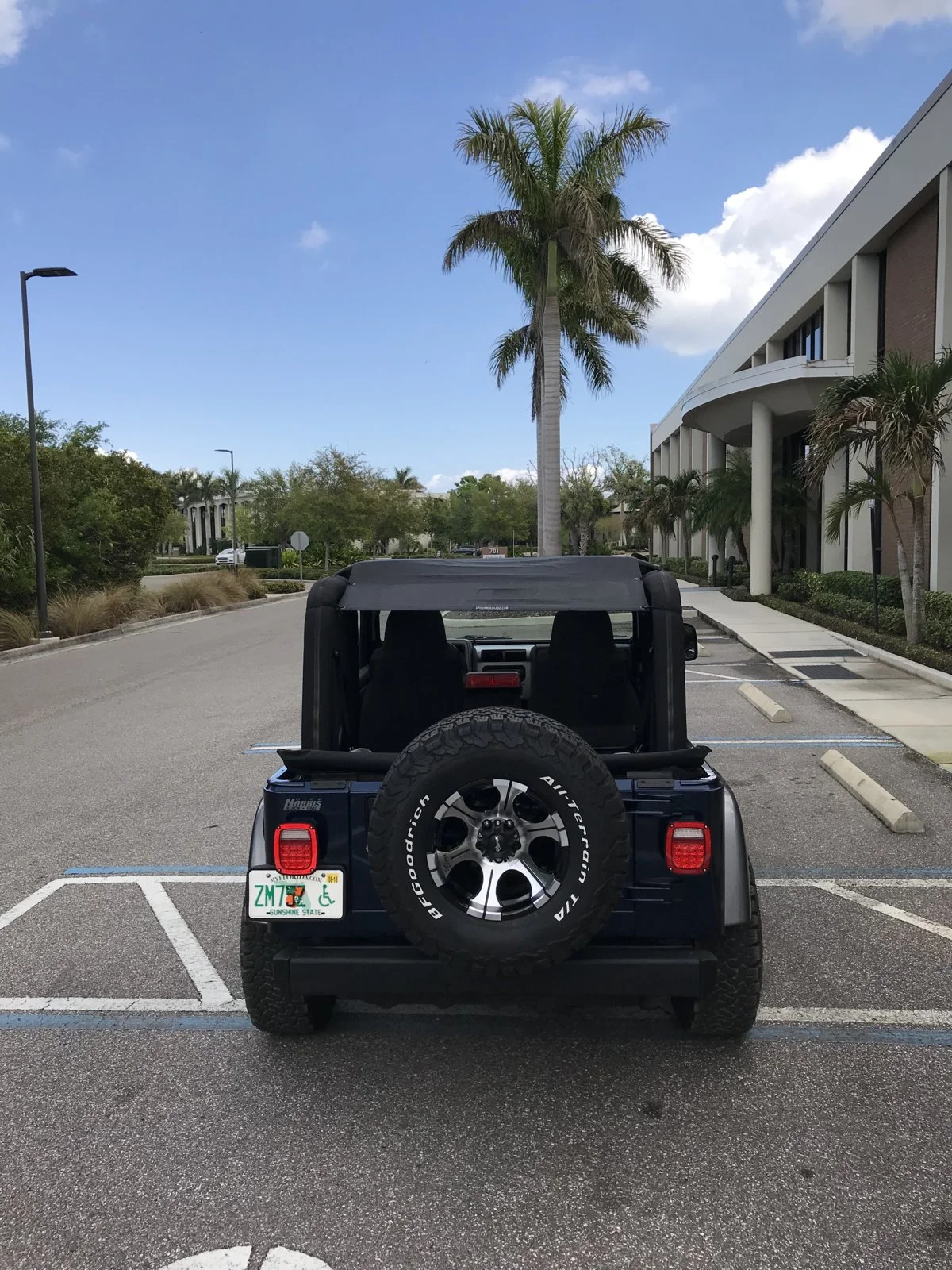

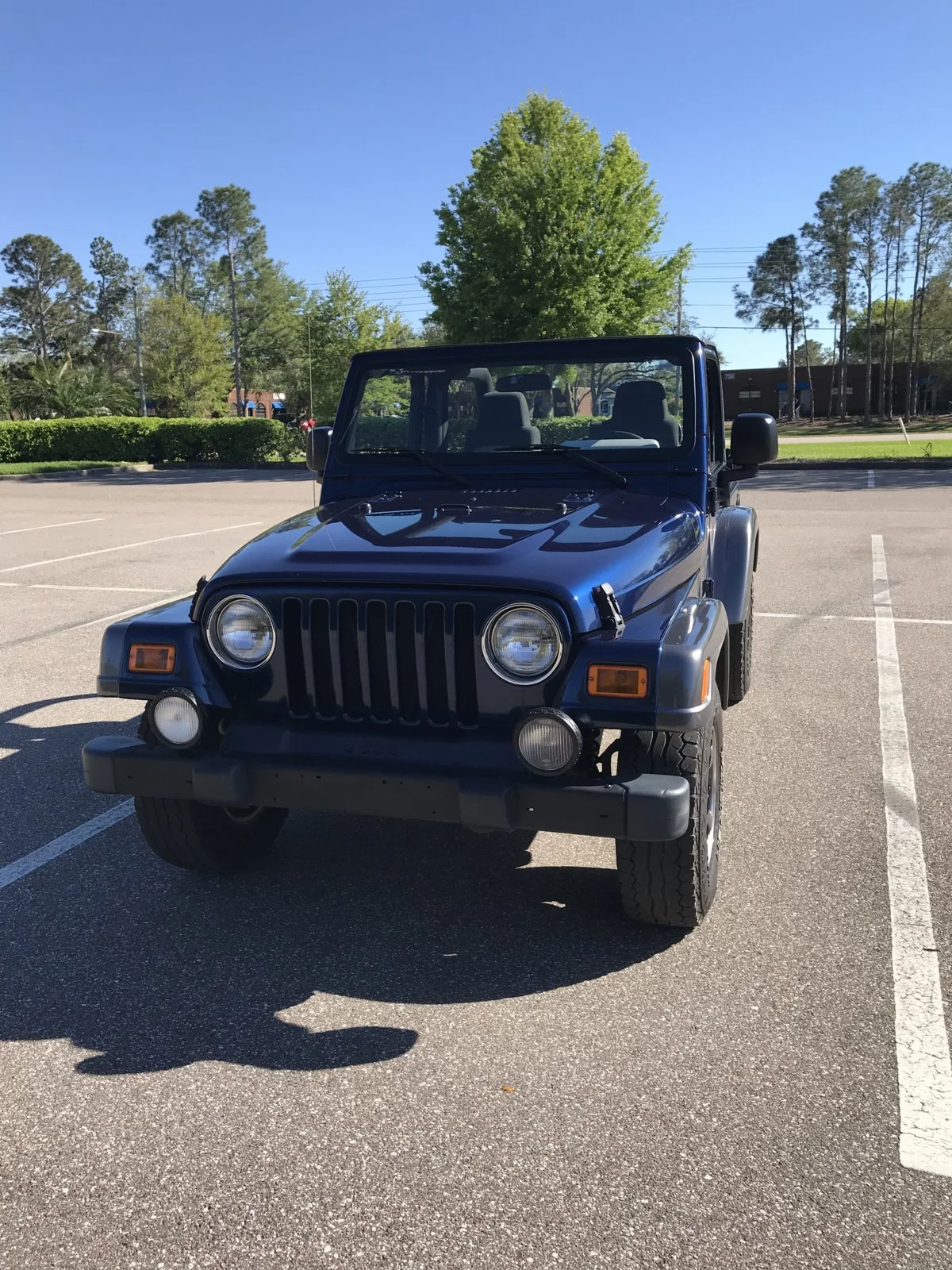

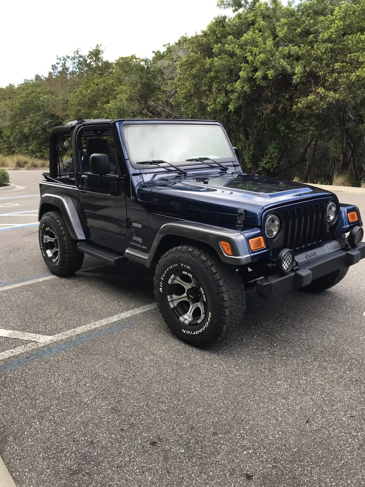

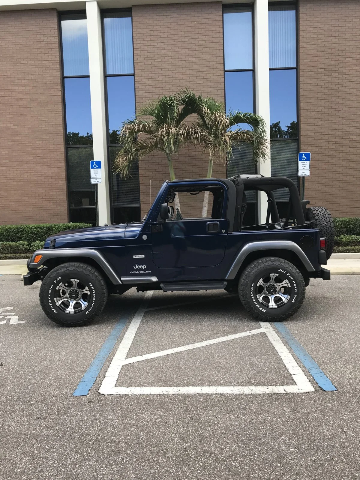

I was all enthused about the lift until I had my tires and wheels installed. I get no rubbing with stock suspension even at full turn due to 3.625" backspacing on my 31x10.5R15 tires. I like the way they fill the wheel wells. And for now there will be no off-roading. If that changes, a lift will happen, otherwise, I do not know...thoughts?
OK so here a a bunch of pictures as the Jeep sits now. These are followed by some pics related to my most recent project which was to steam clean the stock seats. Although the seats are in good shape, and fairly clean, the steam cleaner does wonders. Thew before photos are the ones before the pics of the nasty dirt/water that came out of them. And the after pics are the ones after the dirty water pics. The last pics are of my newly installed Bartact seat covers which I installed right after the newly cleaned seats dried.
Wow! Heck of an update! IMO, I think a 2" lift will fill out that stance perfectly. It looks a little lowrider-ish to me as it sits now. Nice progress.

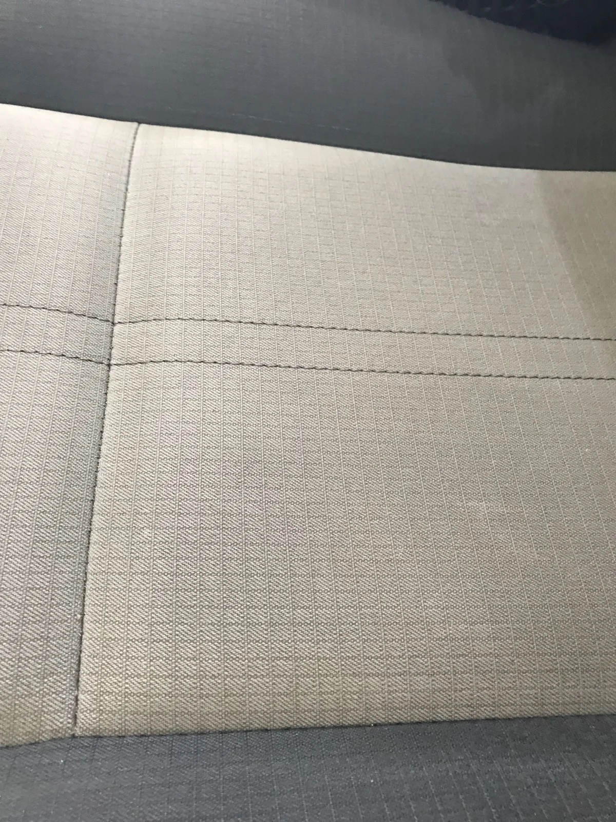

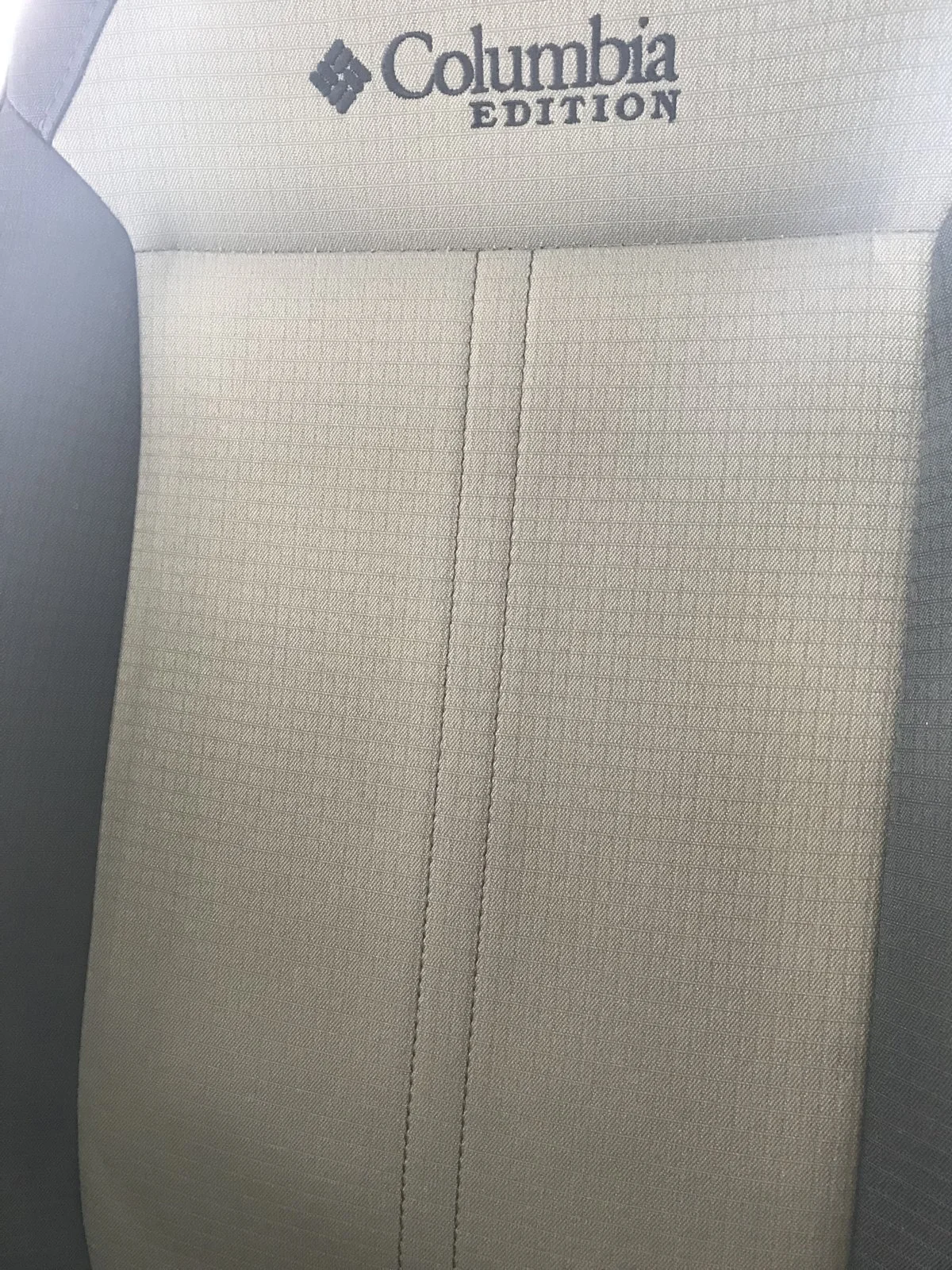

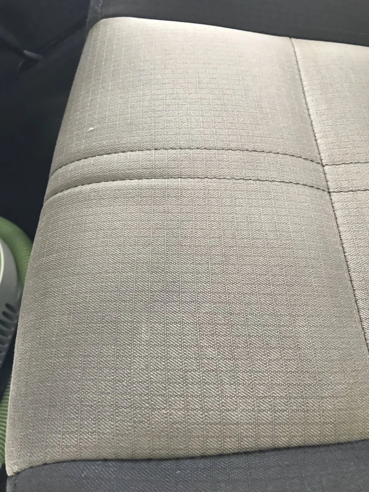

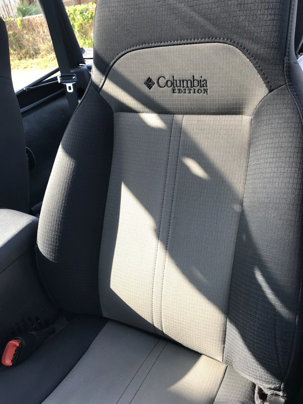

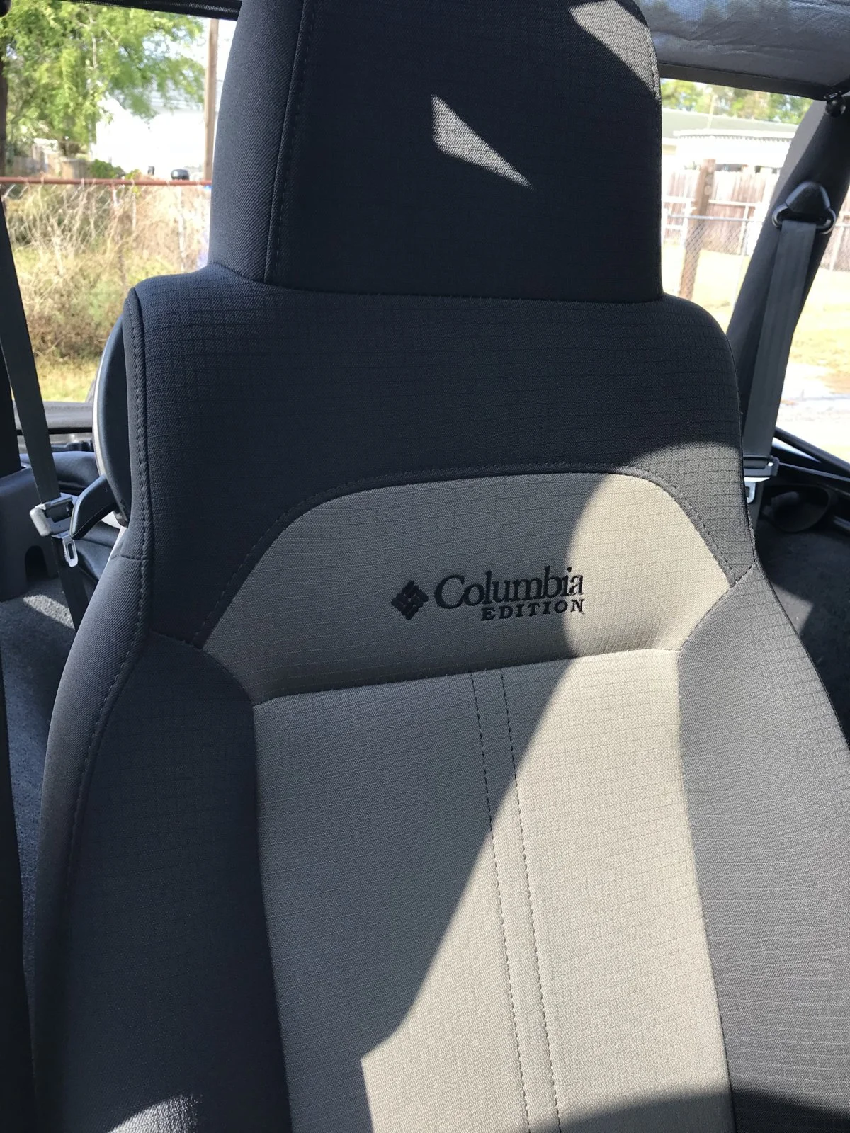

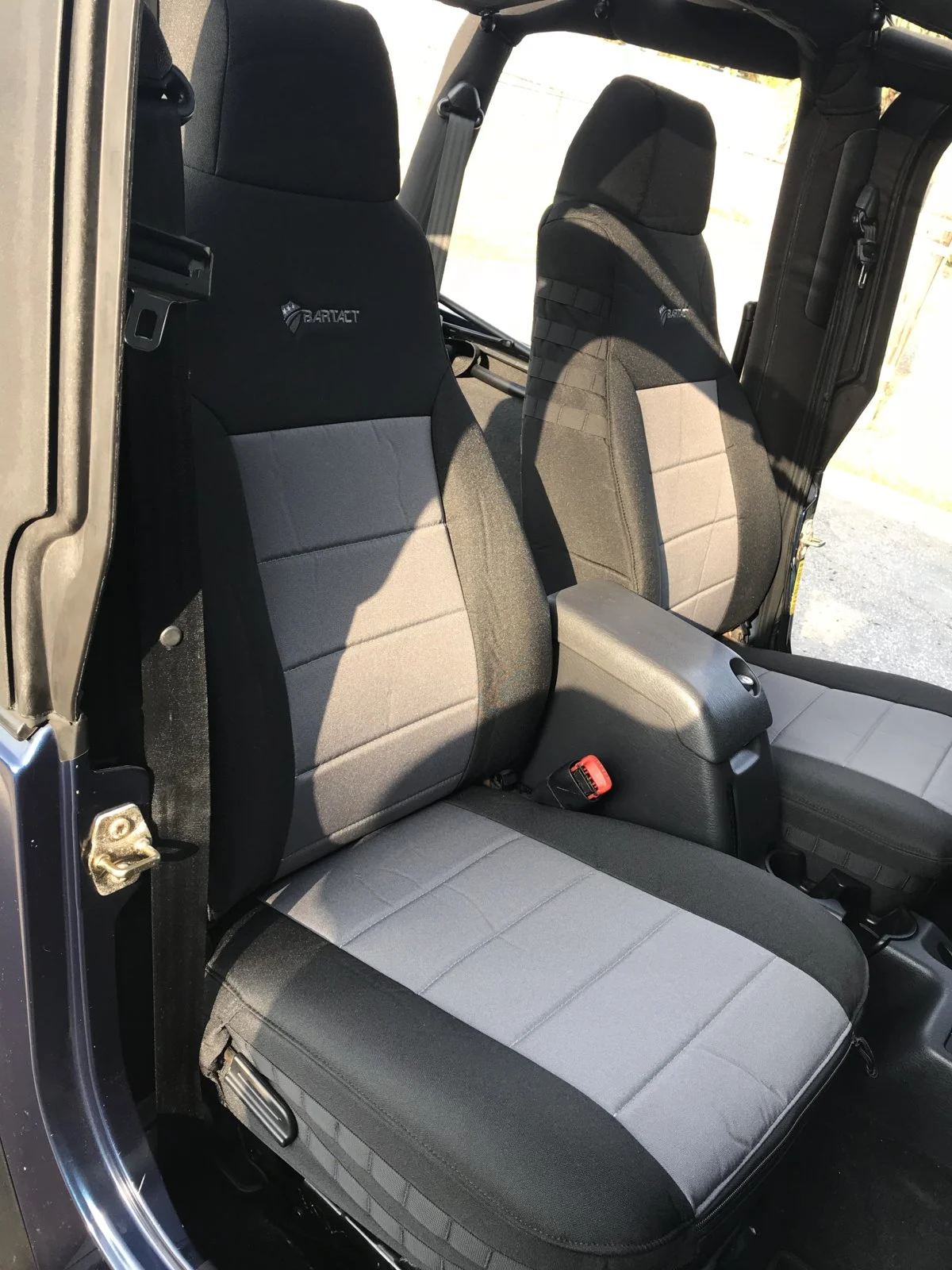

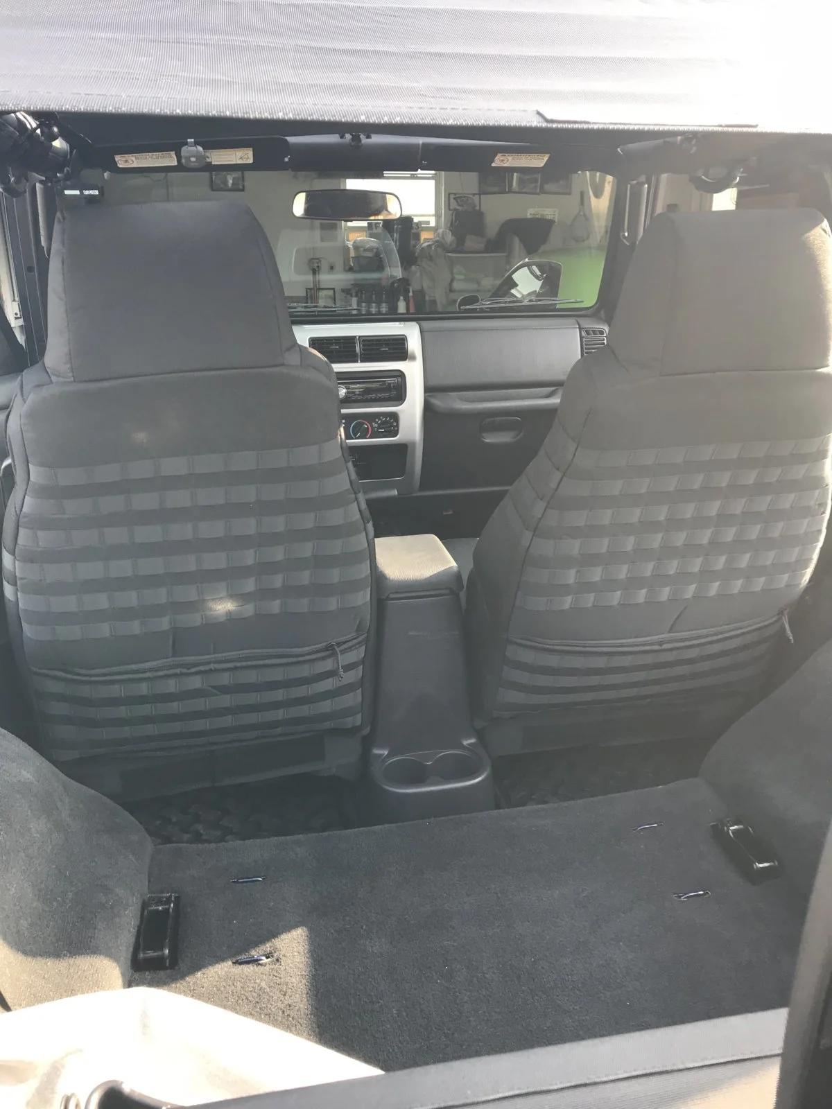

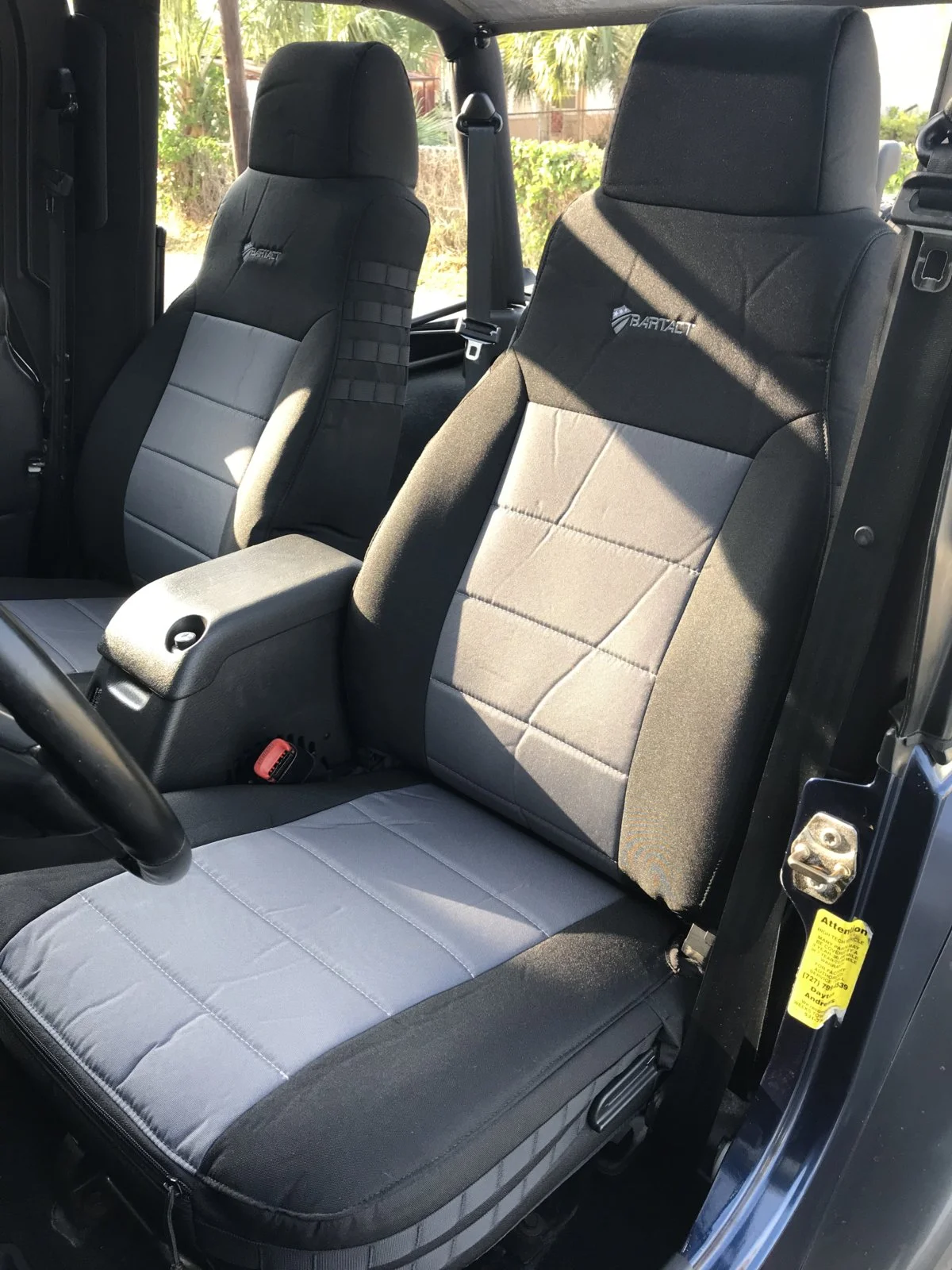

That is a heck of an update! I really dig those seats. The material looks like something a Columbia Sportswear jacket would be made of.
Reactions: mde8965

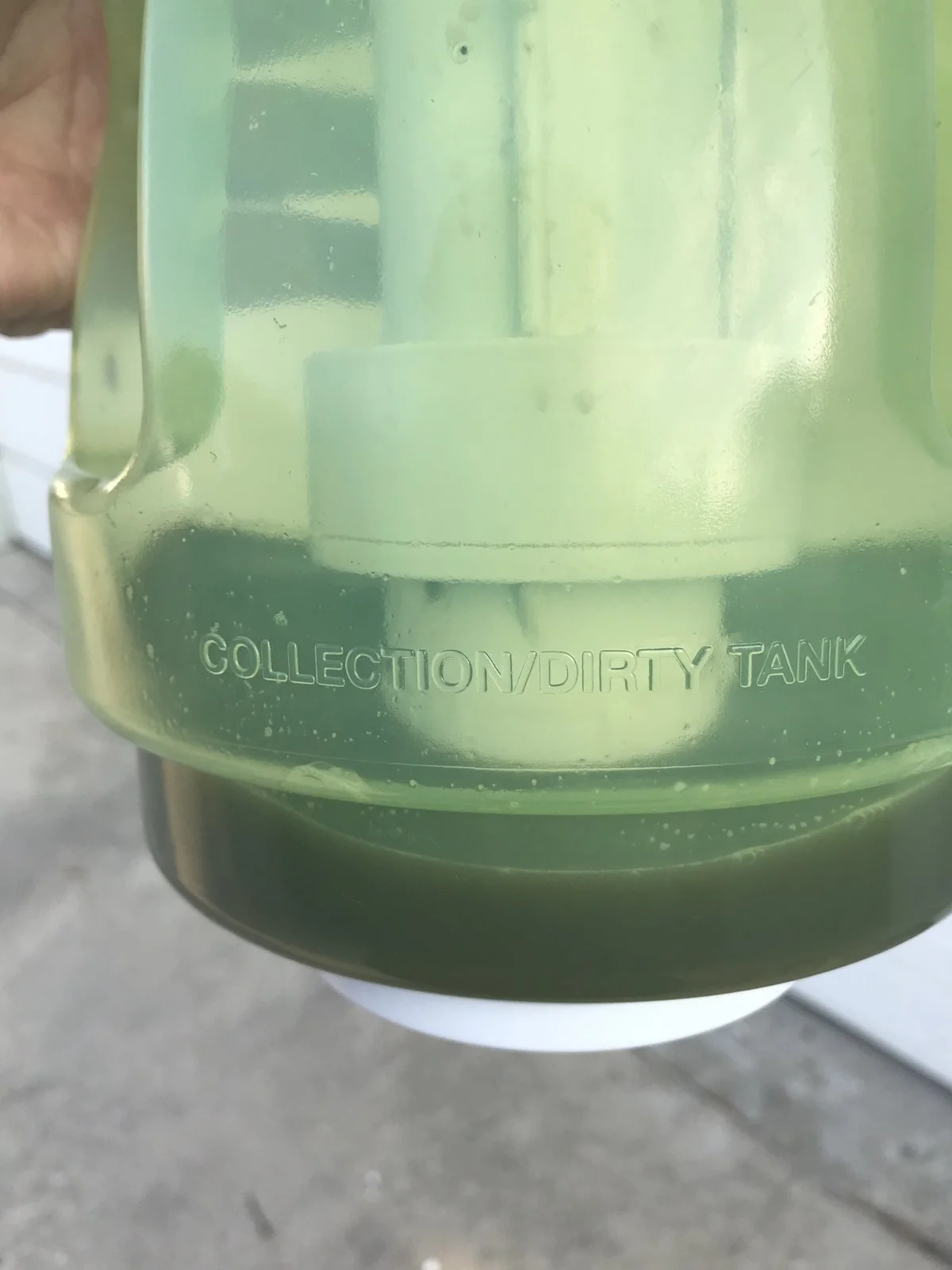

So knocked four more items off my maintenance to do list this weekend. Changed my rear differential fluid. After having changed the front last week, with the gear oil looking almost new, I expected the same on the rear. But I was wrong. I think it was the original fluid, or at least it had not been changed in a long time. Keep in mind my Jeep only has a touch over 50k miles. But the gear oil was very dark. The RTV basically flaked off when running my finger over the diff cover. So, now she has some nice new Royal Purple. Wish they could make a gear oil that did not smell like a dirty gym locker though.
Cleaning the IAC and Throttle body was uneventful. But man at first whenever I would quirt even a tiny bit of TB cleaner in the throttle body at idle it would die. Eventually it got somewhat better, but I had to quirt it very gingerly. I think I used about 3/4 of a bigger can of TB cleaner. Half of that at idle for the IAC and half while throttling for the TB.
The serpentine belt. Got that done in about 5 minutes. So easy when you know how. Thanks to this forum. I'm used to the big screwdriver pry method. But the idler pulley on these jeeps makes it so much easier...
Oh yeah, the spark plugs. Ha! Now I know why I never claimed to be a good mechanic. So I bought 6 of the Autolite XP985 (Irradium). Checked the gap and they were all just over .30 inch. Installed the new plugs with a little any-seize, no problem. From the time I started to the time the six new plugs were in and torqued down was no more than 10-15 minutes. So I went to put the coil pack rail back on. And i thought (THOUGHT) I had the rail seated correctly and the boots and plugs seated, but noticed I was having a hard time getting the rail bolts to catch and torque down. But I kept at it, having to push up on the rail a bit to get everything in and torqued down.
Well, when I started the Jeep, I was reminded that when something does not go back together just as it was taken apart, you got it wrong stupid. The engine made a horrible noise and it sounded like all the injectors were ticking loudly, or worse. The Jeep immediately threw a CEL. So I shut it off. I think I knew immediately that the rail was not seated all the way, or one of the boots was cocked or something. But in that moment, I imagined the ticking I heard may have been the valve coming in contacting with the tip of the plugs or something (I know...but I was panicking).
So its getting toward dusk now, but I removed the coil rail again, and removed all of the plugs. Plugs 2, 3 and 4 were in various stages of the tip being burnt. From slightly orange on cylinder 2, to purplish ton cylinder 3 to blue on the number 4 cylinder. But I took them all out and purposely put them back in with the worst plug in cylinder 1, the second worst in cylinder 2 and the barely burnt one in cylinder 3. This time I made sure the coil rail was fully seated front to back and all 4 bolts threaded on correctly the first time. Started up the jeep and it sounded much much better, but threw 2 CEL's. Misfire in cylinder 1 and TPS circuit. Knowing both of them are likely related to the burnt plugs...I called it a night. Went to the store today, got three new plugs, installed in cylinders 1-3 and again, made damned sure to FULLY seat that coil rail again. Started her up and she is again purring like a kitten with no CEL's.
You live and learn I guess. And I learned how NOT to change the plugs on a Jeep Wrangler this weekend. D'oh!
