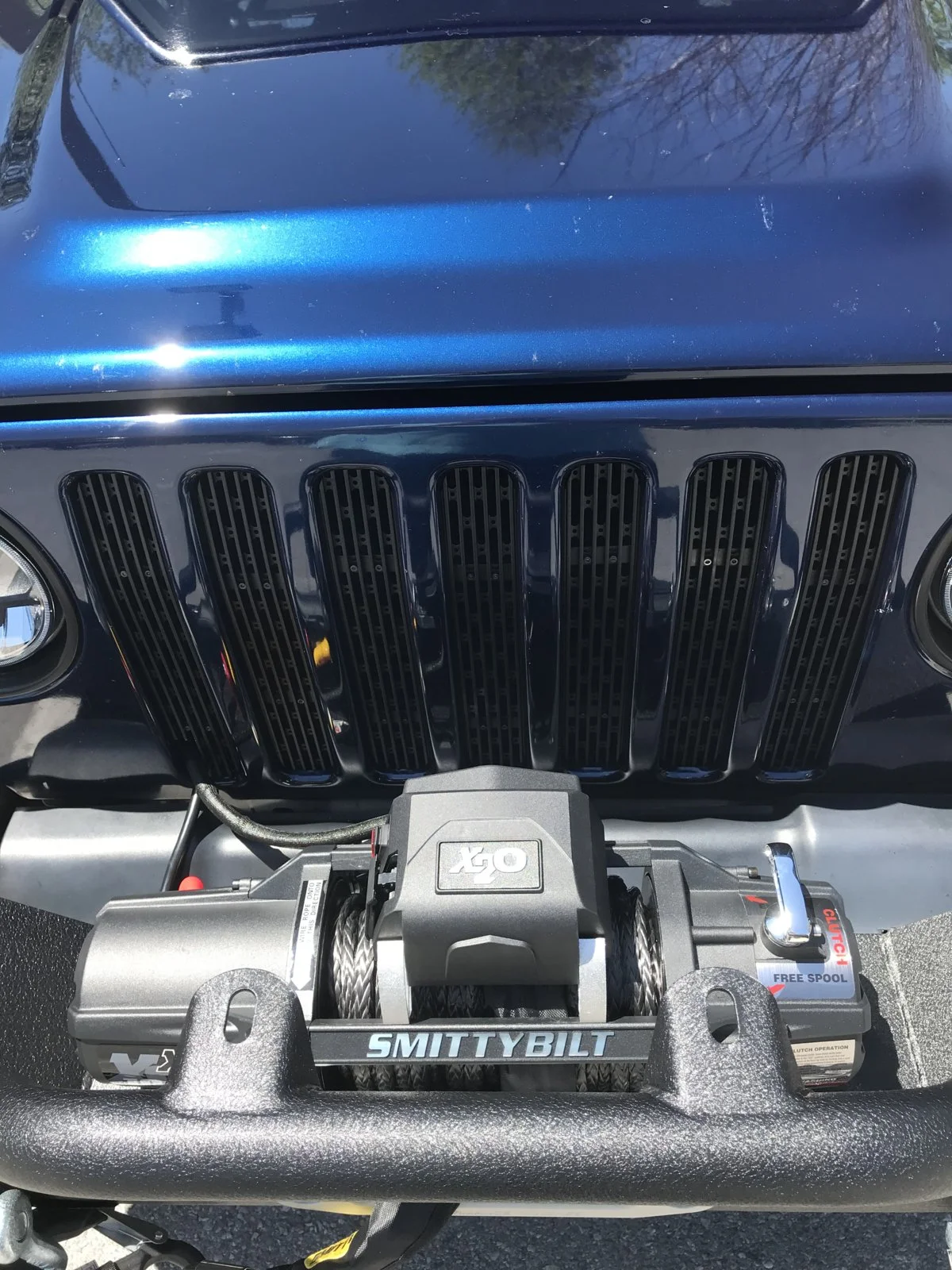

You reminded me in this thread that I never posted my last round of updates here highlighted by the bumpers and the winch.
But since my last post here I installed:
EAG front and rear bumpers: https://www.ebay.com/itm/Front-Bumper-W-Winch-Plate-Rear-Bumper-With-D-rings-for-97-06-Jeep-Wrangler-TJ/171833592138
Smittybilt Winch: https://www.amazon.com/gp/product/B00K150VAI/
New fog lights: https://www.amazon.com/gp/product/B006V7TDAE/?tag=wranglerorg-20
Rugged Ridge tube doors: https://www.quadratec.com/products/11149_2022_07.htm

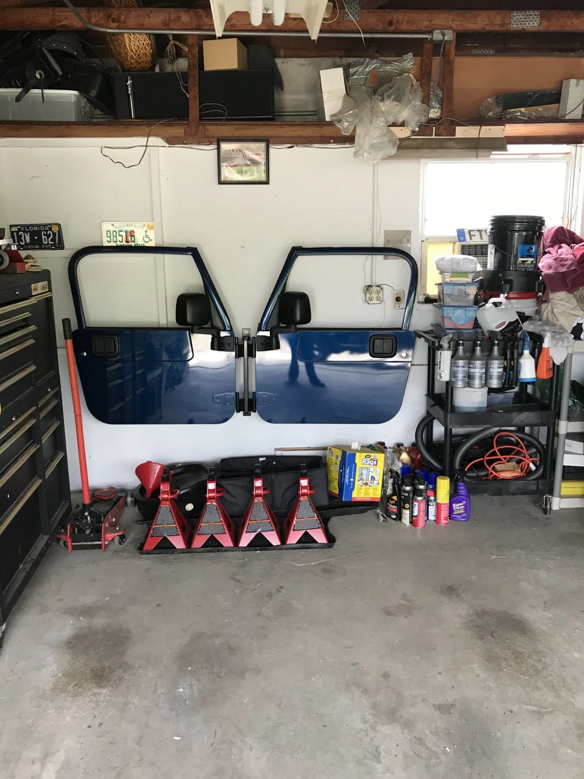

Rugged Ridge full door hangers for the garage: https://www.quadratec.com/p/rugged-ridge/wall-mount-door-holders-jeep-cj-wrangler-yj-tj-jk-jl

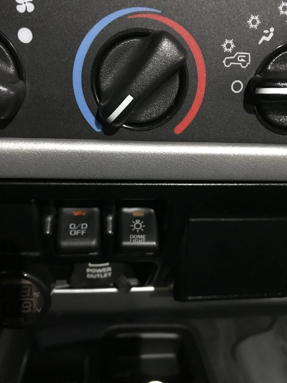

May I ask where you sourced the dome light switch? Did you just wire it to the #4 fuse?
Certainly. The link is below - added to my earlier post as well. I wired it directly to the #4 fuse. The switch is a 3 wire switch. Ideally white wire and black wire to the #4 fuse position and red wire to switched or unswitched power. However, I opted to just wire red and black to the #4. Did this because with red going to switched, I could not use the switch with the Jeep turned off (i.e. the dome lights stayed lit with door open). And if I wired it to unswitched, the damned light would stay light all the time with the dome lights turned off.
Switch is counterintuitive. The switch in the UP position turns off the push switch in the door from affecting the dome lights...so the dome light goes out with the doors open. But the light on the switch comes on in that position.
The way I wired it the switch works perfect but the light on the switch is inop...

Thanks for the link. Yeah, I would just run the black/white to #4 and forget about the light on the switch. Your jeep is looking sharp, btw.

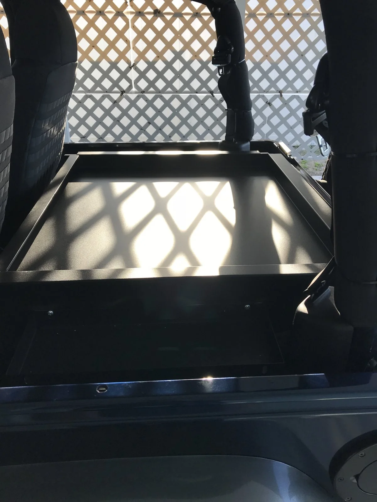

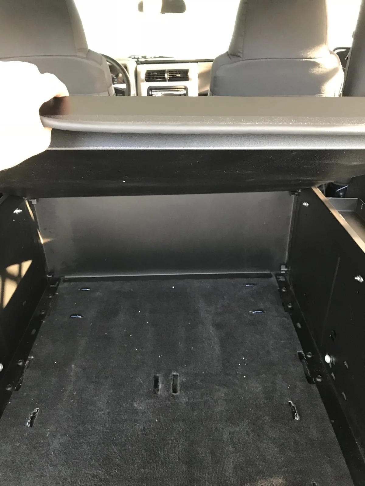

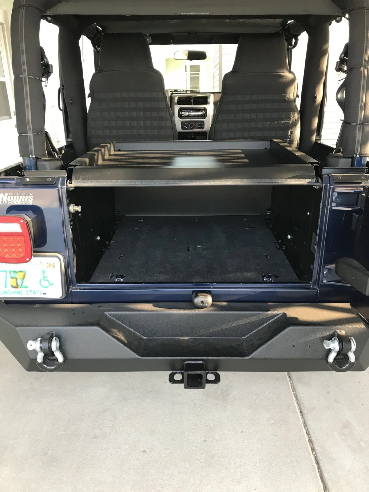

Installed a Tuffy security deck enclosure. Took about 2.5 hours to put together and install. Only took that long because I had to reengineer the way one of the fasteners attaches to the Jeep.

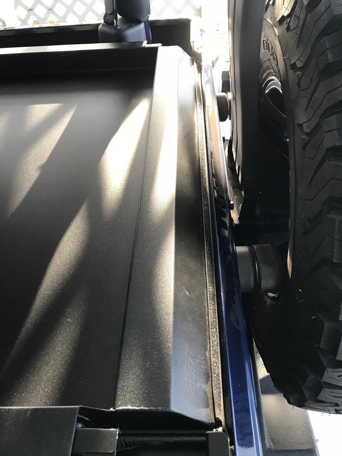

I can finally have things in my Jeep. But when I was installing this thing though I had to question the choices Tuffy made with the fasteners/hardware more than once. For instance the top slides/rides in a channel on the bottom part. Since the thing was $460 you would think there would be a nice roller bearing assembly or something. Nope it rides on freaking fender washers spaced out with little cutouts of clear tubing. Seriously? Additionally, you can pull then lift the top for easier access to the stuff inside (see pic below) but for whatever reason Tuffy did not provide a way to prop it open. Would a prop rod or better yt a couple of hydraulic prop rods would have been expected for $450+ these things go for.
On the plus side it sure is solid. I realize it’s only as secure as the lock on the Jeep tailgate. I don’t have any rattles.
Anyway it is in there and it is useful. But if I had to do it all over again, I probably would have just made my own slightly less secure solution for a lot less money. I would say this thing is worth $200-$250. Not $450+. I do understand that time is money too...and it would take a while to design and build your own.
Have not had my soft top in The Jeep yet with this thing. I would think it should be fine. It will make the retracted top sit higher when folded back. Hopefully it won’t obstruct the view out the rear view too much.

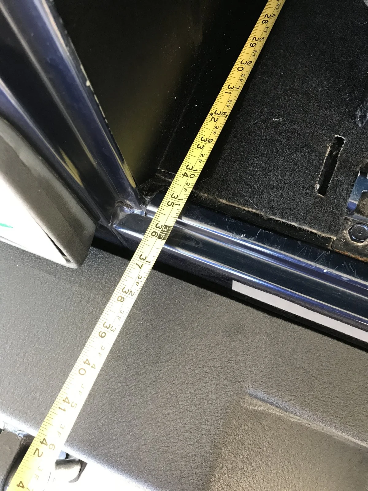

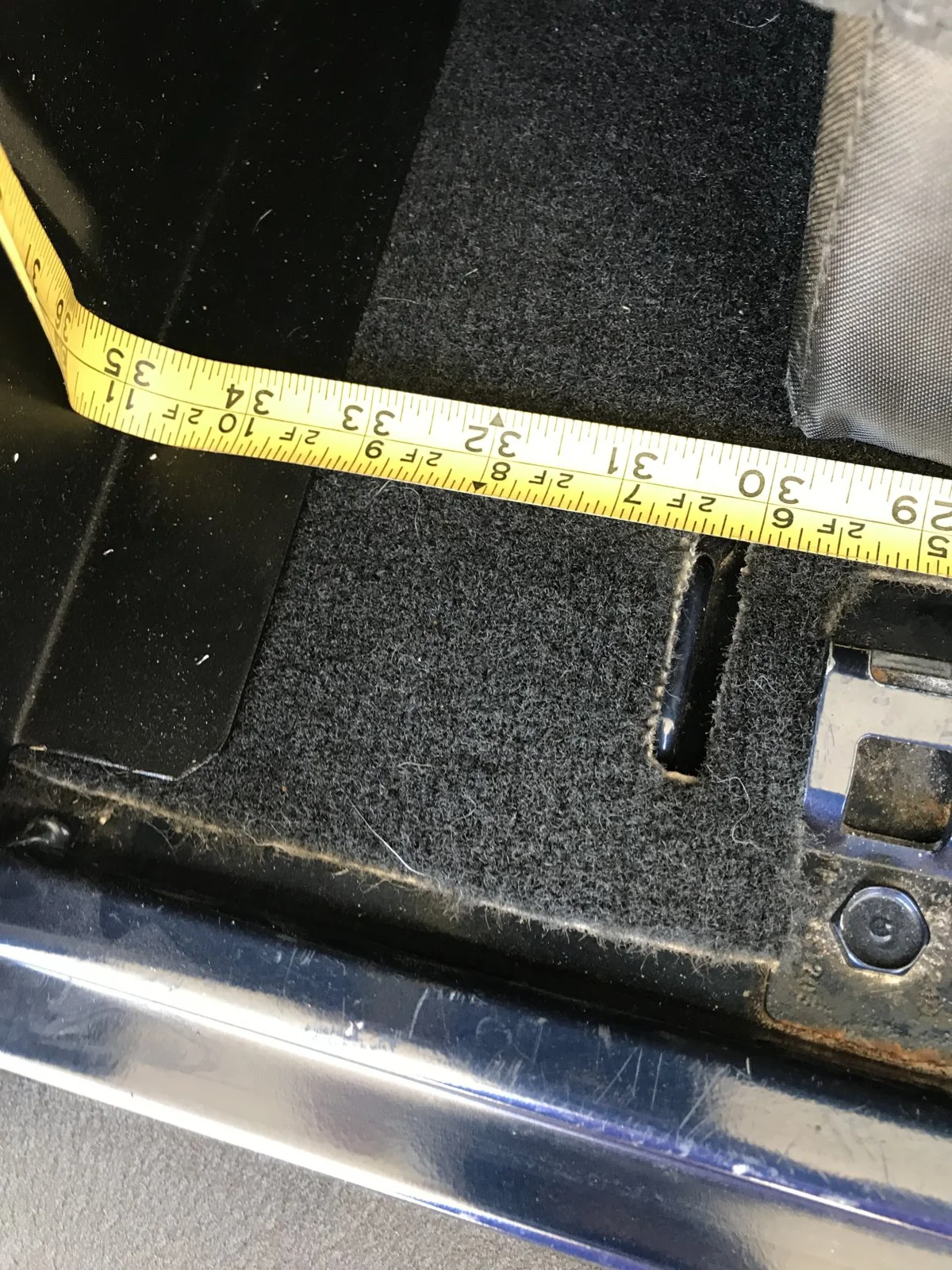

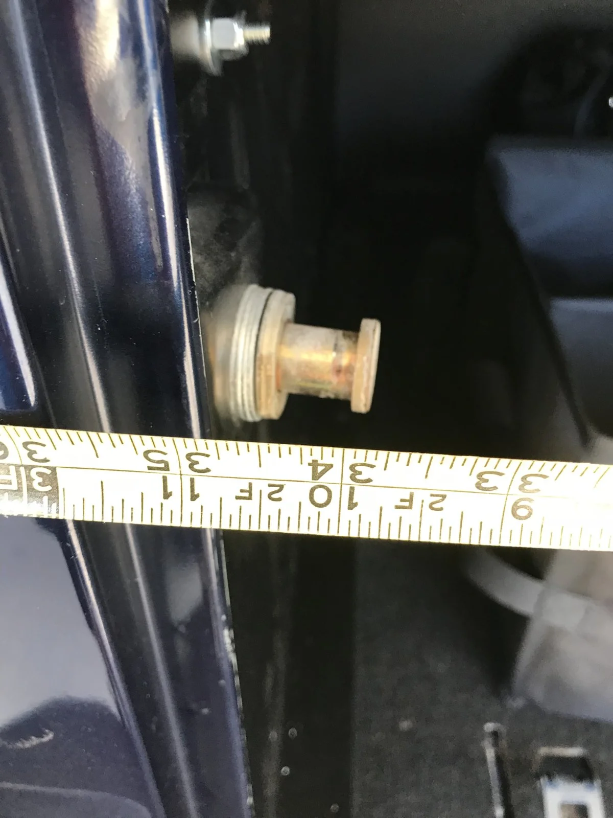

Best guess, do you think a 35" tire could fit in the lower compartment? My plan was to shove the spare down there and have the upper portion left to use for regular every day needs.

I will take a couple of measurements tomorrow when its daylight and let you know...

Your 35” tire is probably slightly less than 35” this is important. The compartment craters by this enclosure is 35 ¼” wide,about 34 ¾” deep and about 15” tall. But there may be interference with the striker for the tailgate. See pics of measurements below
Thank you so much man, that's really nice of you to take the time to do that, I really appreciate it.
Good to know there's a chance it could work (possibly)
