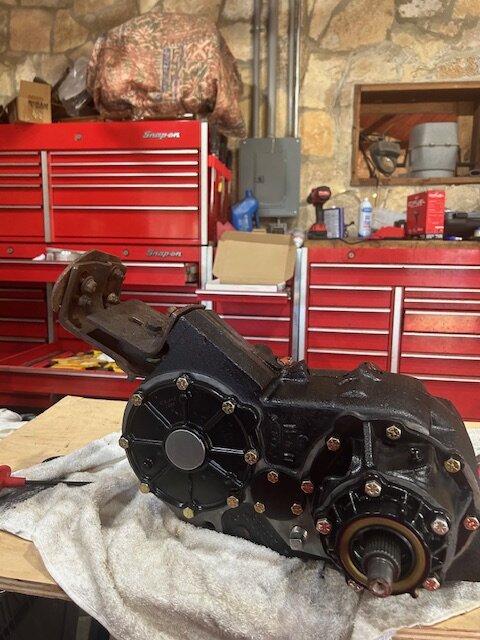

Well I found and ordered a case off of EBAY. I will get started on ot when it gets here, I am getting very proficient at assembly and disassembly
If you all have any requests for how to's post em up and I will try to take some time and get detailed photos and answers for youall

No picked on up off EBay for 90.00 plus 150 for ship
Literally had the case torn completely down in about 10 minutes
