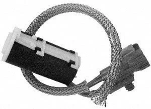

My Jeep will start without pushing in the clutch, so I ordered a new switch. I don't know what is going on nothing changed?
