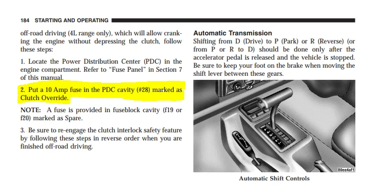

You need to install a 10A fuse into slot #28
Thanks for the info. There is one there already, and it seems to be intact. I'll swap it out on the chance there is an unseen break at the bottom causing it to intermittently short out.
A Rubicon, and only a Rubicon, should start without the clutch being pushed in when in 4L. No fuse required.
Also, the clutch switch is recalled, but if you don't want it, just jumper it. Mine failed so that it jumpered itself.

Belay my last comment. I have a blank in fuse #28, not contacts. And I didn't notice the 4L light on the dash when I engaged it. I use 4L pretty regularly in the winter. I'll crawl underneath and see if there is corrosion on the contact.
