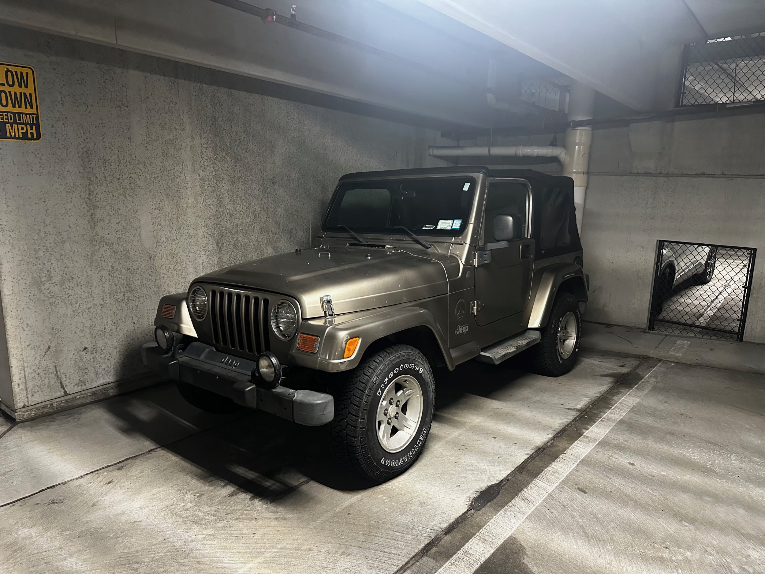

Edit: Added a picture!
With a 3" lift you will likely need the SYE and a new driveshaft.
While some body lifts do indeed look tacky, the 1.25" from BMB looks right and is barely noticeable.
I'm running the BMB body lift and 2.5" springs to clear 33" tires (285/70/17).
I initially tried 3" springs but got driveshaft vibrations.
Reactions: TheBoogieman
[*]3 inch lift from BDS. Good? Price is not a concern.
Yes, but I wouldn't go this route if I were you. You need 4" of lift total to run 33s and maintaining factory up-travel.
If you're smart you'll go with a 2.5" suspension lift and a 1.25" body lift, for a total of 3.75" of lift which will be perfect for 33s. In addition, you'll save a lot of money.
See this thread, this is the route you should go: A recipe for an affordable but quality 2.5" lift

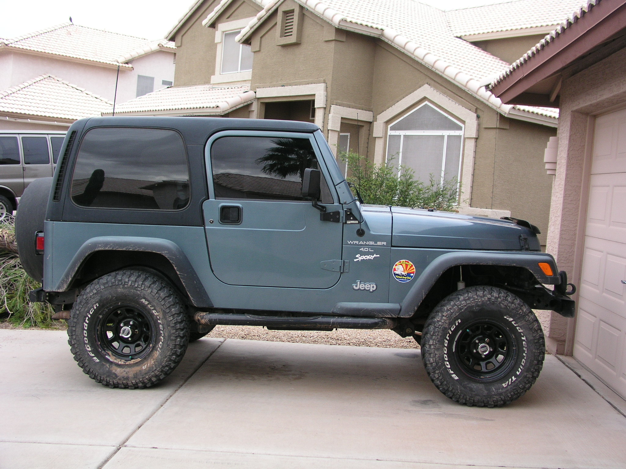

Also, now that I've been looking at 2.5" suspension and 1.25" BL as you suggested, I see a lot of people running 35s on this set up.
The reason I bring up 35s is because I really want to run flat fenders like this on my TJ because I absolutely love that look. However, I worry that 33s will look far too small with those fenders. Thoughts?
No one who knows anything about properly setting up a TJ is running that setup with 35s.
Also - keep reading and doing your research here. Running 35s is another whole can of worms compared to 33s. Brakes, gearing, axle upgrades / replacement, etc.
Give me a yell when you start thinking 'bout Tonz and Fodeez. 😀
