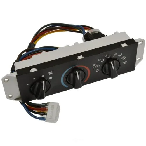

I don't think I have seen this posted yet.
My fan speed switch was starting to act up and I began the search for a replacement. In the past, your choice was a MOPAR assembly for approximately $500 or try to fit an older switch into the 05, 06 panel, and I think I saw some folks modifying the vacuum hoses/connections due to a different length or diameter if you bought a panel for an older TJ.
I found that Standard Ignition makes a plug and play panel, P/N HS-532. It includes a vacuum harness that plugs into the vacuum plug behind the glove box and a 3 yr warranty. I opted to pay a few bucks more than the lowest price for it and got a lifetime warranty with it from O'Reilly.
