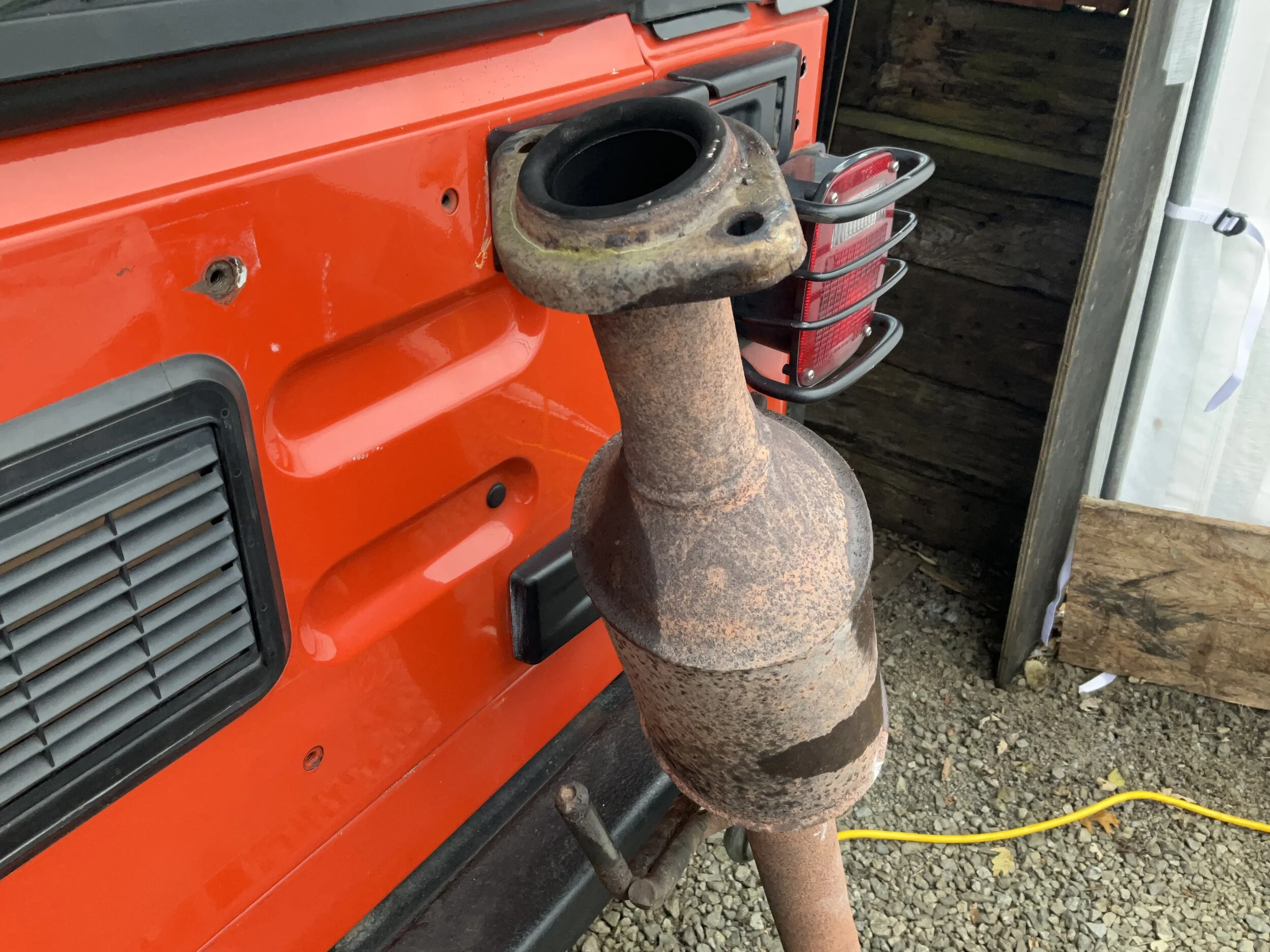

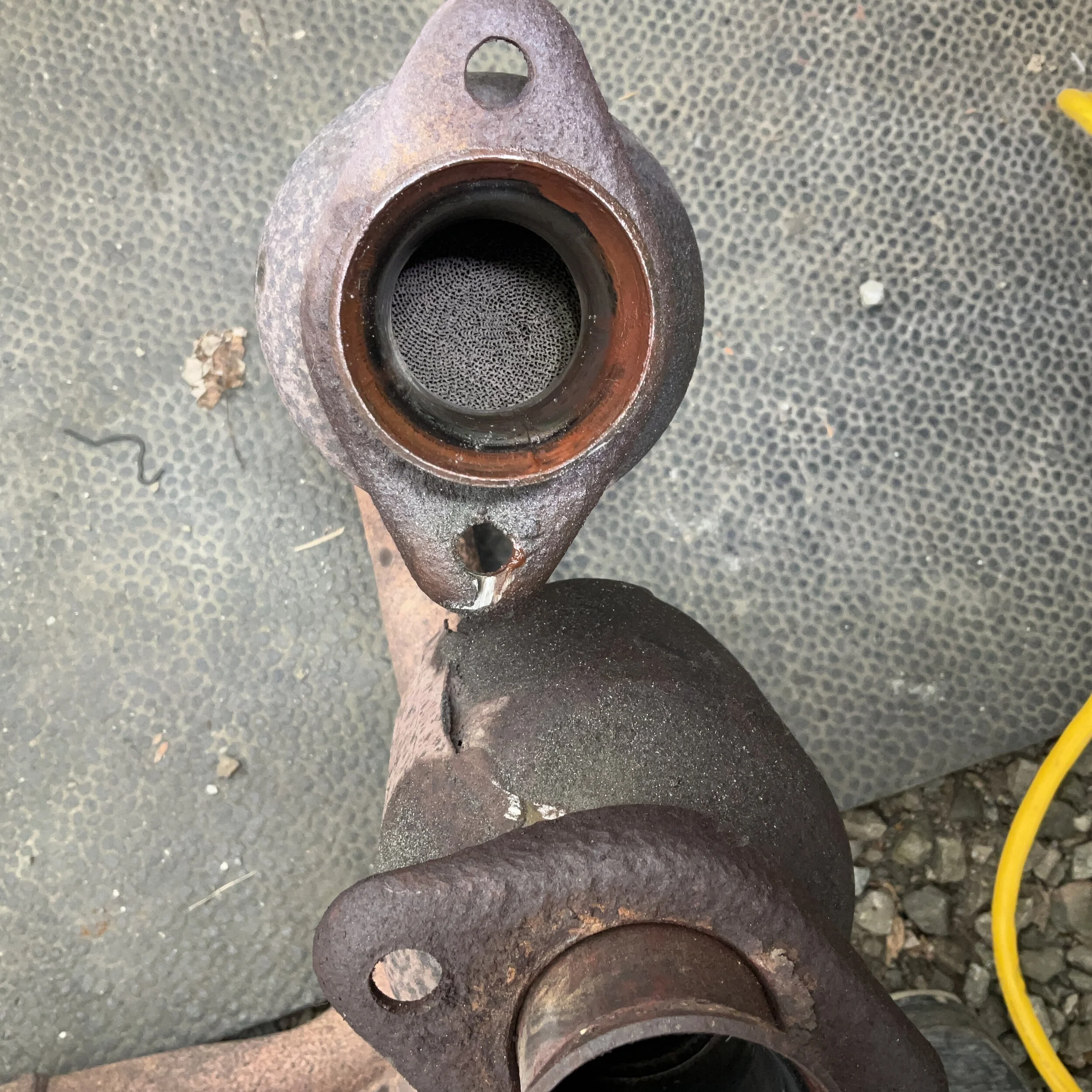

I get a O2 sensor bank2 no 2 code once in a while and after reading some posts here , I removed the whole exhaust system ,,,,,the cats seems ok , no rattling noise , no loose particles , even the look seems great
Does it look ok ?

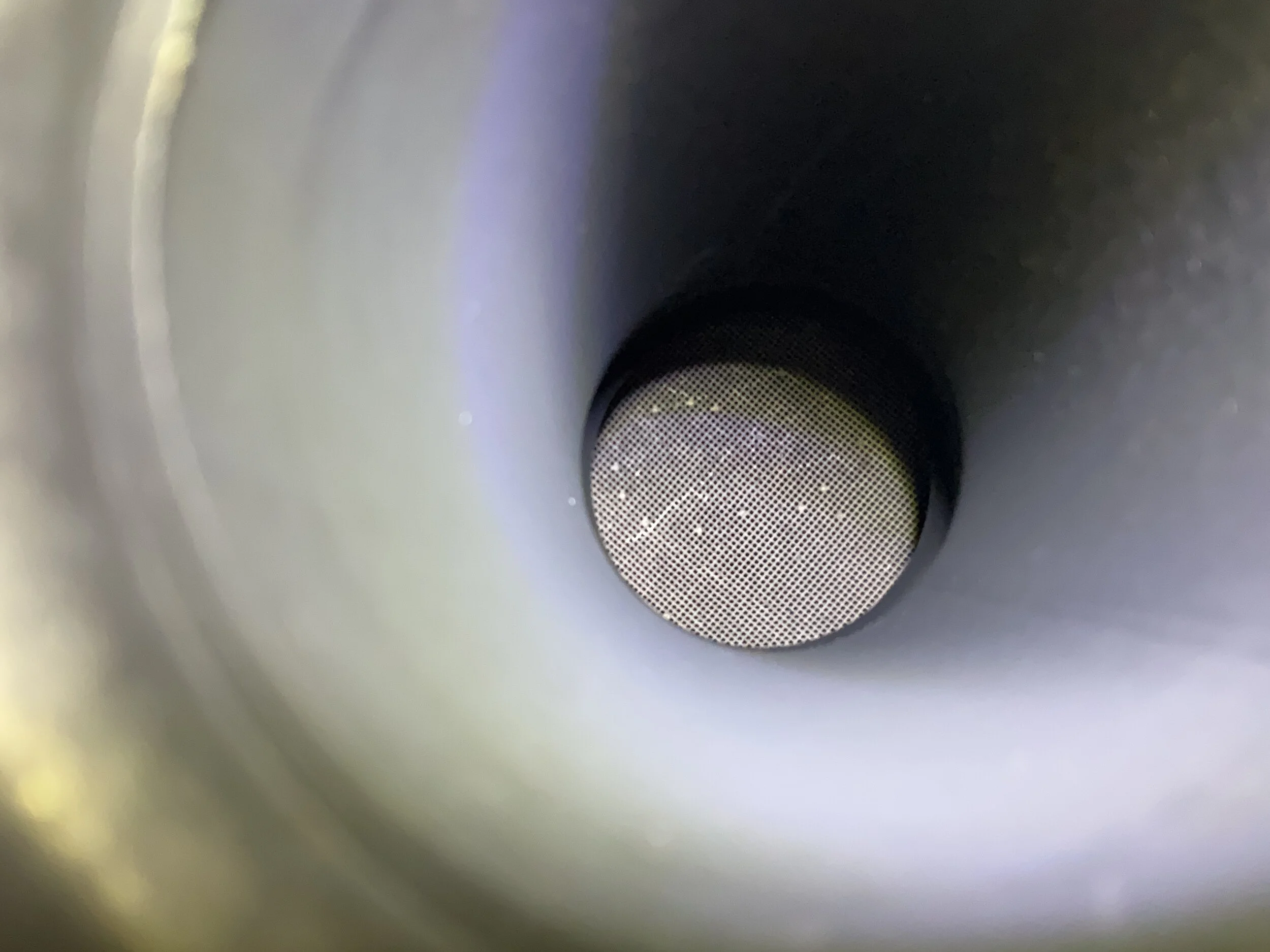

Other thing ,at the end of the front exhaust pipe near the muffler flange ,is it a third cat or a resonator ? What bugs me is that there is a grid
Thanks

Yes, all of those are catalytic converters. Luckily, they all look structurally intact.
The oxygen sensors for the computer to measure exhaust gasses and meter fuel are just before and after the smaller first two. The third is just extra.

You can remove the third cat without any issue.
