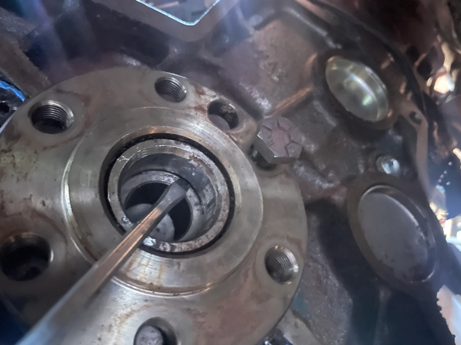

  • If jeep is a 2005 or 2006 i know for a fact there is a pressed sleeve into the rear output of engine that needs to be cut out to insert the pilot bushing from your clutch kit

Thank you for reading. I'm sure I might have forgot to type some information in the post, and even forgot when filming the video. If you have any questions maybe I can help. The hardest thing on this is probably cutting out this sleeve to make room for the pilot...and chasing grounds.
