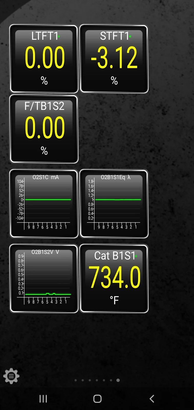

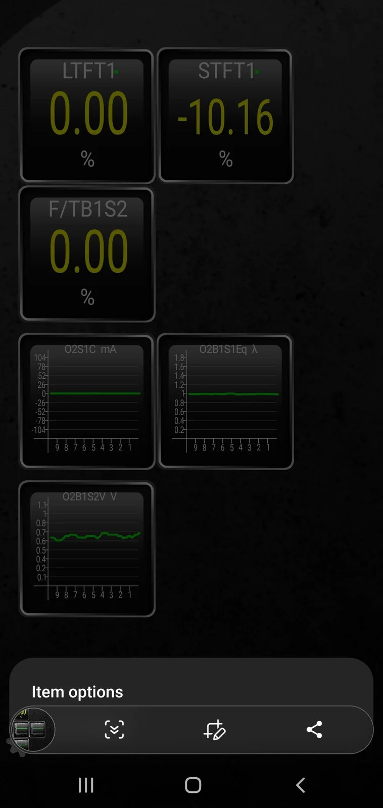

My wife's jeep. I've yet to experience it but she says it stumbles at idle (RPM dipping below 500). I plugged in my obii dongle and Torque app. One thing I noticed right away was the O2 sensors are a bit sporadic. These are at idle only.

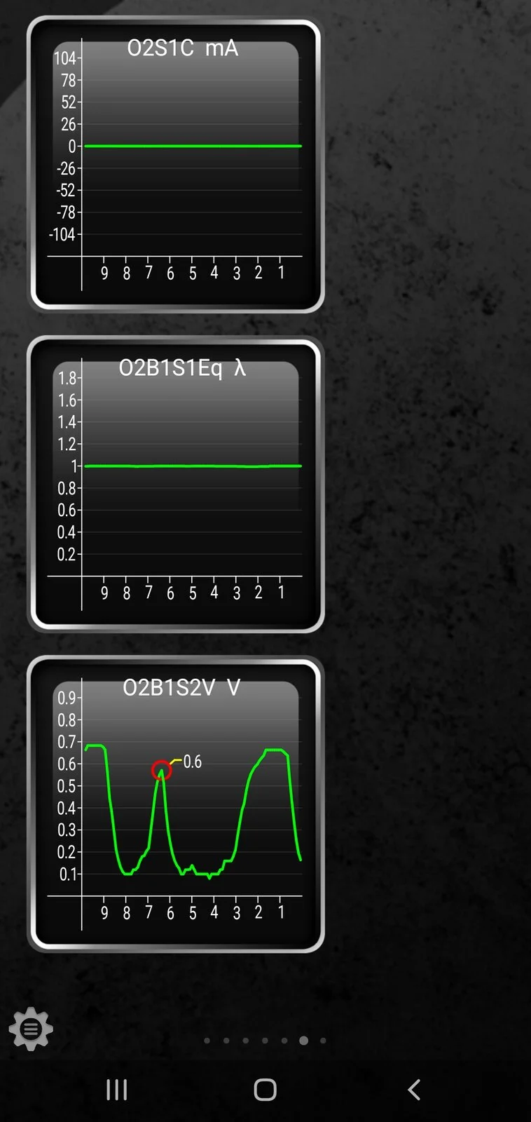

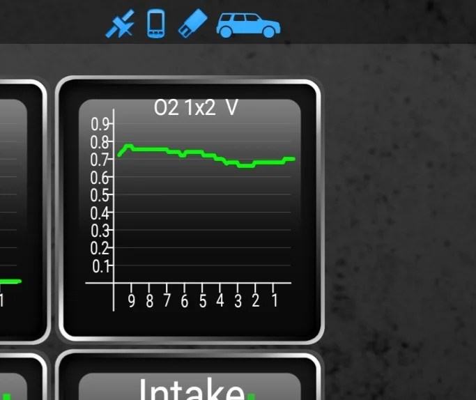

Bank 1 Sensor 2 is pretty much all over the place. Am I on the right track? The vacuum holds steady, battery (AGM) is maybe 3 years old but shows 14V, fresh(ish) air filter, throttle body cleaned maybe 2 years ago, no codes (stored or pending) and passed emissions 8 months ago. Haven't looked at fuel pressure...

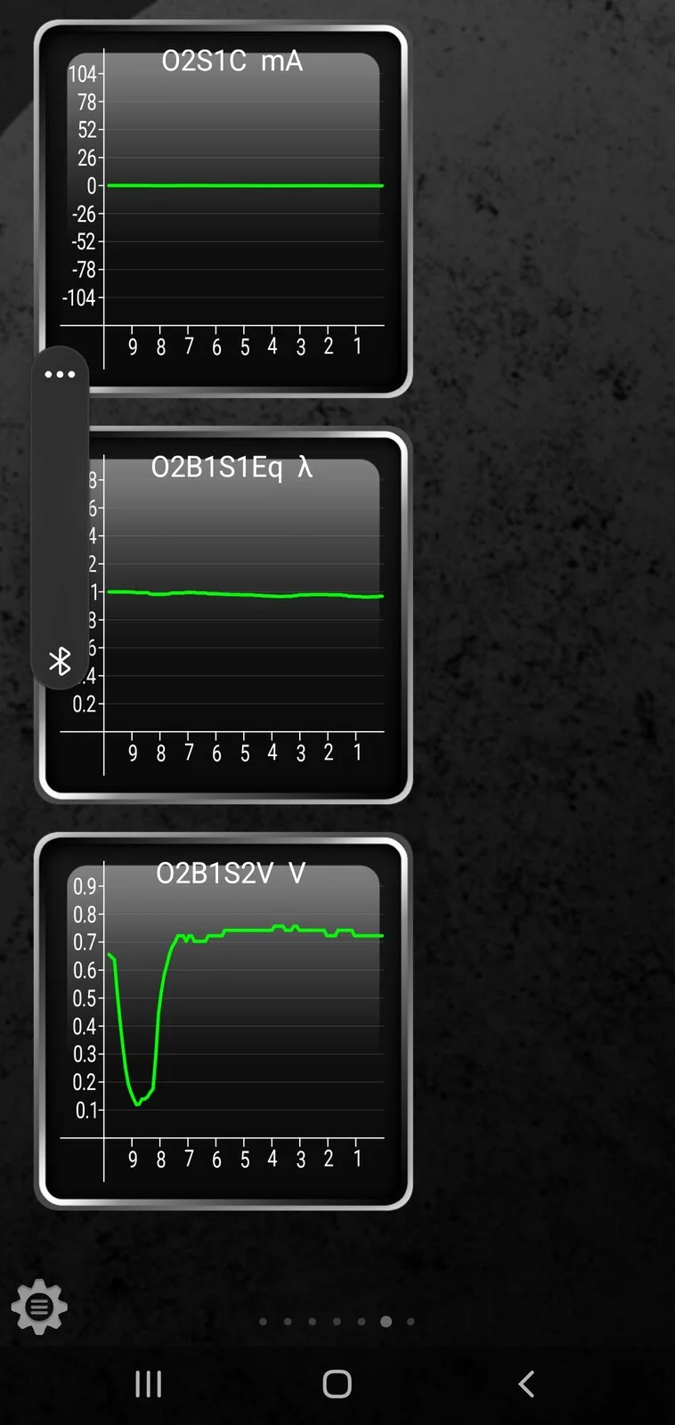

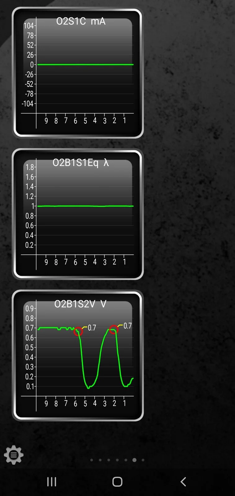

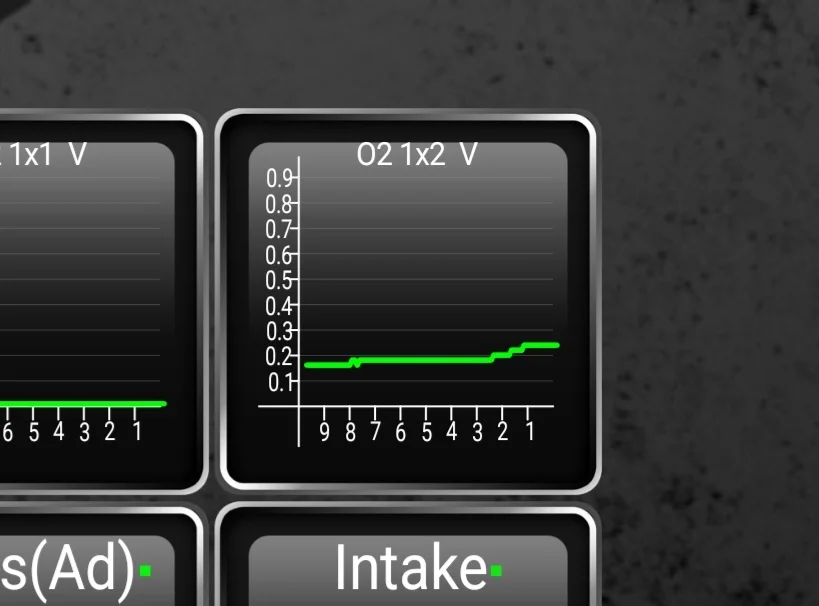

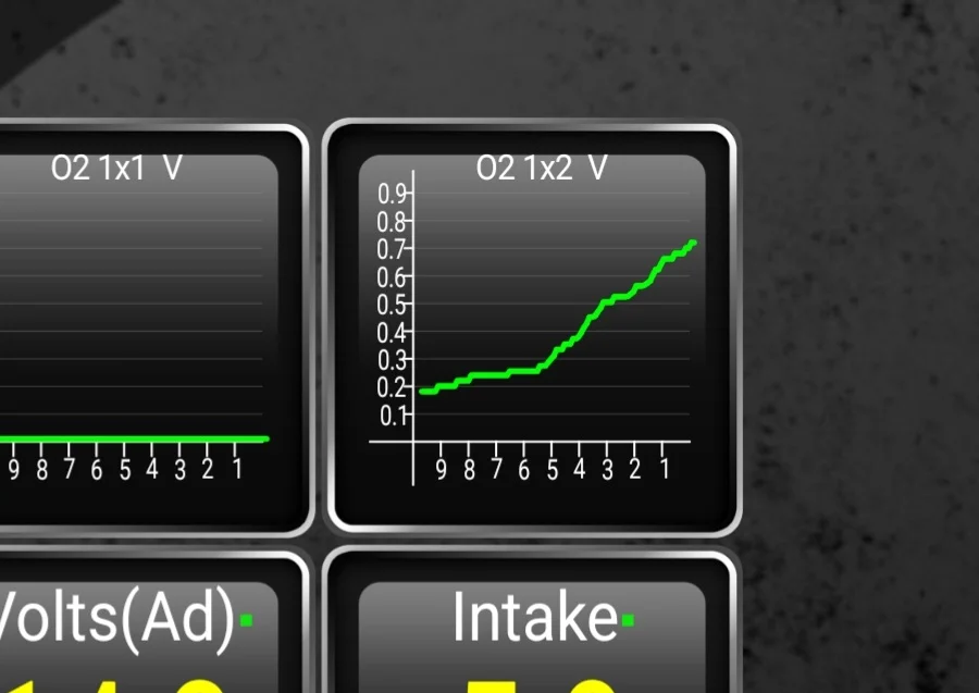

Here are some more sporadic readings of the Sensor 2 at idle.
Found this while researching 02 sensor readings...
" The post-cat exhaust gas mixture should be CONSTANTLY low in oxygen if the cat is doing its job of burning excess fuel. Therefore, the post-cat O2 sensor signal should be a constant lower voltage reading (not oscillating). So, if the post-cat O2 sensor is seen to oscillate just like the pre-cat O2 sensor, that means that the post-cat sensor is seeing the same gas mixture as the pre-cat sensor meaning that the catalytic converter isn't doing its job of burning excess fuel. The computer monitors the post-cat sensor and compares it to the pre-cat sensor. If the signals are similar, it assumes the cat is bad."
The readings I am getting appear to be oscillating and more. Interesting note--we received a recall notice in the mail for this jeep regarding catalyst efficiency. I wonder if that is what I am experiencing

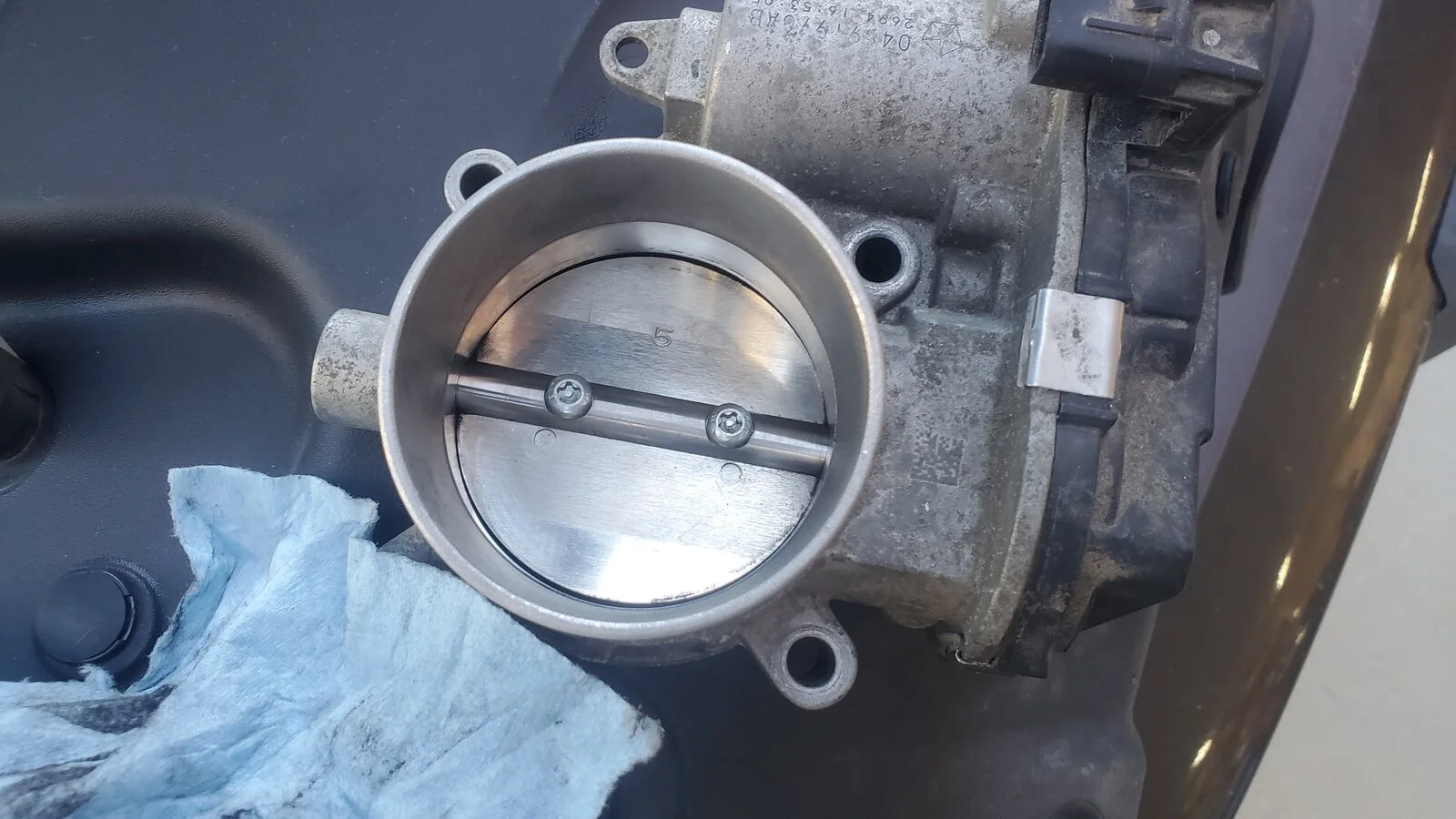

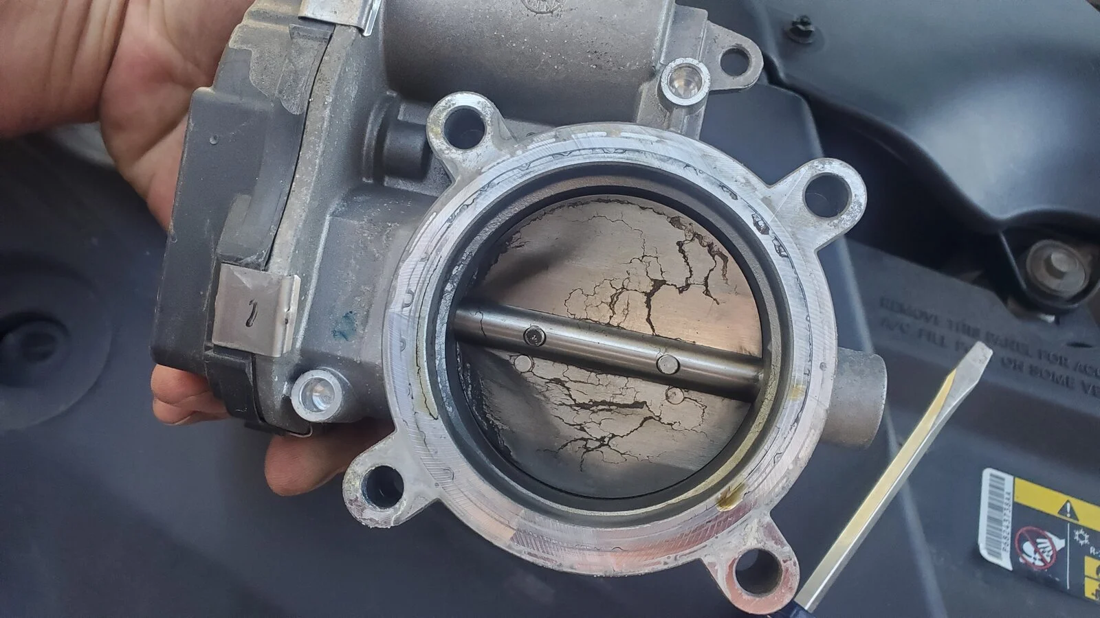

Cleaned the throttle body again, not bad, not great.

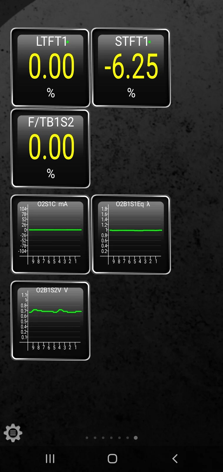

Fuel trims.
