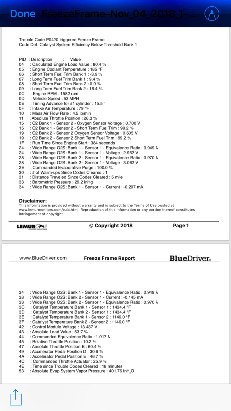

here's the freeze frame. Cat temps look fine. Is it the fuel? the short term fuel is the only difference i see from this.
