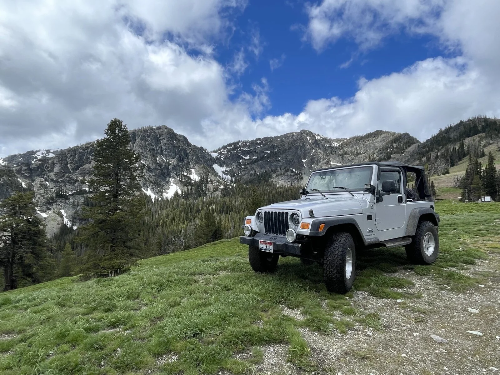

I have a 2" budget boost and was looking for 32" tires as well. After a lot of looking I ended up ordering the 16 x 8 Moab replicas from Quadratec and LT265 75R16 Goodyear Duratracs. I'm very happy with them so far, they have excellent traction, aren't too loud on the highway and the wheels from Quadratec have 5" of backspacing so there is no rubbing when turning lock to lock or flexed out.
Edit: I wanted 32" tires because going up to 33" added significant weight and was going to cause clearance issues.
