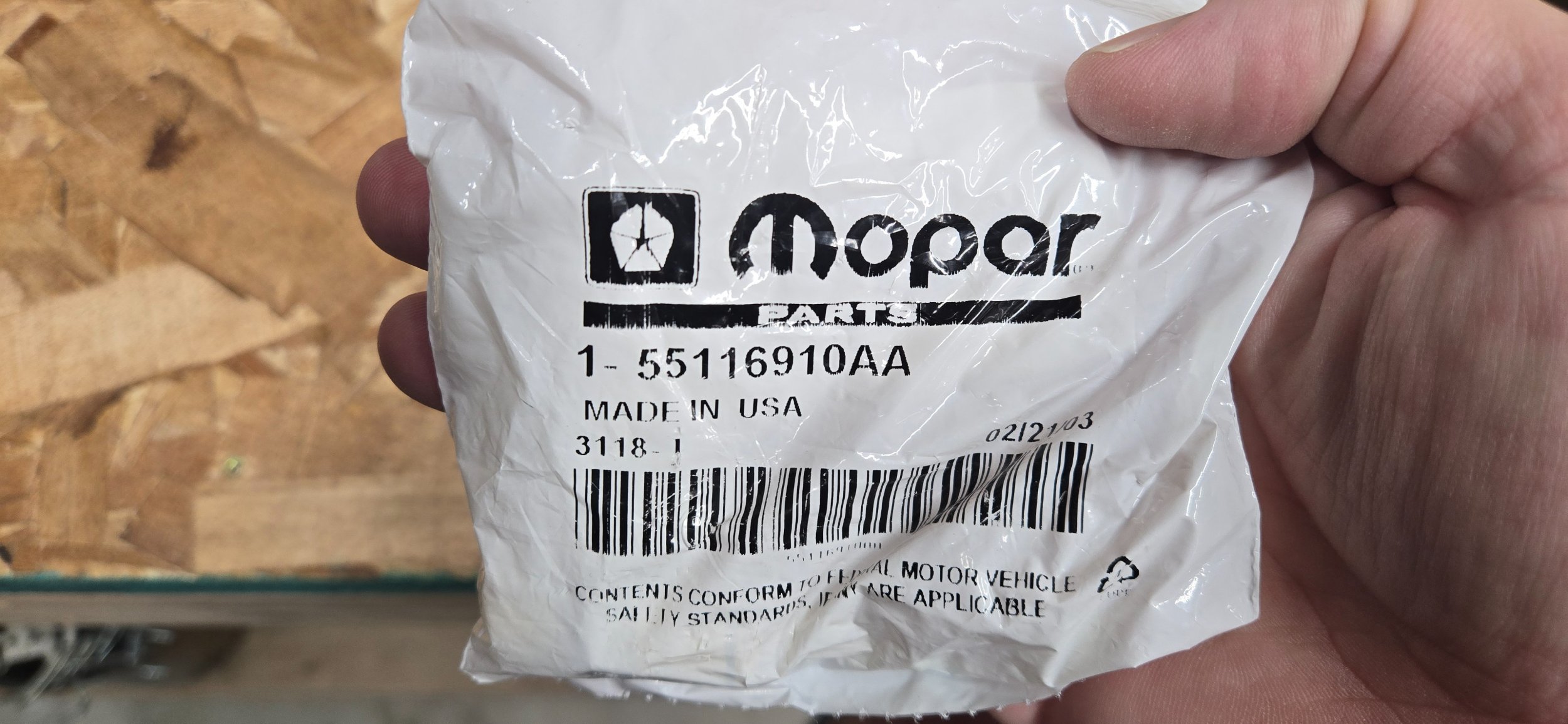

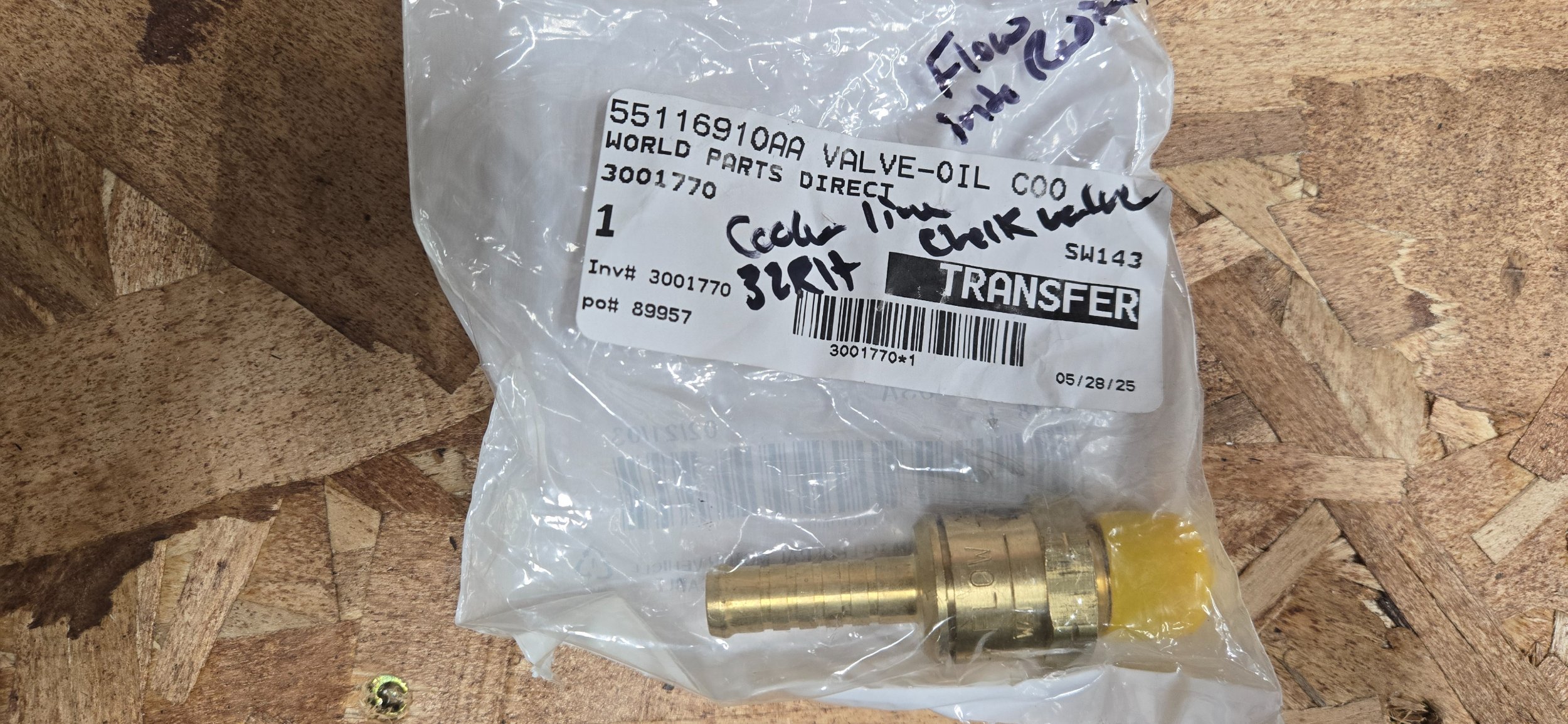

I remember reading at one point that the 32 has a check valve somewhere in the cooler line circuit. I had a crimped line and a hole on the TJ when I bought it, so I replaced the lines with rubber hose. I get a bit of delay when shifting to reverse, especially after it sits for a while. I was reading that this could be due to a lack of a check valve and the fluid draining out of the lines when sitting. Does anyone know where the valve is located stock, and what kind of valve it is? I was hoping to simply add an inline valve somewhere if at all possible.
Goes between the radiator and transmission where the hardline meets the rubber hose.
