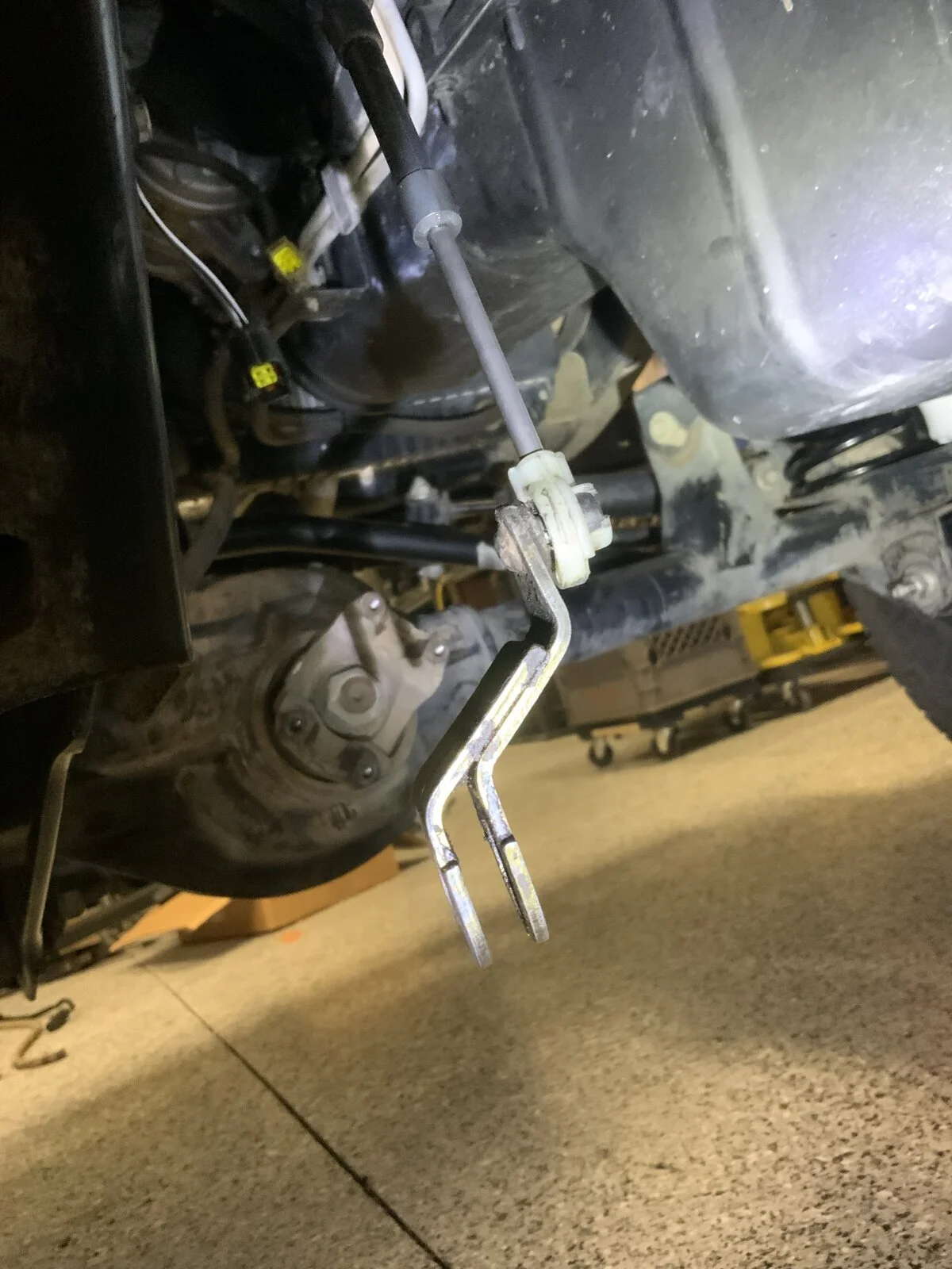

Apparently my “Google-fu” is lacking. I am replacing the 32rh trans in my 01 and am a little nervous on just prying the cable ends off the trans levers.
is there some trick or is the Ford Method (brute force 😂) the way to go? I really don’t want to end up rep the whole cable (actually both shifter and TV).

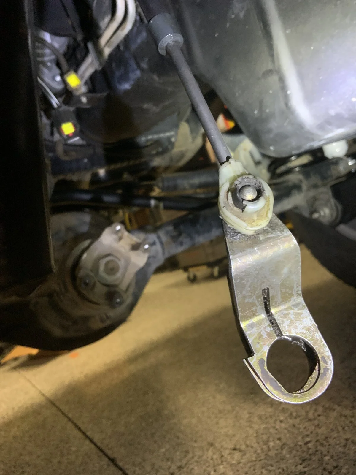

Sorry, no, the attachment to the trans for the shift cable only.
I looked again at the trans side of the TV cable and figured that one out 🤦‍♂️

for those needing an answer to the primary question, simply take two screwdrivers or other suitable pry tools and pry the cable end at 180 degrees from each other and pop the end off the bracket. Doh!
i read somewhere in the recent past similar instructions that led me to understand one needed to pry the cable end apart to slide up and off the bracket. So I allowed myself to be misdirected.
