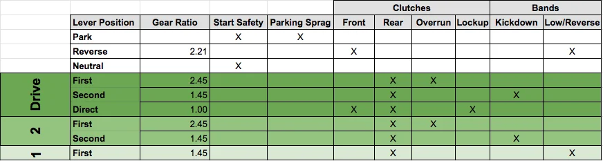

The overrun clutch is not used in M1, so if you don't have any movement in M1 then something else is wrong. But if you have Reverse then the low/reverse band is ok, so a missing M1 places the problem elsewhere. I mean, M1 only uses the rear clutch so no M1 really points to the rear clutches.

In your excel sheet, is Direct meaning third gear?

Yes, direct is 3rd gear. Input & output are directly connected for a 1:1 in/out ratio. My first guess is that your TC isn't unlocking. Have you tried unplugging the TCC lockup and see if it still does the same thing?
