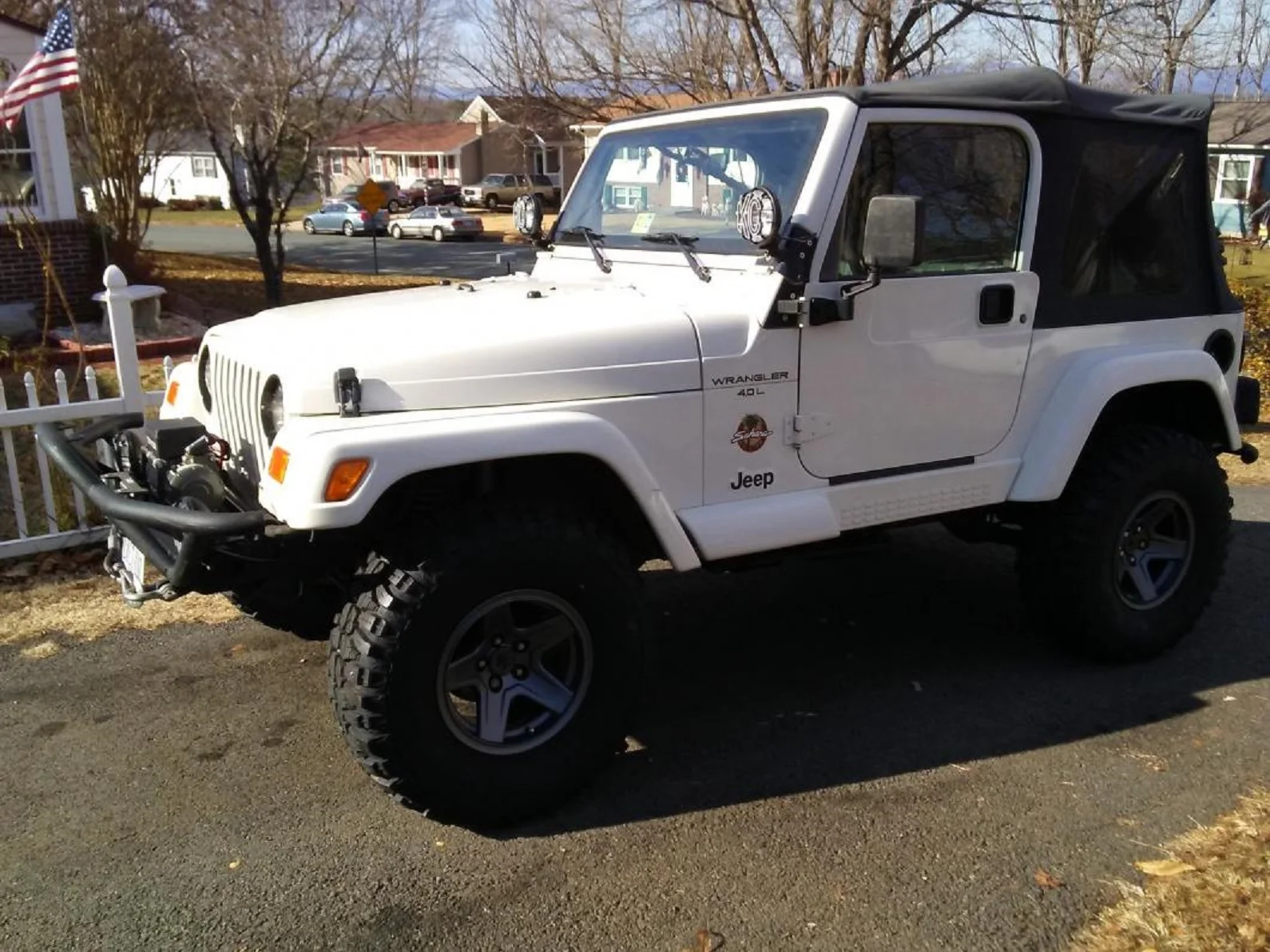

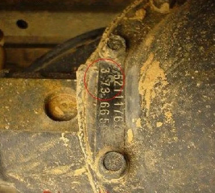

Do you have 3.07 or 3.73 gears? 3.73 is livable and 3.07 is not. I had 33s and 3.73 gears and could easily maintain 75 mph highway.
p.s. If you have a Dana 44 rear axle, you have 3.73.

Finally got off work and got to check. It's 3.73
