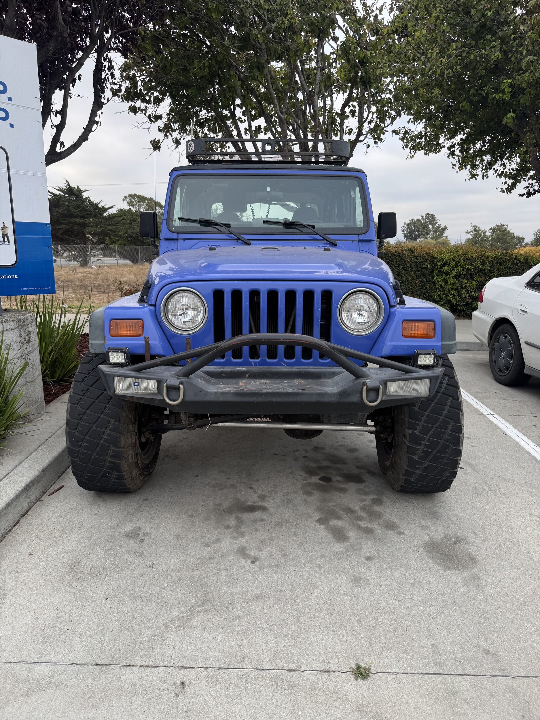

Pretty far outside. Slightly less than this.Will a 33x12.5x15 wide tire with a 4.0 backspacing rim be right at the edge of the fender ? Or will it be out side it?

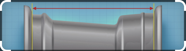

Hi I'm new to these forms. How do I measure my rim size? I'm running 33x10.5x15. Just trying to figure out my rim size...15x7 for example. Do I need to remove the tire from the rim to measure?
Can you post a picture of your rims? If they are oem we'll know what the width is.
With a tape measure through the holes and a couple straight edges to reference the outer lips.
Ahh that might work! I just need the measurement from edge to edge?
Then subtract the thickness of the rim at the beads (both sides), since you're wanting the inside measurement. It's not like you need a precise measurement you're just trying to get to the nearest inch.
