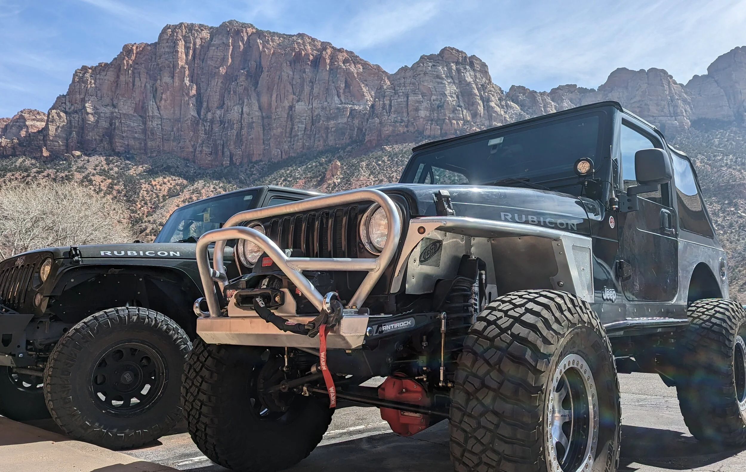

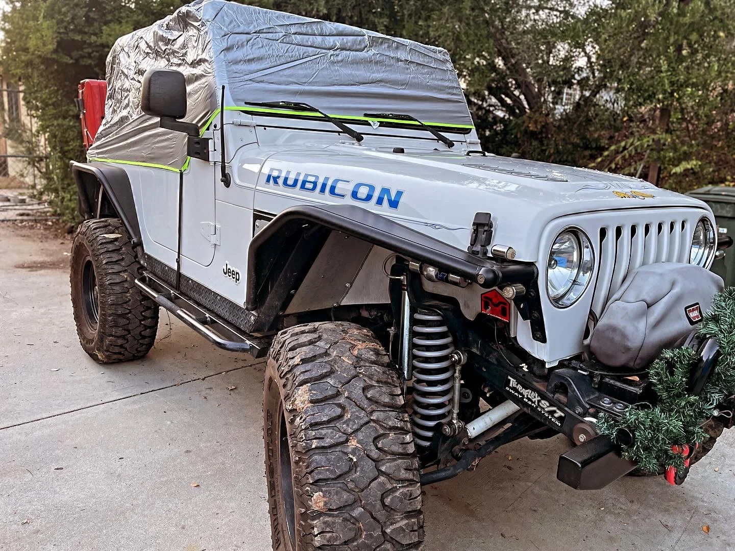

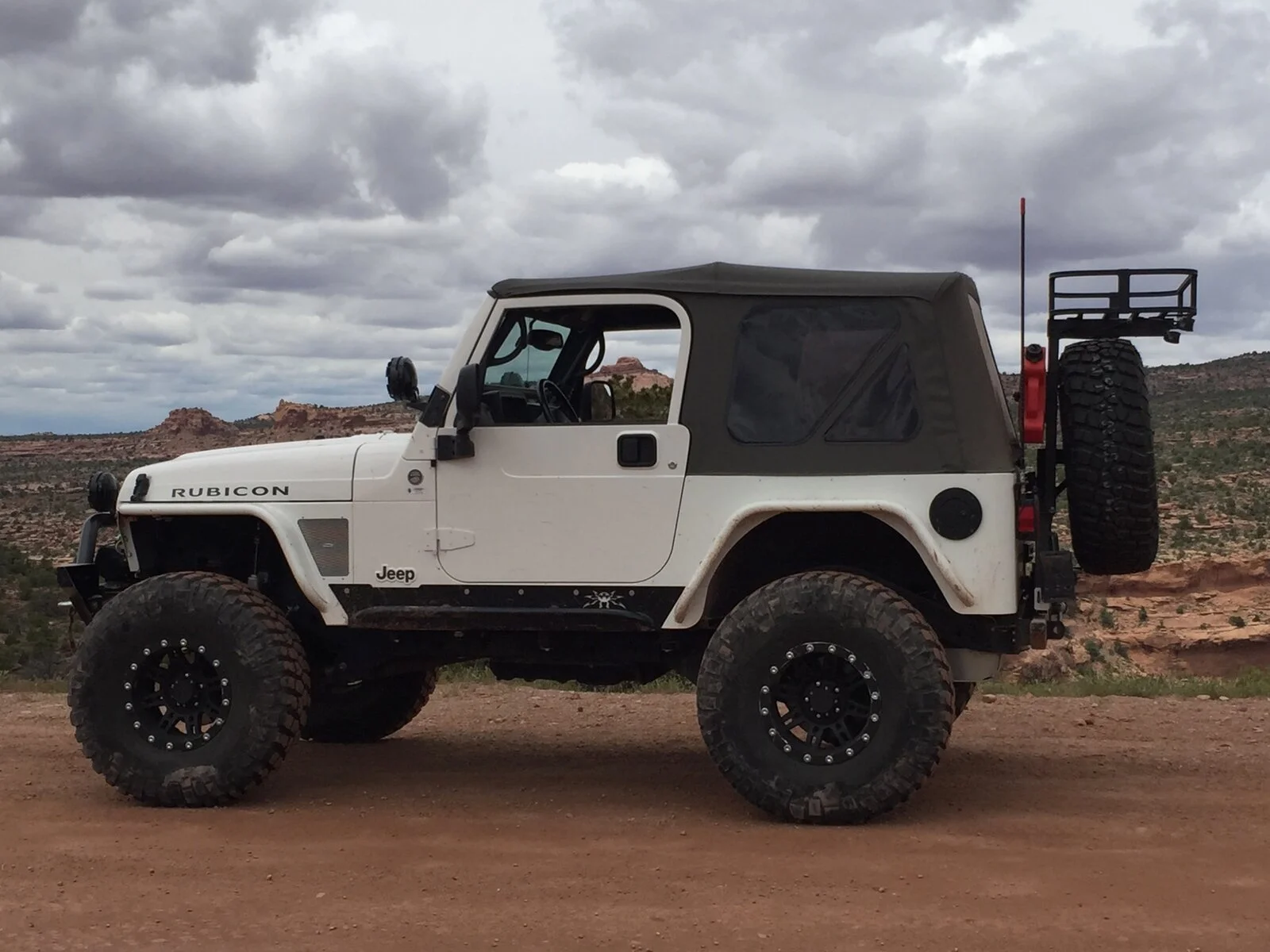

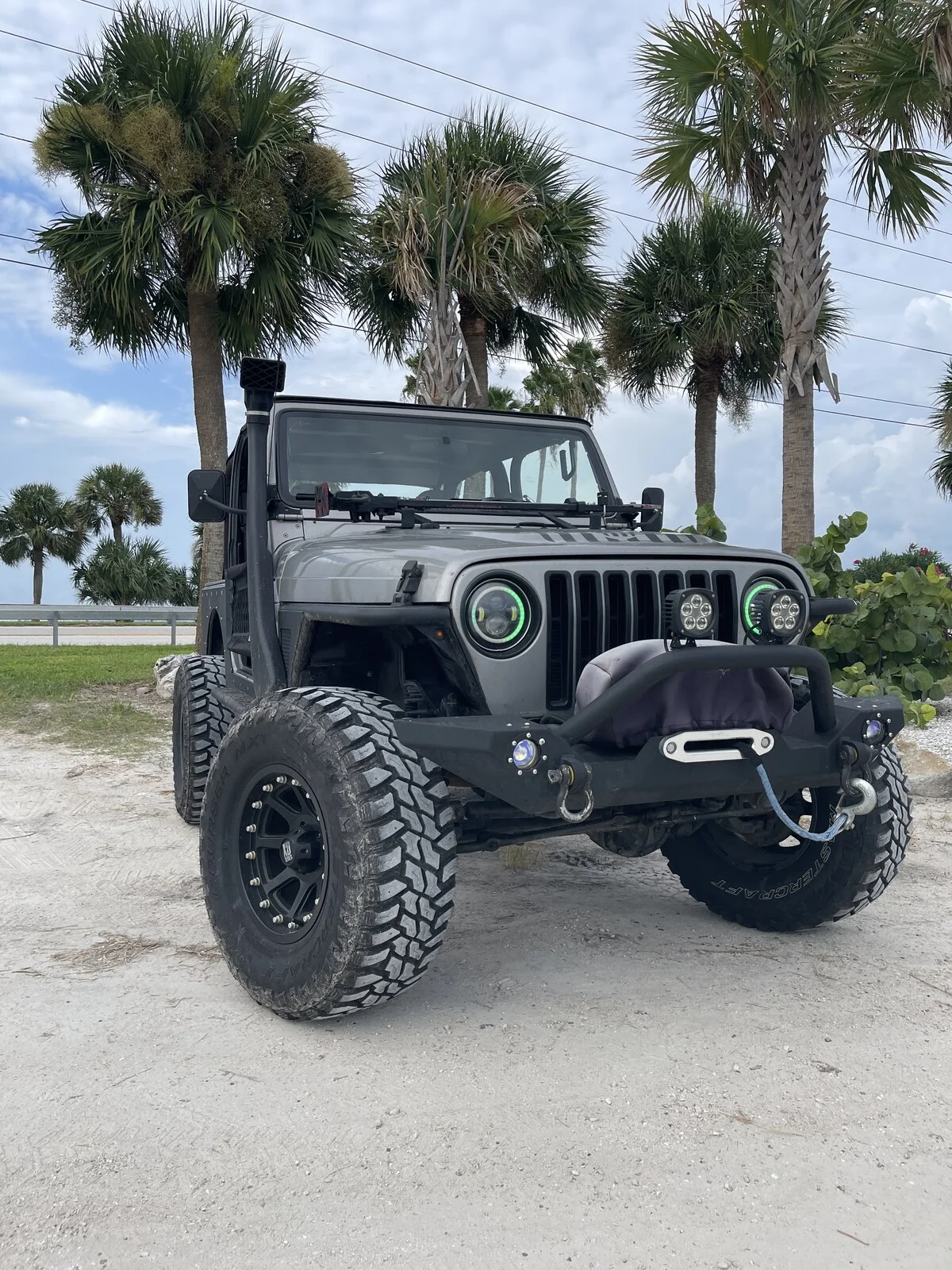

This is 4 inches pure suspension lift with mostly flat flares on 35’s. Not sure if it helps, but maybe it’ll give you some room for thought
Reactions: ARawls88

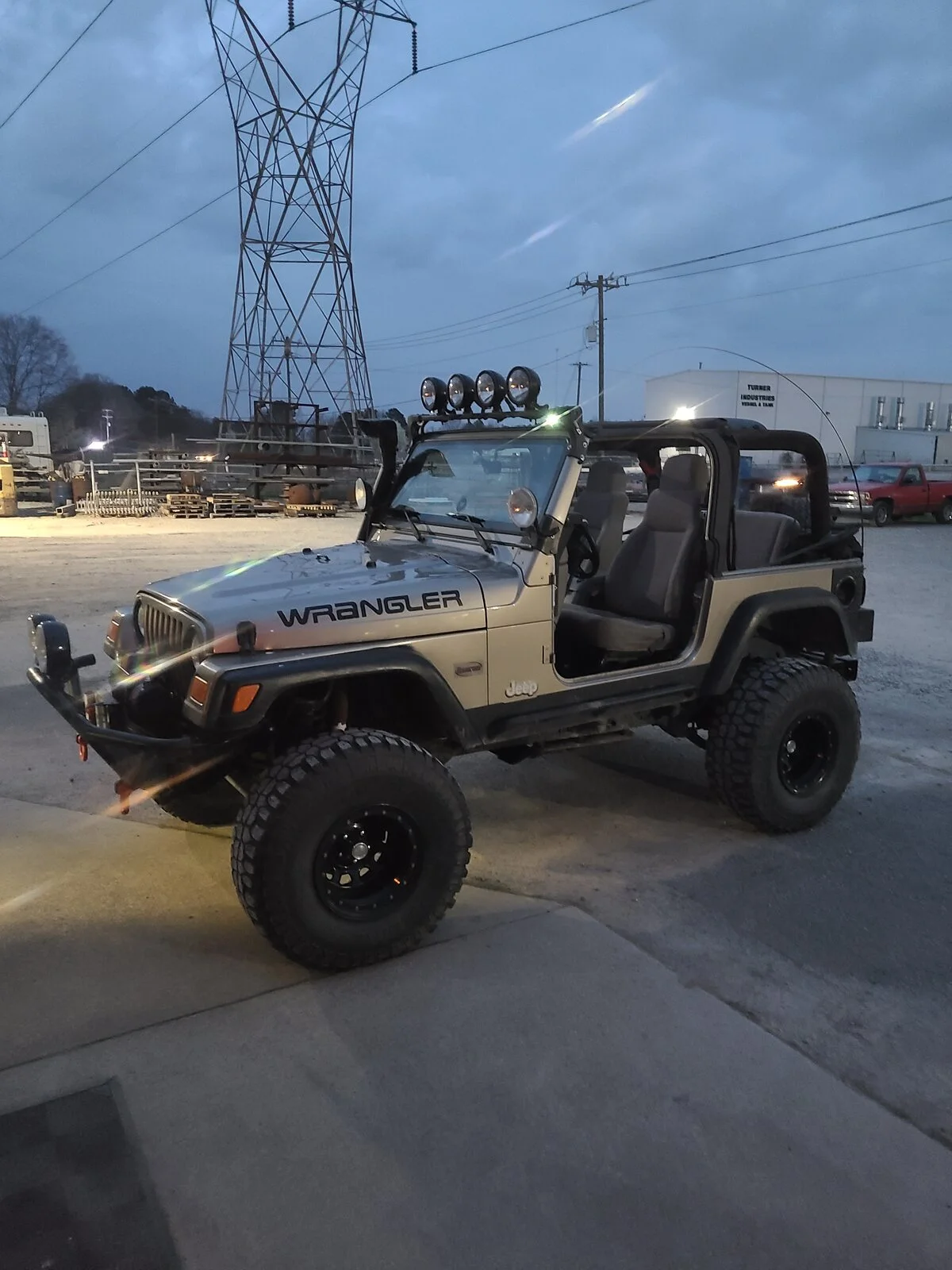

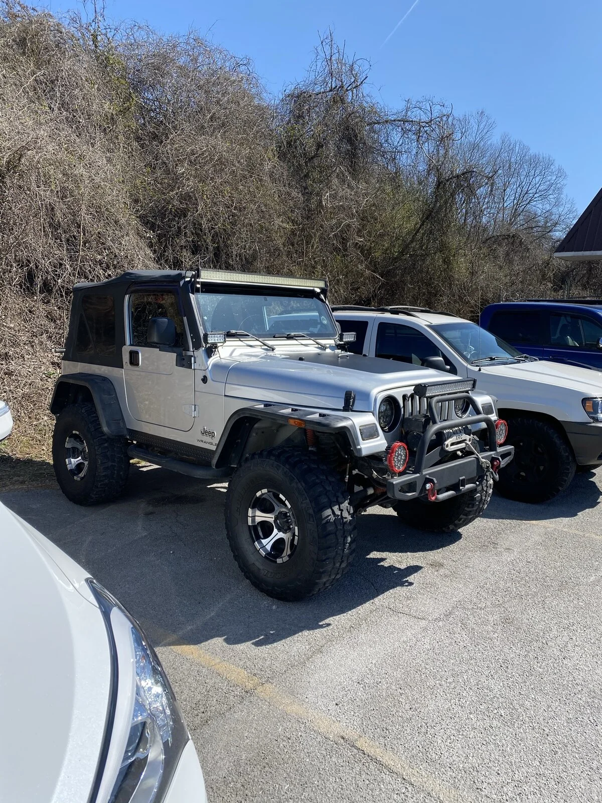

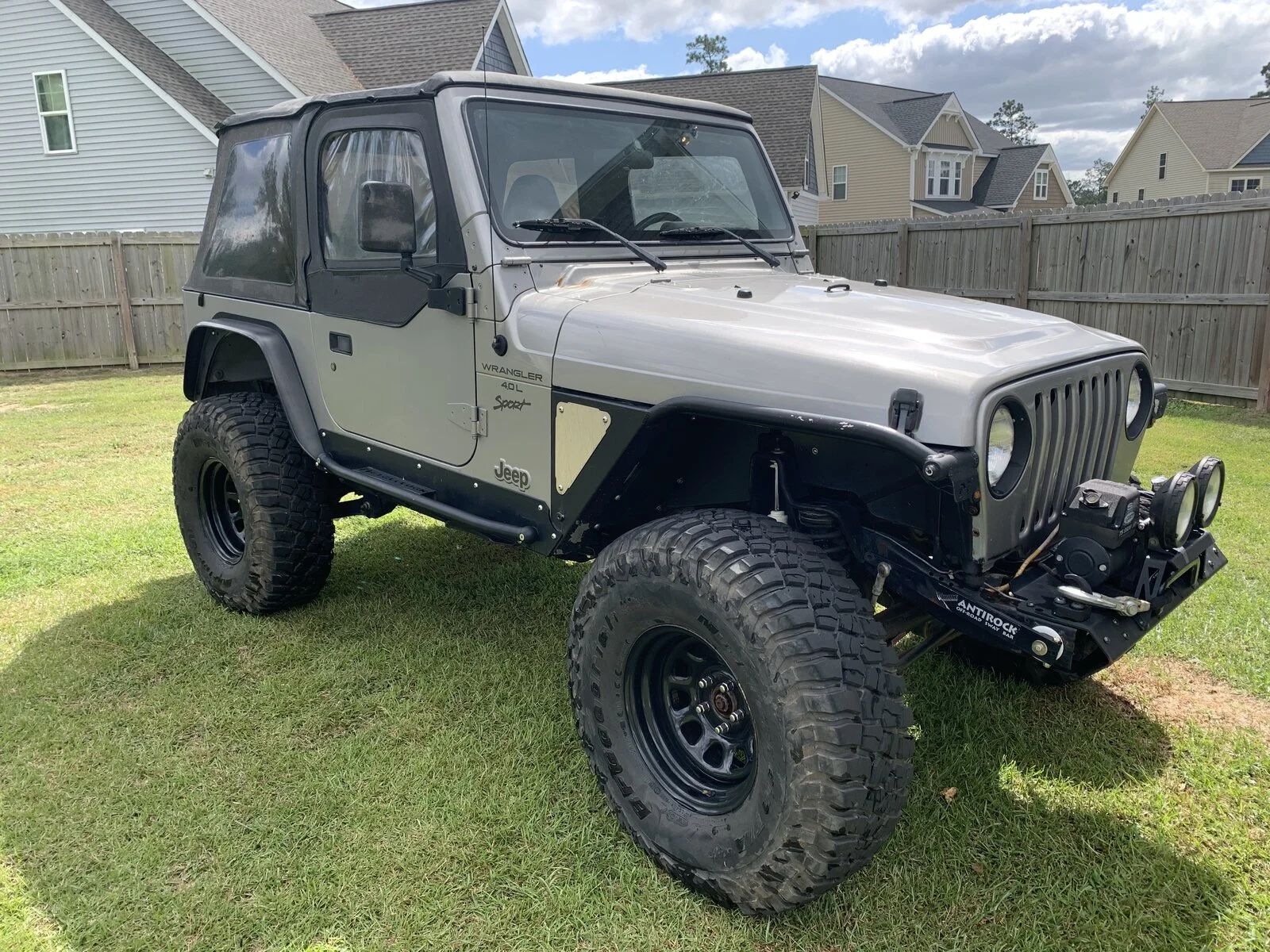

4" lift and 1" BL and Genright Alum Fenders and Corners and 35's
I also have a 4 in lift and I want to purchase GenRight fenders front and rear. I see that you have the standard, not highlines, would you purchase standard or highlines if you had the chance now? That is if you stay on 35s. Is there any rub at full flex? Any opinion would be appreciated.
The highlines require cutting the hood which I did not want to do. I do not have any rubbing, but I also have a 1" BL. Also I went all Alum. fenders and corners as he steel ones weight a LOT. I have been very happy with the quality of the Genright Products

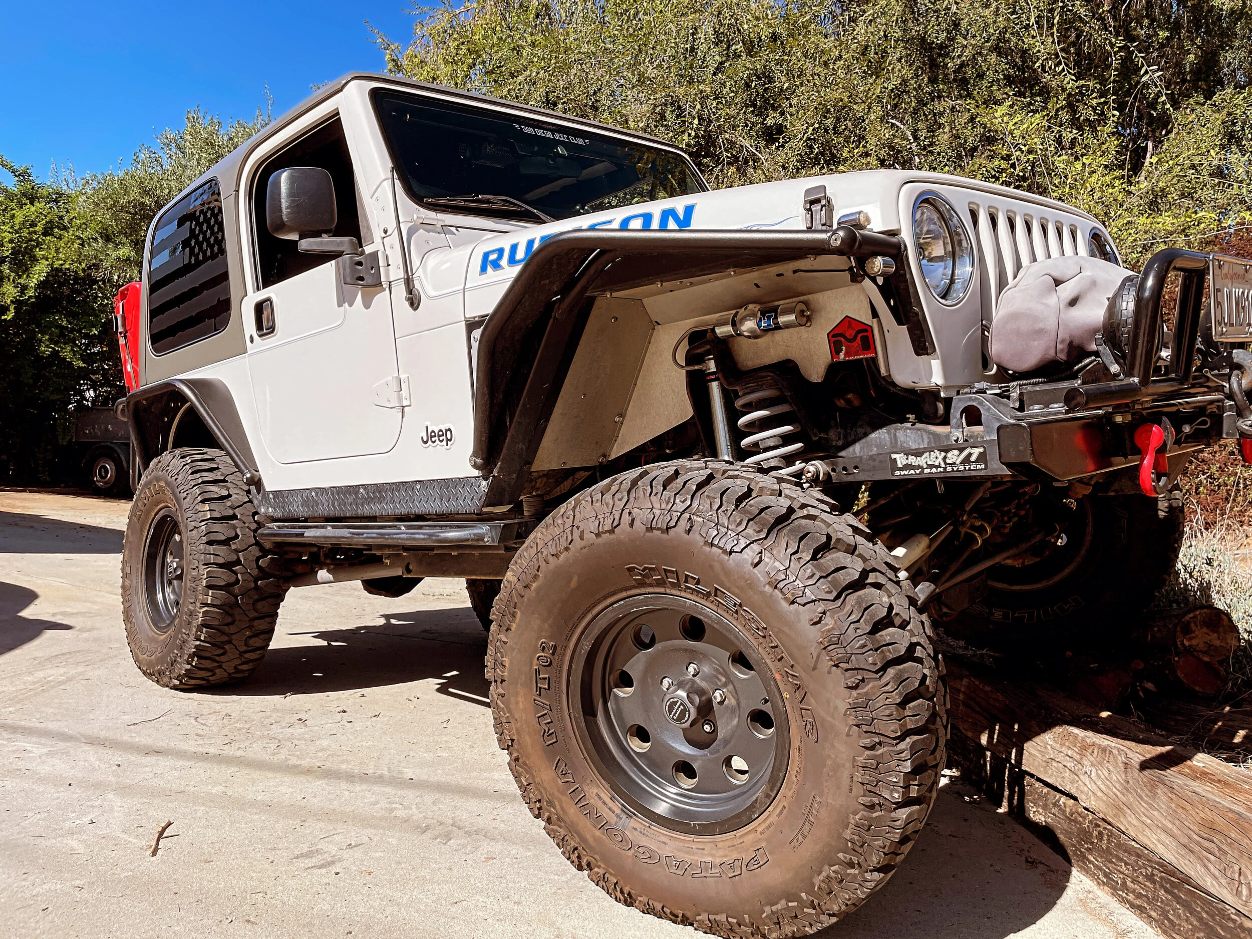

I have standard fenders from GR as well. They were fine w/ 35's, now i rub w/ 37's. I really wish I would have bought highlines the first time thru.

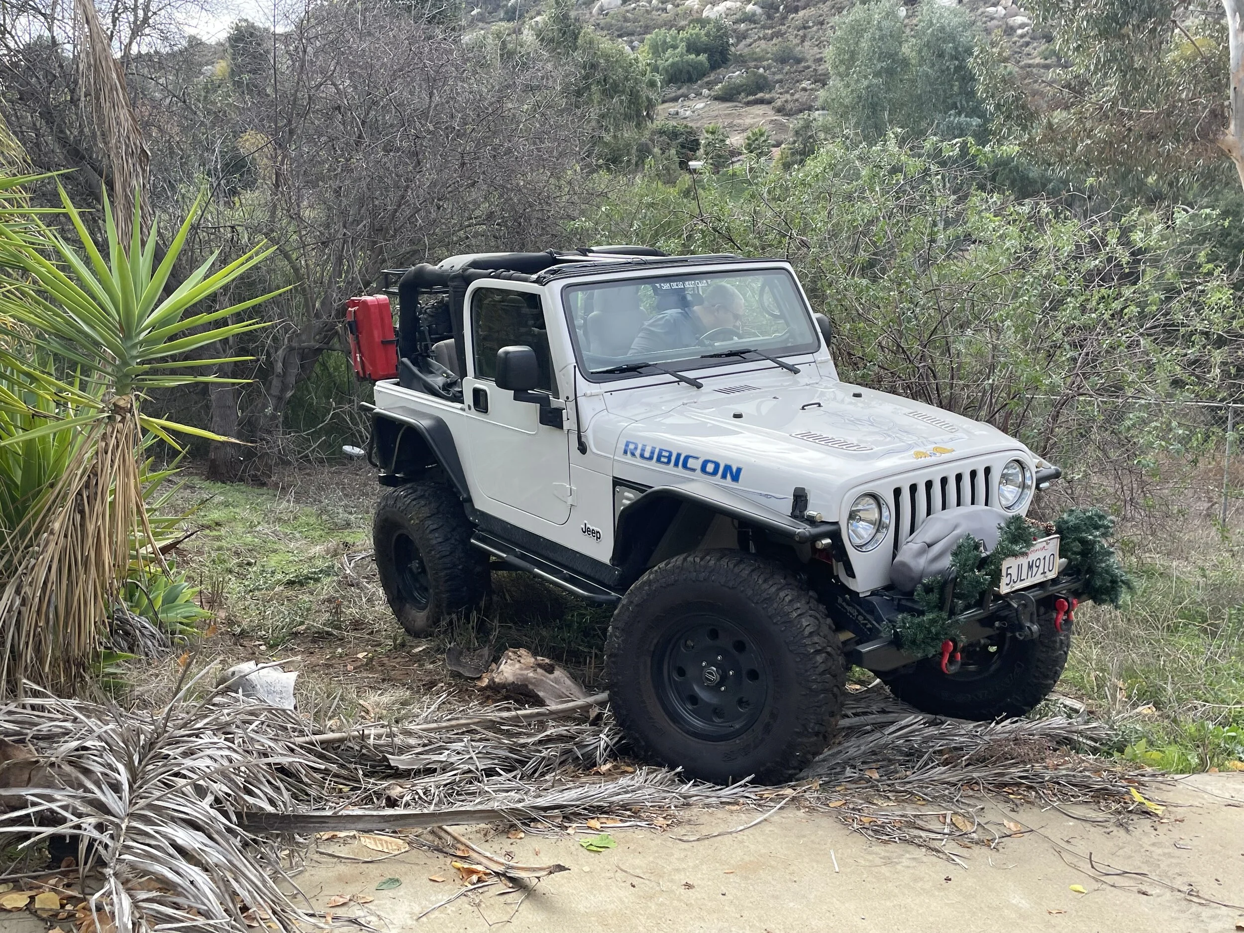

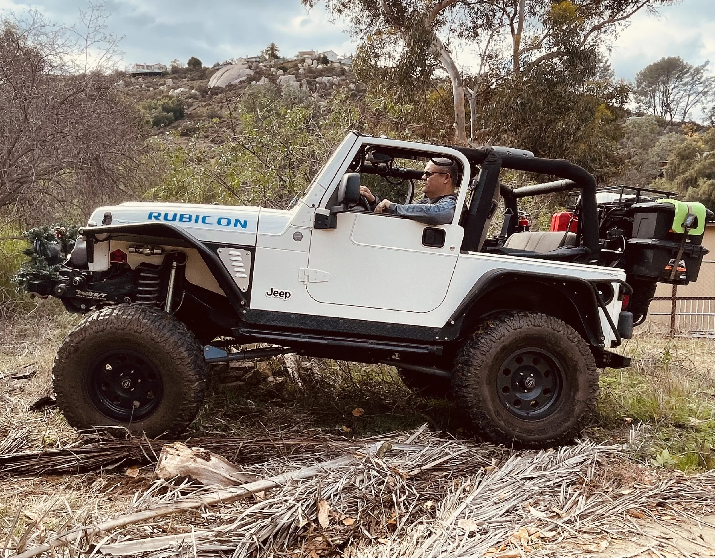

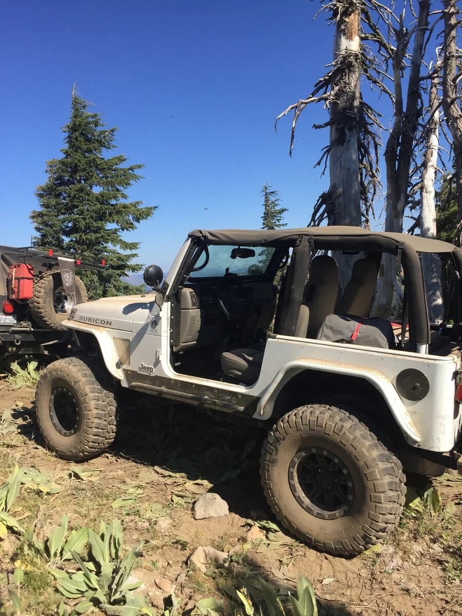

Metalcloaks, 4” susp, 1-1.25” body lift, 35” Patagonia’s
