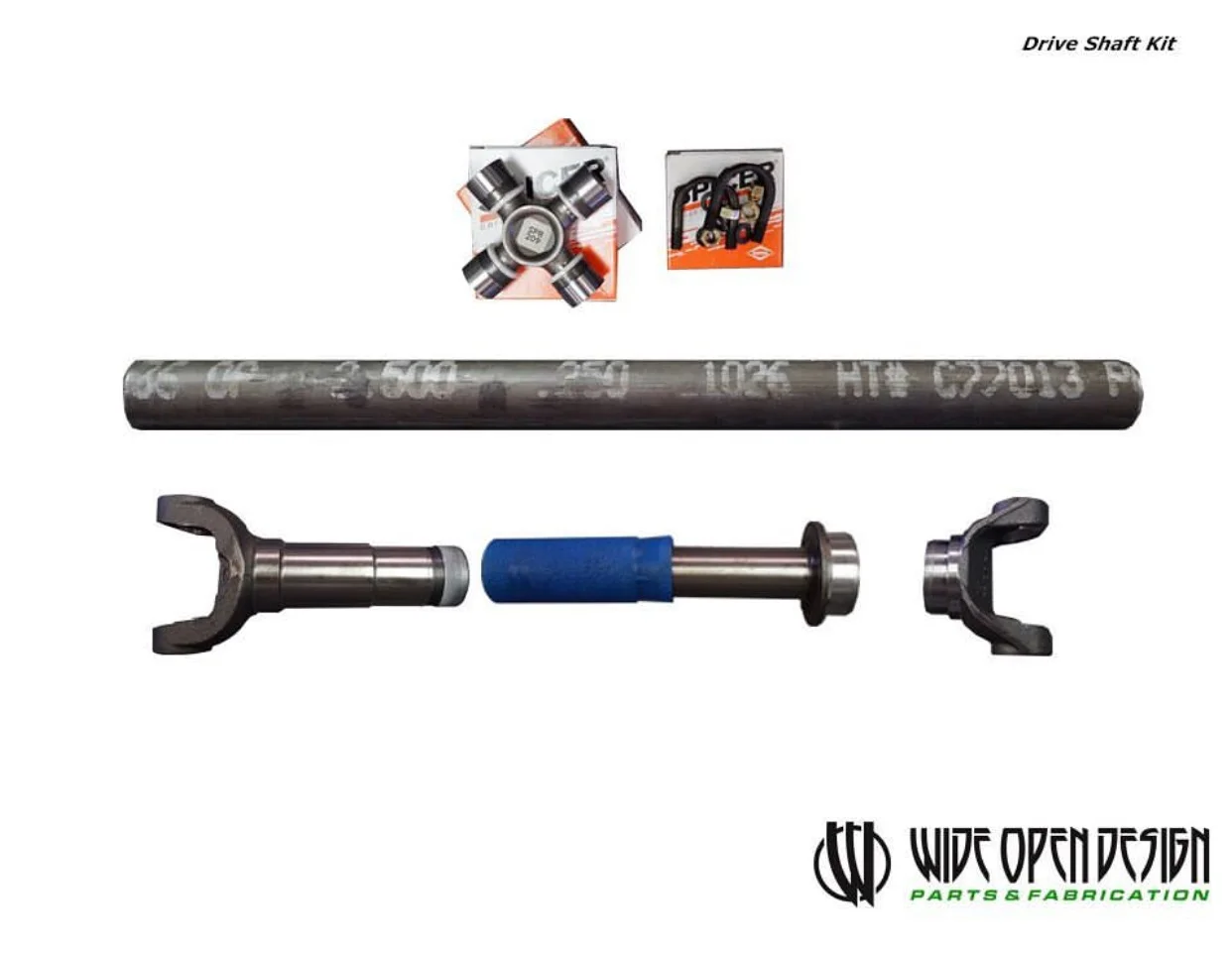

Too easy. Make your own. Some say, “if you want it done right, do it yourself.”
Obviously you can use this to build a custom dc slip yoke shaft yourself. It may require some work. But I think if you're swapping an engine this should be easy.
