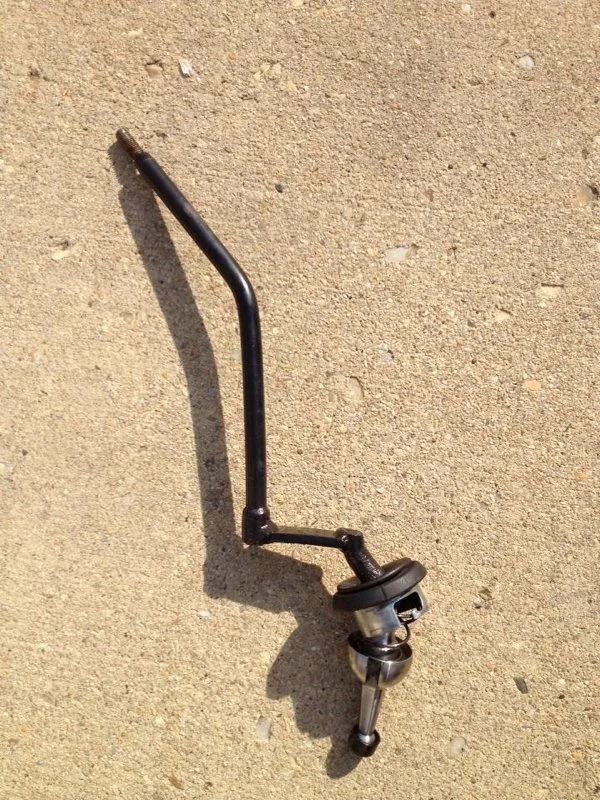

For the shifter they did something like this. You're moving the transmission forward approx 6"
