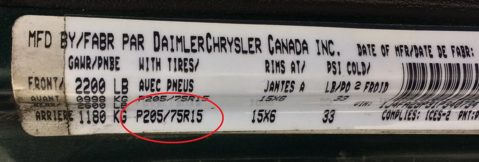

My Trailrunner 225/75R15's spec out at 28.3" tall and 27lbs of weight. I switch to Destination LE2 215/75R15's for the winter at 27.68" and 25lbs of weight. Even the difference between these two is very noticable.
The factory spec tire for a 4-banger is actually 205/75R15 which are 27" tall. The 4 cyl is quite capable when shod with the correct tires that the Chrysler engineers specify.
Believe it or not, they even make All-terrain tires in that size.
https://simpletire.com/firestone-p205-75r15-026495-tires
So if you want to modify your ride, get the 6! But if your happy with the stock stance and stock sized rubber, the 4 cyl is quite capable. If it's a dog, there's something wrong with it!
