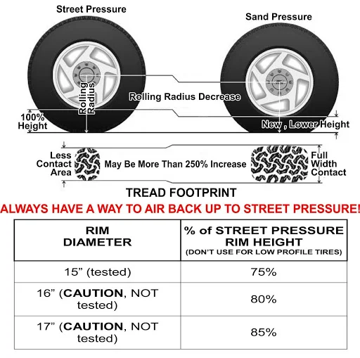

I received an email today from Coyote Enterprises that Harry Llewellyn will be reprinting many of his articles from his many years leading offroad expeditions and teaching people the ins and outs of offroading at Southern California community colleges. This is very good news
This month's installment of "Ask the Professor" answers the question, "I’m planning a 4WD trip where there’s lots of sand. What do I do if I get stuck?"
Of particular note is the opening line of Harry's answer, which provides a starting point for determining what air pressure to run in sand:
" What I have learned through conducting more than 1.5 million injury free passenger miles worth of off-road tours is that anything above 12 PSI will get you more vertical (undesirable) than horizontal (desired) travel in tough sand."
Here is the rest, which is a simple yet ingenious method for determining the best sand air pressure for your rig and your tires:
"Determine how this information works for you at home in the safety of your driveway. Also note that I have only extensively tested the above for 15 inch rims. Past tours and participants have had success using the percentages shown for 16 and 17 inch rims.
The procedure is to let the air out of your tires until you are at lower, rim-percentage height. Then measure your new sand tire pressure."
https://www.coyoteents.com/ask-the-professor/
