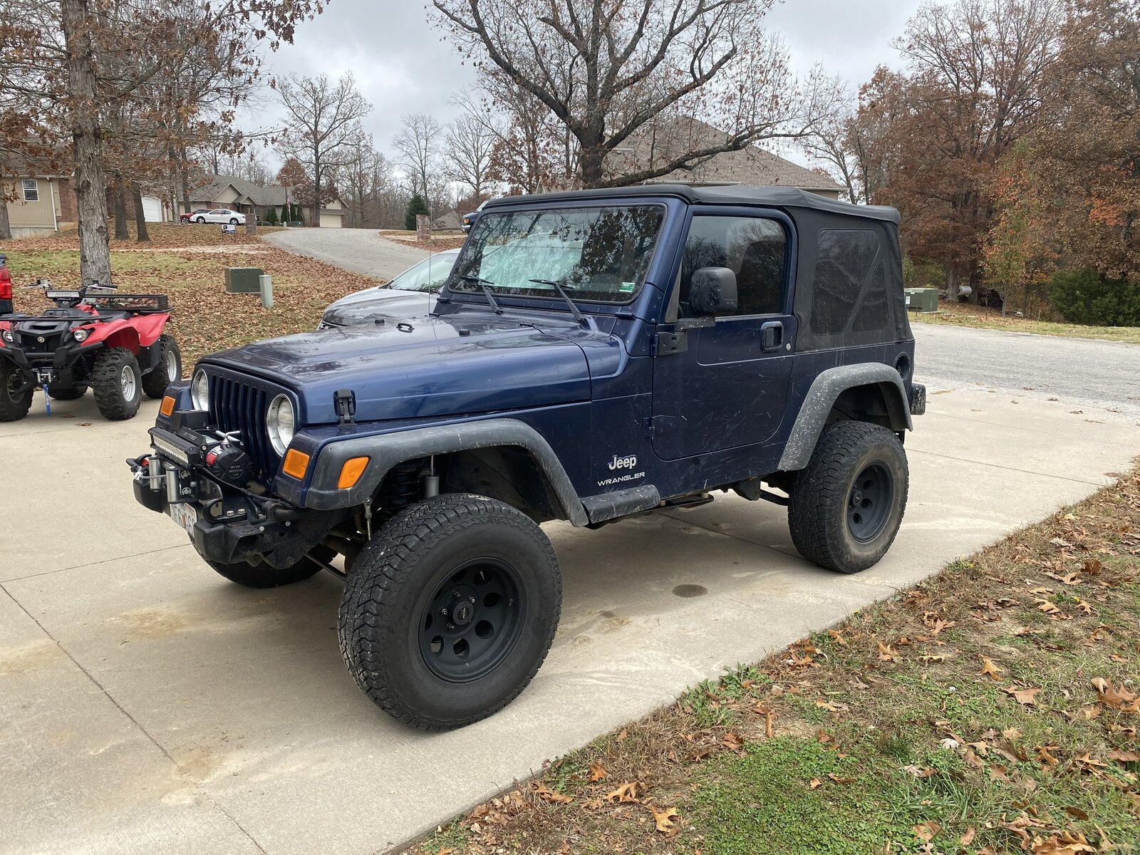

the photo of jeep running 31s and 4" lift that i like:
would also like to say my intentions for the jeep are mostly on road performance with offroad as secondary

the photo of jeep running 31s and 4" lift that i like:View attachment 660795
If you are stuck on a 4" lift, look at the Zone combo lift, it gives you a total of 4.5" and comes with everything you need. And you don't have to do the SYE.
@TheBoogieman runs them just fine.
