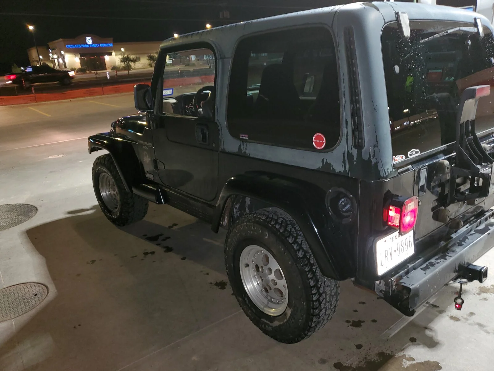

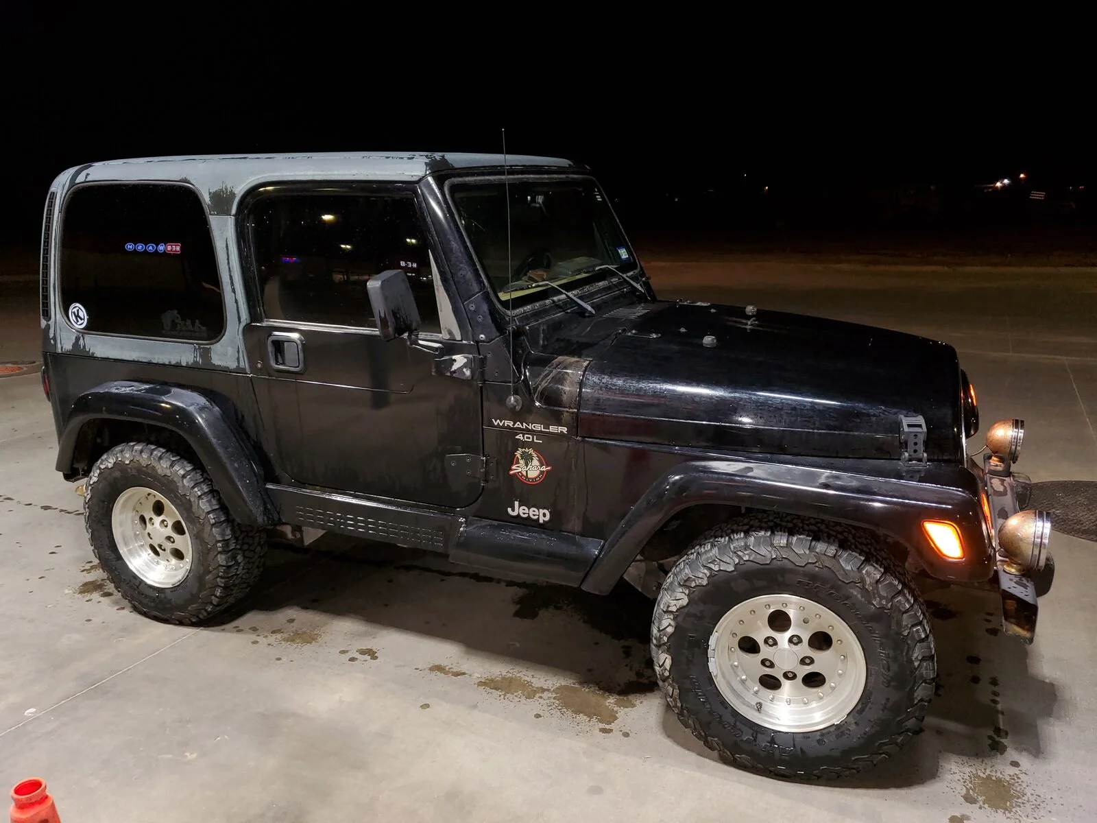

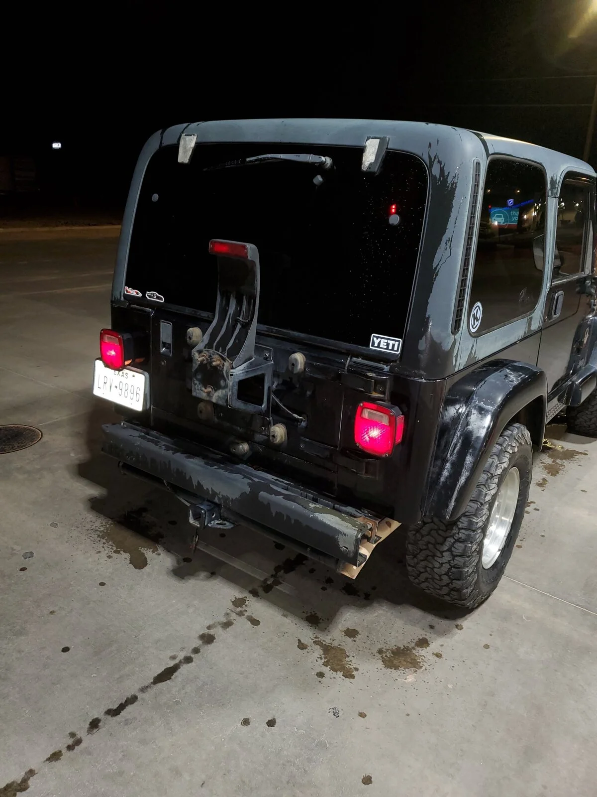

Pics of jeep when i picked her up amd ran her thru a carwash. Still pretty filthy but i need some motivation to keep progressing

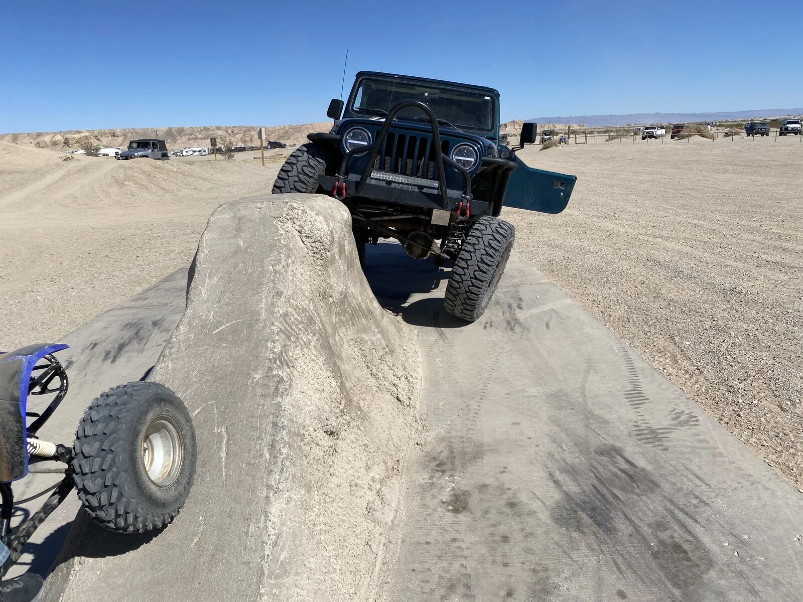

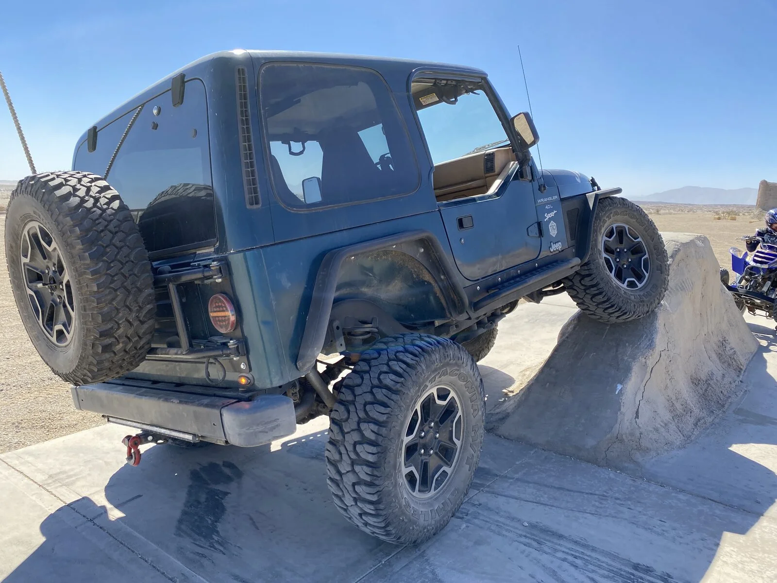

I’ve used the zone 4” lift that come with lower arms and I run 35s. It flexes just fine and I’ve ran it pretty hard in the rocks and in the desert.
Perfect? No, not by a long shot but it’s good enough for now

It’s a flex test. Have you never taken a picture of your Jeep?
