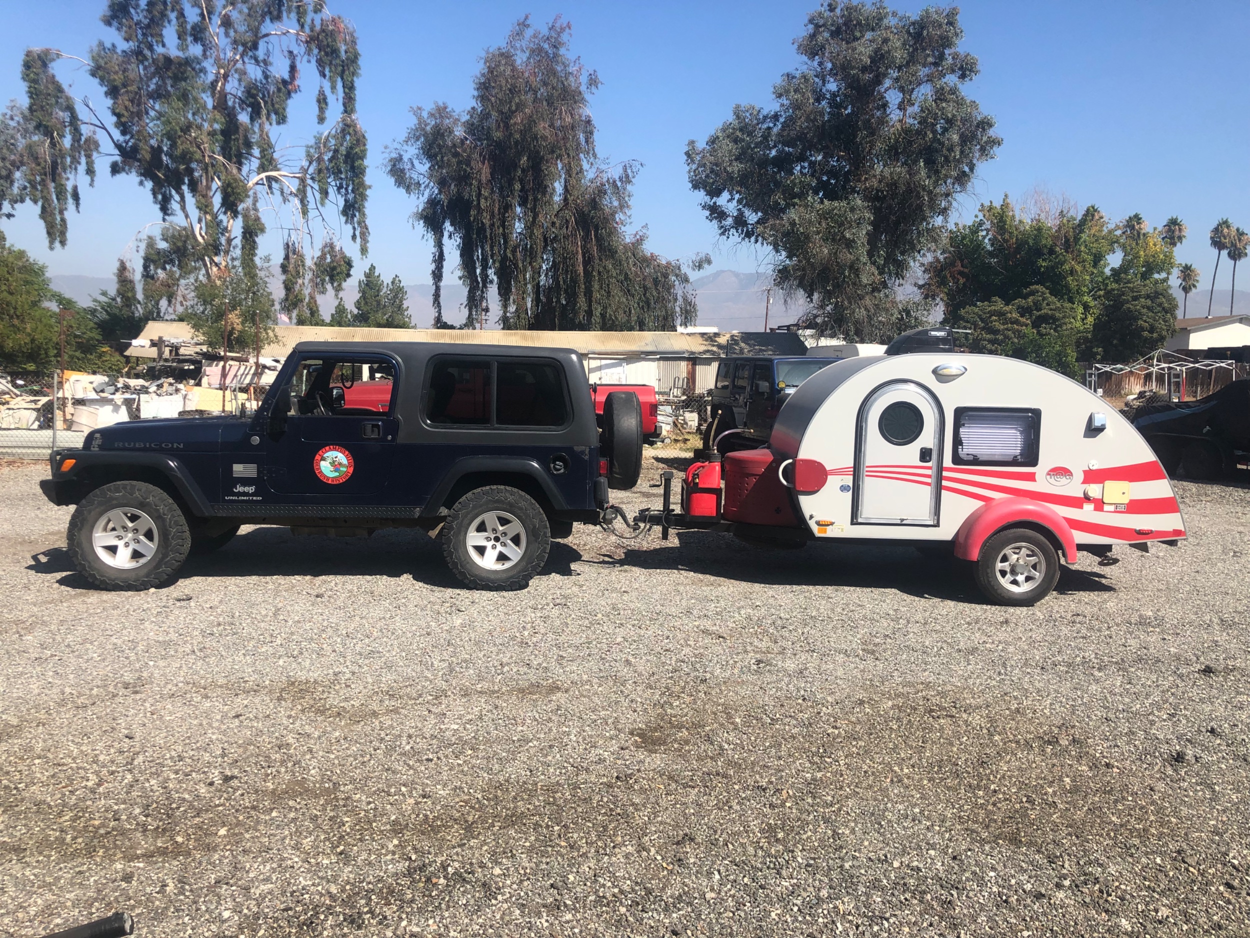

My 05 TJRU has the OME 2.5” lift. PO did it so I don’t know the spring rate. Picture shows my rig with 300-400 #s of gear in the back plus 1200# teardrop. Handles great on the highway but I can tell the difference with the sway bar disconnected on the highway. I’ve done some pretty gnarly trails with zero issues. I run 32s.
