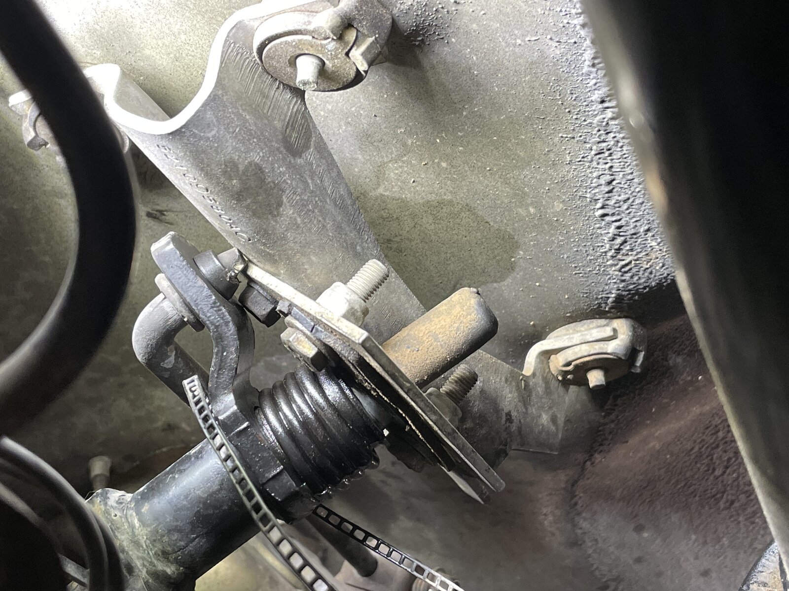

So, after removing a 1” t-case drop I couldn’t shift into 4 low. I used the adjustment bolt 13mm on the linkage arm and now seems to travel further and engage. Only problem is there is significant contact between a pivot point on the linkage and one of the bolts/mounting brackets. It takes quite a bit of effort to get it into 4lo and out of because of this. I snapped a picture and hoping someone could let me know what they think (it’s fine, adjust x, you’re a moron, etc.)

Remove that drop plate and put the rod back into its stock position to fix the rubbing then make adjustments.

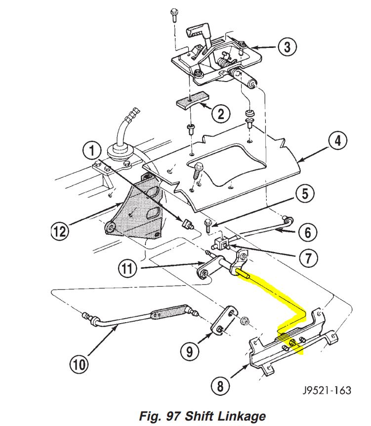

Is that plate an aftermarket drop plate????
Yes.
Remove the plate and you will see where the torque shaft (#11) fits into the torque shaft bracket (#8)
There is a small bushing plate that the torque shaft runs through that is attached to the drop plate. It will need to be bolted back onto the torque shaft bracket
This will solve your alignment issues.

Thank you. After spending a lot of time scrolling between my photo and the diagram you provided, I think I understand. Will there be play in the torque shaft to get it seated in the proper location, or will I need to disconnect anything else? Its a tight area, so I'm thinking Ill have to drop the skid.
