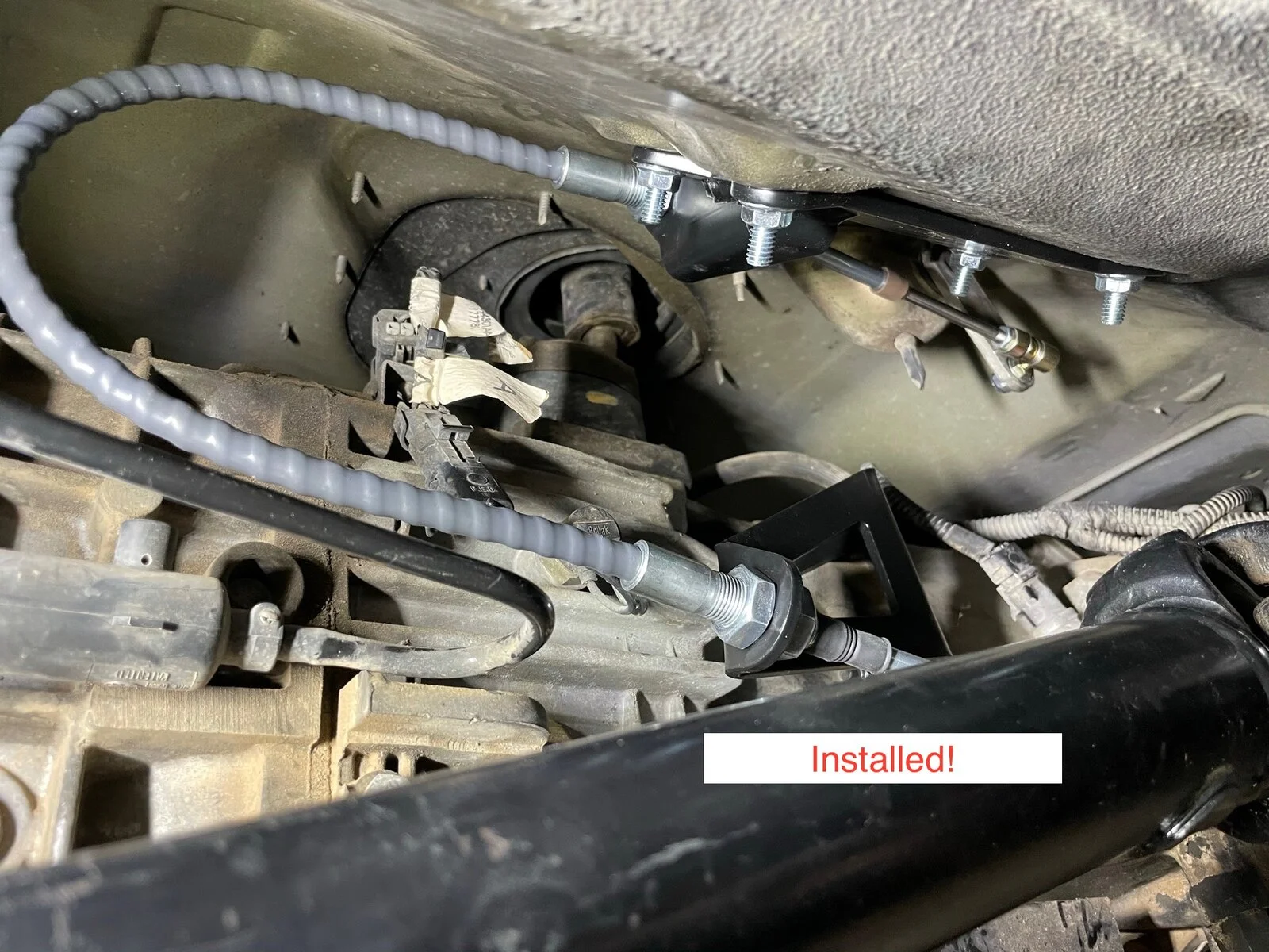

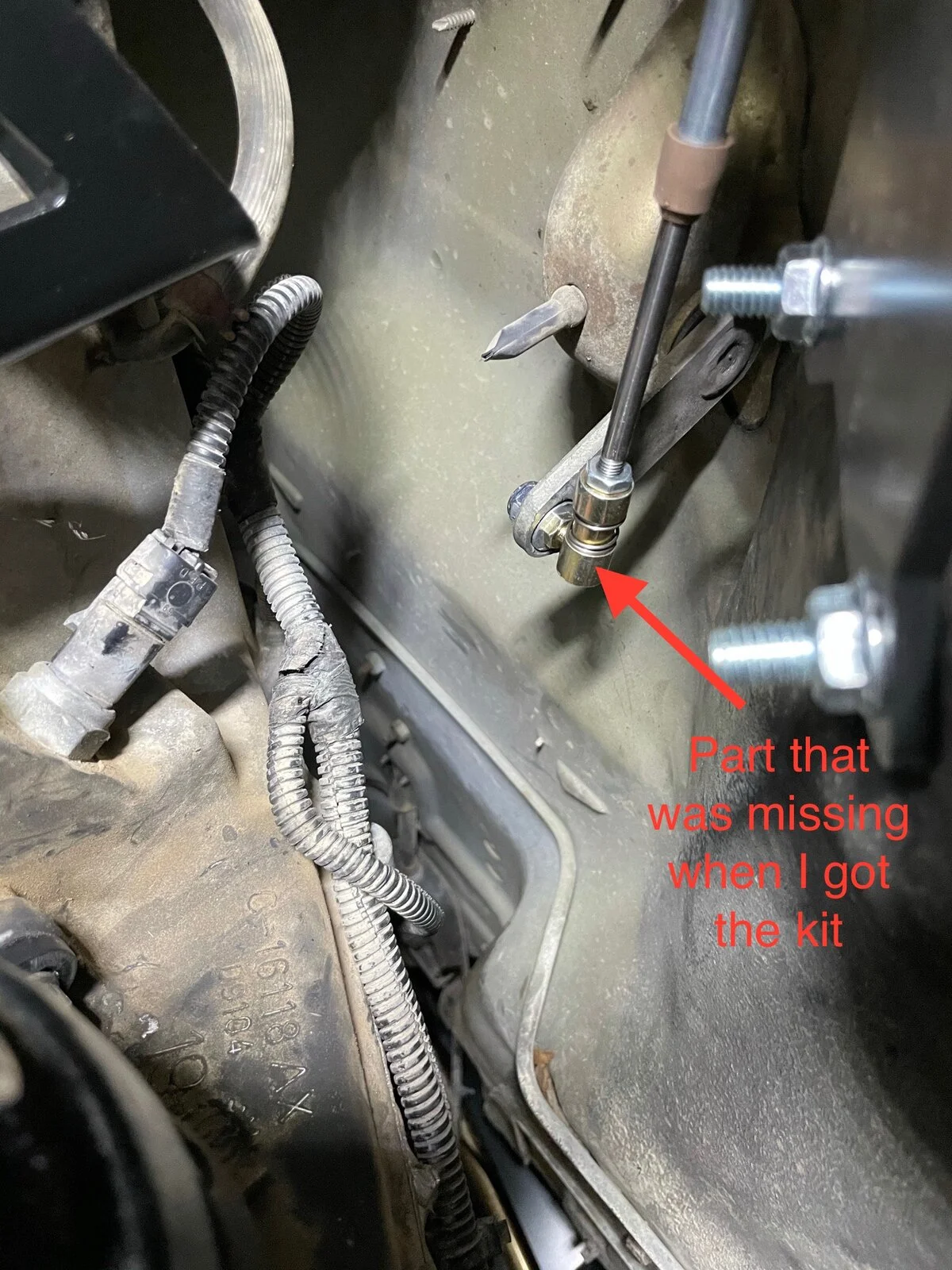

Well... I got the Savvy. Unfortunately it was missing a piece which held me up a couple days until Savvy was able to get me the part. Now that its all installed it is a smoother shift, but unfortunately it still seems to bind and not want to drop back into 2wd. The shifter IS bringing the lever fully into locked 2wd position, so its not an adjustment issue. Anyone have an idea of what could be binding and causing this trouble? It still goes back easily if I reverse, but moving forward it just doesn't want to disengage. I'm pretty frustrated and really hoping its something stupid and simple that I'm just not thinking of! I have to imagine someone on here has had a similar issue....
Thanks!
Pictures of the install...

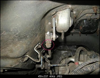

Try this process from Jerry Bransford, worked perfectly for me, after I removed my T-case drop spacers and experienced similar issues as yours.
Your shifter isn't adjusted properly to be able to pull it completely into 4Lo, that's why it's slipping out. Body lifts and tcase drops can both affect that. Adjust the linkage by loosening this bolt, circled in red, adjusting the rod so it can pull the tcase all the way into 4Lo, then tighten the snot out of that bolt so it can't slip out of that adjustment.
This is irrelevant because he has installed the Savvy cable shifter now
