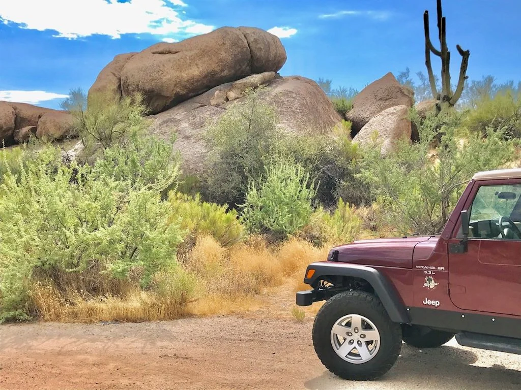

We all still want to SEE pictures of this TJ w/LS swap in it. You've been talking about it now for at least 2 years but we've never seen even a single photo of it...
Come on share some information about it and some photos. We all like seeing a good swap photo.
And anyone that would like to drive you are more than welcome.
