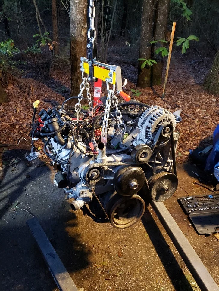

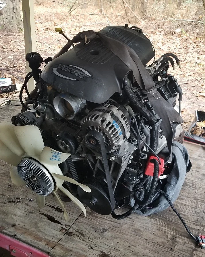

Had to acquire the engine from Texas but the trip wasn't to bad and she made it fine.View attachment 73890

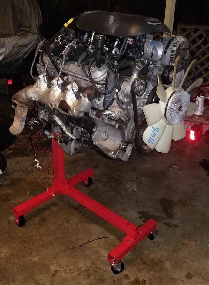

Got her Unwrapped and ready to put on an engine stand
Thought I could make this more... dirtable… since my carport it pretty small... turns out it doesn't work well because the engine is pretty top heavy... weird! hahah
Either way, There it is, just waiting to be installed!

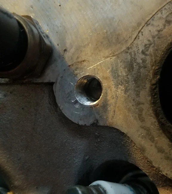

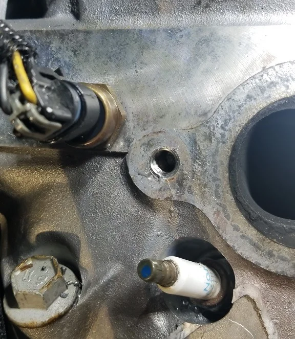

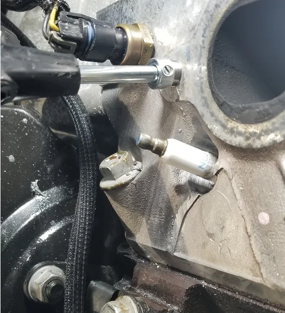

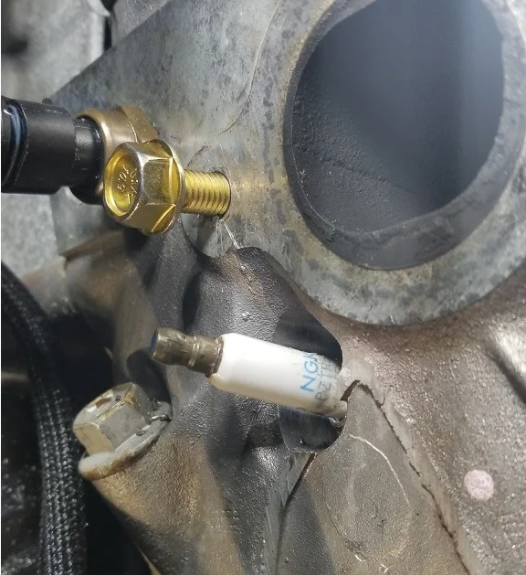

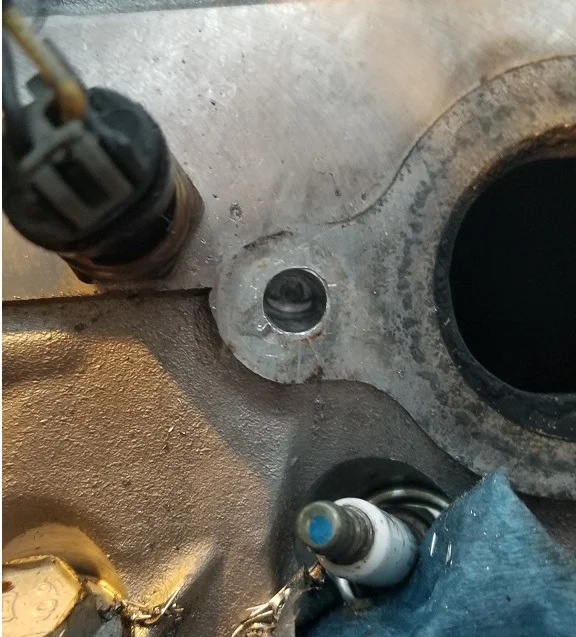

So, I took another hack at the heads today and was able to rescue the hole. I went at it with a new bit, cleaned out a lot of the bolt and then just drilled it out so I could tap it and install a heli-coil to match the original thread size. I managed to get the last bolt out tonight as well. I took my Dremel with a very narrow bit and but out a groove to make it like a flat head bolt. I then took my impact driver backed it out... by far the easiest bolt to recover and I think ill try that from here on out. I didn't have pictures of that, but here's how I repaired the second stuck bolt hole

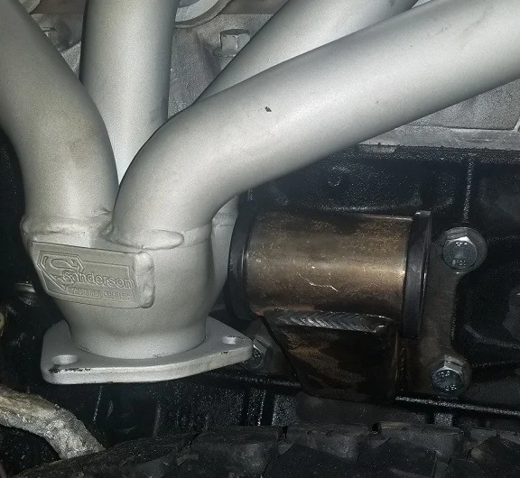

Anyone doing an engine swap using Novak engine mounts and is looking for some freshly painted and properly cured headers? Turns out these headers don't work to well with the Advance Adapters engine mounts. When you look at the pictures, I still have to fit an 8th inch piece of metal and a bolt head between the exhaust and inner mount... with out it melting bushings... so I'll probably just have to use the stock truck manifold which is what advance adapters recommend since they don't have one made yet... it just sucks... if the manifold was shifted back maybe half an inch it'd be no issue....
Oh well. When I painted the headers I used the VHT paint, primer and clear coat. I used three coats of primer, three coats of paint and then two more coats of satin clear coat. Let it dry for an hour and them baked it in the oven per the recommended temps. So 30 mins at 250 degrees, cool 30 mins, 30 mins at 400, cool 30, and finally 30 mins at 600 degrees. The coating isn't chemical resistant unless you cure it properly which a lot of people skip and end up with crappy results later down the road. Either way, they cost about $350 unfinished, they apparently don't need gaskets because of the way they're designed... seems weird to me but go check them out, either at the Novak site or on the Sandersons Street Rod Headers website.
But if anyone's interested PM me. Don't mind my greasy prints on them, it'll wipe off. But here's the pictures to show you what I'm talking about though... I guess it wouldn't be a project with out a few issues here and there... or in my case... here... and here and here and over there! haha

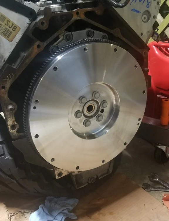

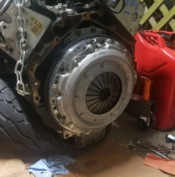

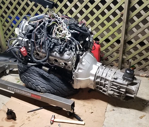

Installed the flywheel, clutch and transmission tonight. Had to make a few adjustments to the space and pilot bushing... the directions weren't to clear with the kit so I kind of guessed it... I was wrong but got it figured out when I tried to install the trans and it stopped about an inch short lol. Here's some pictures. Never mind the rats nest on top, I just tossed the harness up there to keep it out of the way when putting it in and out of the Jeep.
75274

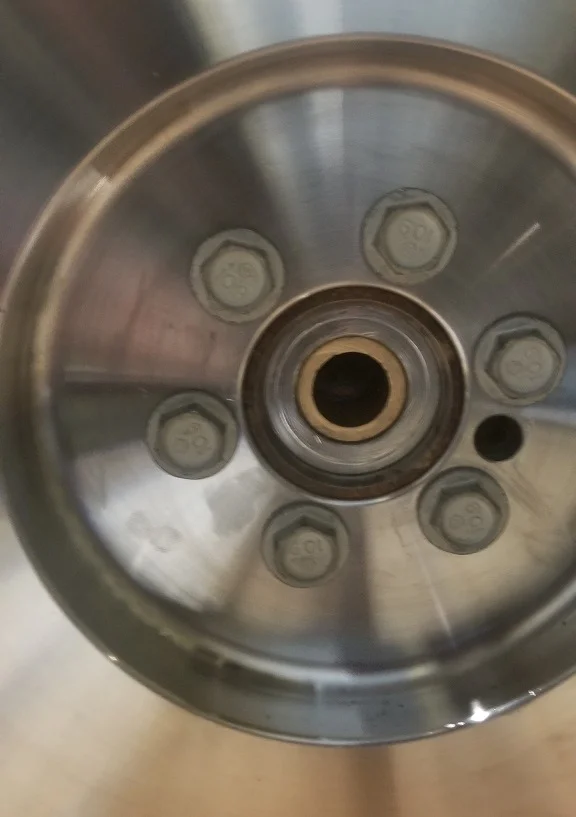

Here's the Pilot bushing and spacer I was talking about. Before I had the brass pilot pushing pressed in flush with the back of the spacer (silver circle around it) so it stuck out. I had to take a socket and tap it the rest of the way in. The most descriptive part of the instructions explains that the side of the spacer with the groove in it needs to face out... I figures its easier to tape the Pilot bushing in if its wrong than to try and get it back out later. Either way, it worked out and I got it set up right.
75275
75277
Everything bolted up well, but it's only held on by 5 bolts... I mean their strong bolts and you also have the 2 alignment pegs to help keep it in place...but I'd expect it to mate up to every bolt hole. there's one hole near the top that's maybe only half a bolts width off and it just seems weird that its not designed to line up... Anyways. It seems like a pretty good product so far. I'm excited to get this thing in the Jeep so I can get the driveshafts ordered
75278

Wait, your adapter doesn't match up to the block? That seems wrong. I think I'd call advanced adapters or Novak (whomever you got it from) and let them know whats going on. They may have sent you the wrong part?

So it does bolt up, but I'm assuming that they have a one size fits all bell housing engine bolt up pattern... and then they mill out the trans portion specific to the trans being used. They have a part that specifies with the gen 3 engines, you may only be able to use 5 bolts and I think it's because the same bell housing can also be adapted to older GM engines that have a similar but slightly different bolt pattern. I can cut a notch out to allow the last bolt to be used, but i dont think itll be necessary. I just think they could have elevated the top part of the housing and drilled it to specifically for the gen 3 and it would add an extra comfort

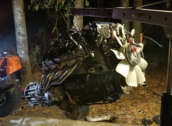

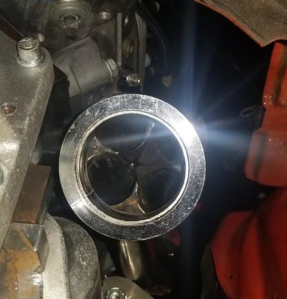

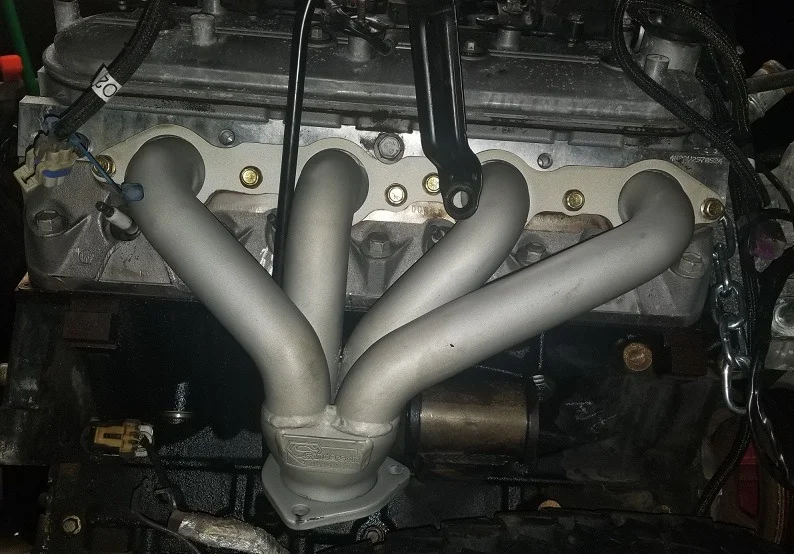

Got some new headers in today and tried to test fit the engine with the transmission attached. Turns out that my engine lift is to short. If only I had an extra 3 or 4 inches I'd be able mount it with the trans. I'm headed to harbor freight tomorrow to pick up a 2 ton Lift. It has over a foot of extra length to the lift arm so I shouldn't have any issues. Right now the hydraulic cylinder is hitting the front of the jeep frame. I got my new speedhut gauge in as well so ill toss some pictures of that up later too. Unfortunately its raining its ass off right now so I cant really do anything more with the jeep. Maybe ill go get a 10x10 sunshade and pop that thing up over the engine bay lol... with the temps starting to pick up, it might not be a bad idea anyways. Don't mind that I have the hood resting on the lift. I was done for the night and wanted to cover it as much as I could before the rain came lol... don't want people telling me "It'll really help if you lift the hood up" haha.
77070
I was a little worried about the clearance of the end of the headers, but so far it looks like its going to clear everything just fine
77071
It has a neat pyramid to help prevent turbulence as the exhaust meets together... not sure if it'll help much, but I thought it was a pretty need added touch that I haven't seen on some much more expensive headers.
77072
Just needed 3 more inches!!! I even have the arm over extended and it was still short... Don't try this at home disclaimer?

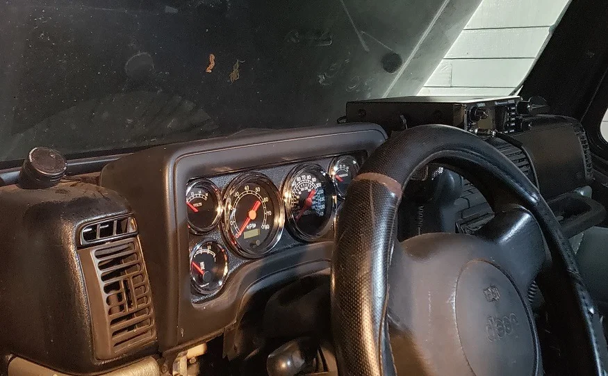

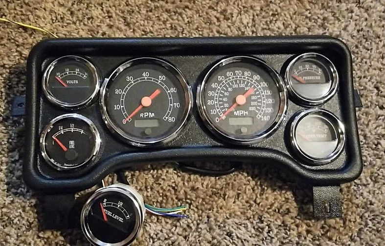

I tried to match the new gauge up as much as possible. It's not perfect but its not really an eye sore. the most noticeable thing is being able to see the bottom of the needle.

Hey there, I know this is late info but if you take an old exhaust bolt and weld it to the broken stud you can back out the broken manifold bolt. I am in the middle of a 5.3 swap on a 98 tj and went through the same mess you did. I just have a flux welder I use and it worked perfectly. The steel welding wire does not stick to tha aluminum heads. Same thing happened when I changed my NP231 input. I broke a bolt and used this method to extract the steel bolt. Good luck on your build!

Hey no worries, Yeah I tried, the bolt was broken to deep to be able to weld to it. I ended up taking a carbide bit and basically cutting a line in it and was able to back it out with a flat head. The other ones were a huge pain but I got all three out so that's always good.

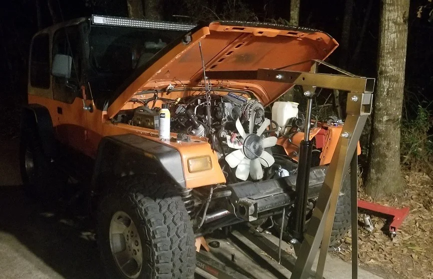

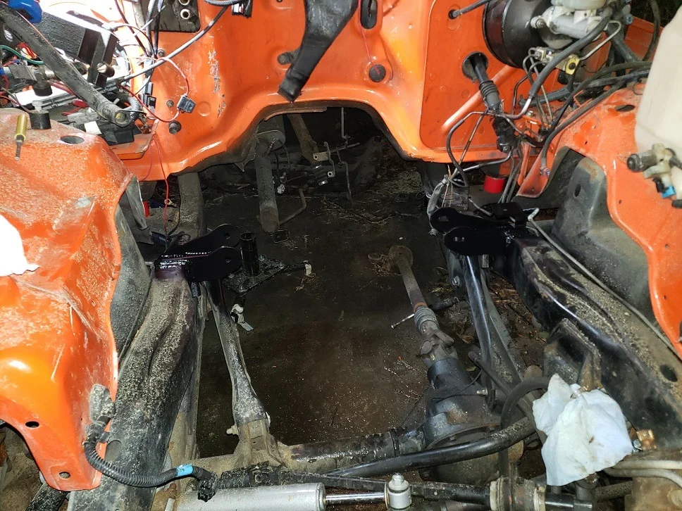

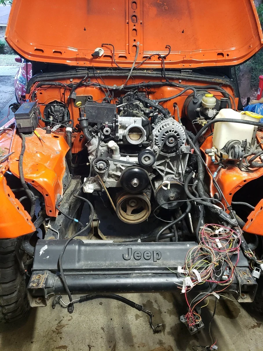

So it's been a while since I last posted. Work has really been keeping me from completing this thing... well and the project itself. I'm still having fitment issues with the exhaust even though I installed a 1 inch body lift. I took the exhaust manifold off and got it all bolted up but then found out that the newer NV3550 output shaft was a 23 spine and my orginal transfer case off my AX-5 was a 21 spine so that was fun. I got that all taken care of, I bolted up the transfer case and I finally got to take measurements to order my SYE and CV drive shaft combo. I've worked on the wiring a little but I need to do some more research on that. So now it feels like I'm on the homes stretch... sort of. There's still a lot left so I'll probably start a checklist so I can see how much progress I have and what's actually left to do. Here's some pictures of what I've done though. There was a pretty long process of putting the engine in, tack welding the mounts, pulling it out, putting it in, pulling it out again, letting it sit around for a few weeks, Hitting stuff with hammers and so on. The pictures start with the fully welded mounts and actually having the engine mounted. Enjoy.

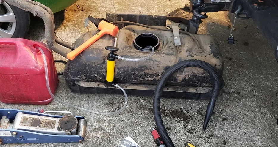

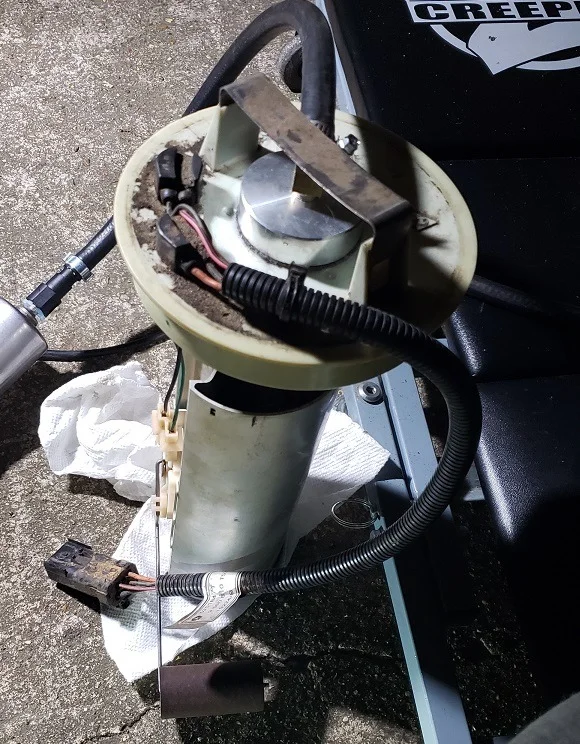

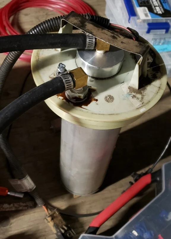

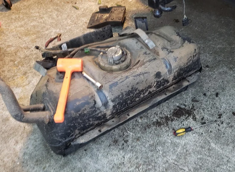

Dropped the fuel tank and installed the Novak pressure regulator bypass and return port. I added some fuel resistant RTV to make sure it all sealed up well. and then I pulled out the dash and test fit the new gauges and they look pretty good. I might paint the mount flat black to match the rest of the dash, but I'm diggin it.
