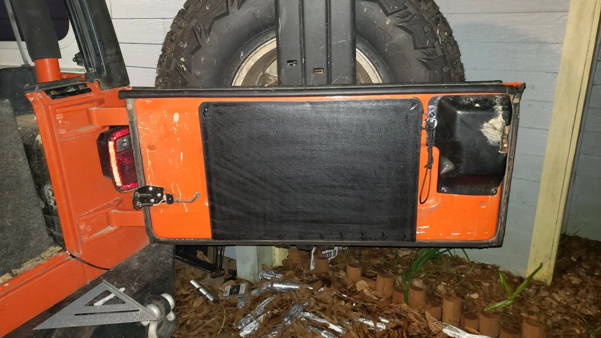

I did some things cause I got bored waiting for parts to come in. Also ordered a new water pump after swapping the pullies because the squeaking is still there and its killing me. That'll be here today. The airbox I showed doesnt seal in the back so it's useless for a snorkel and the prefilter cap is massive so I'm sending those back.

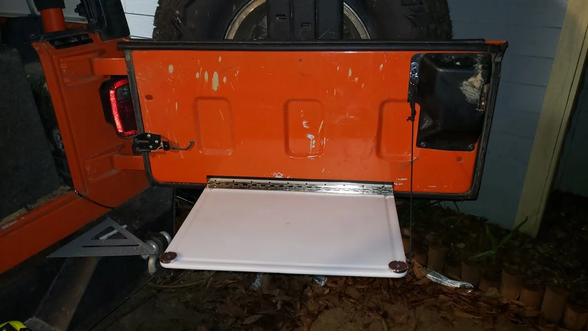

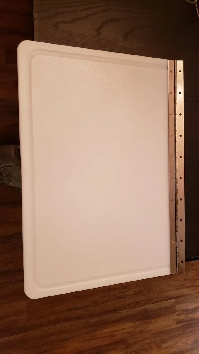

But check out my back door table. I just found the biggest cutting board I could find at walmart, bought some magnets, a hinge and some hardware to tie the paracord too then mocked it up. I used extreme double sided tape for now incase I dont like it. I'll hard mount it later if I do
No turning back!!!😬
Came out well though. The template sent with it was pretty good quality too. It was a thick glossy paper and lined up perfectly.

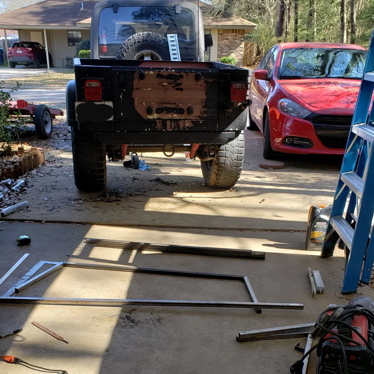

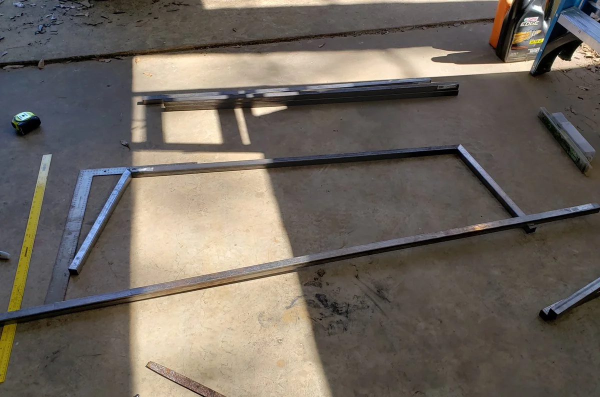

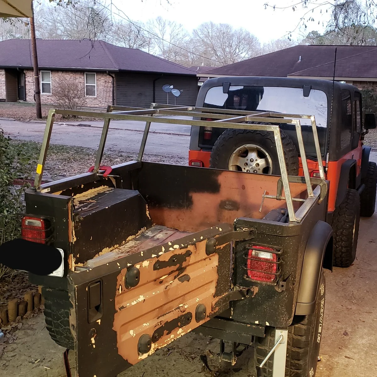

Finally fixed the blend doors for the heater. No more foggy windows. But other then that I've just been fixing this YJ trailer up. Grab some stock fenders for it and started building a rack I can toss a tent on. I only used 1 inch tube but from the calculations I did, I should be able to have a center point weight of close to 450 lbs per bar which the weight wont be on the center and theres three bars... I guess I'll find out when I give it a try hahah! I'm more worried about my armature welding skills more then the strength of the steel... 😬

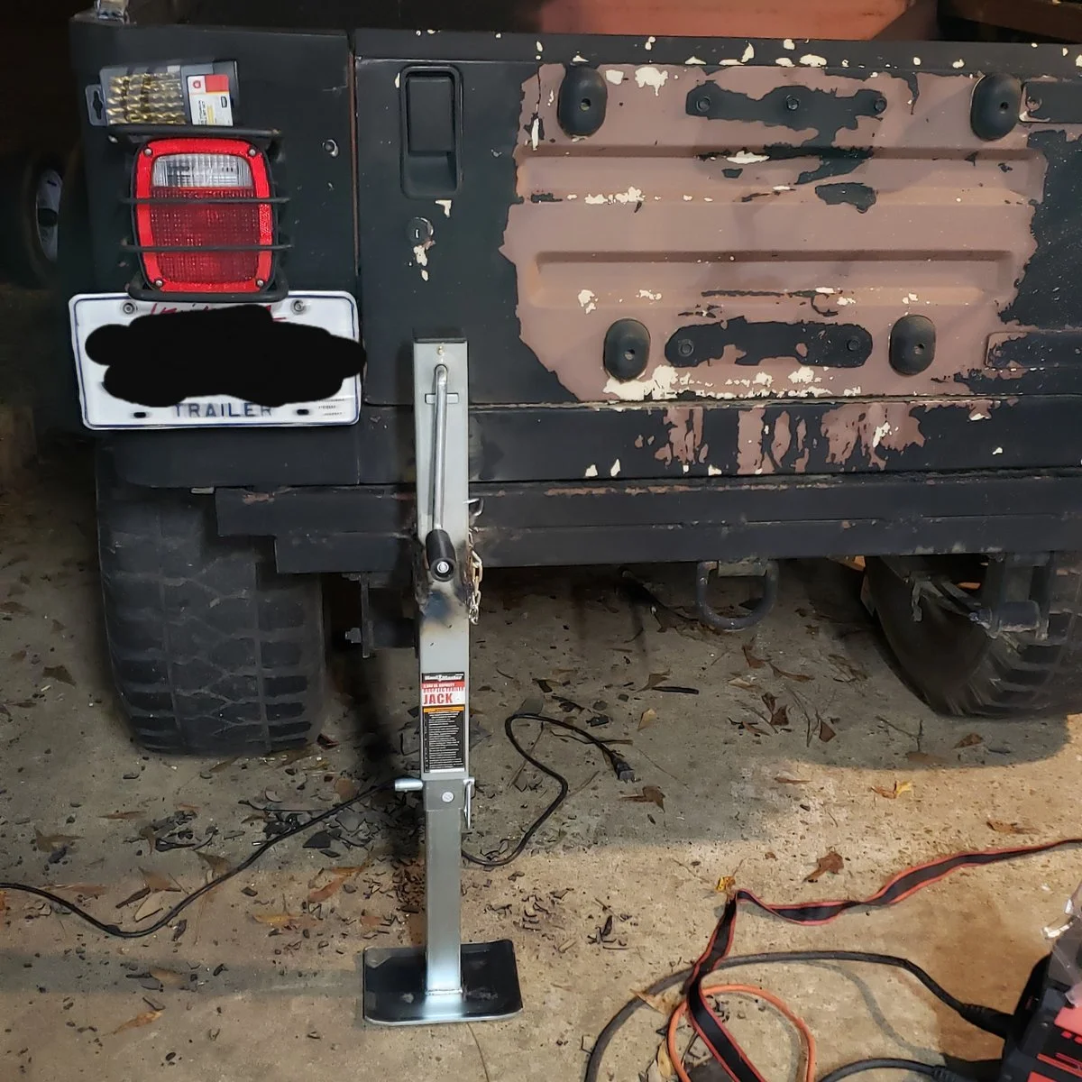

I'm adding rear Jack's so I can level it out too. Or jack it up to change a tire. I think later down the road I'll toss some brakes on it for better trail control but for now it's fine. I'm really hoping to go camping alot this year.

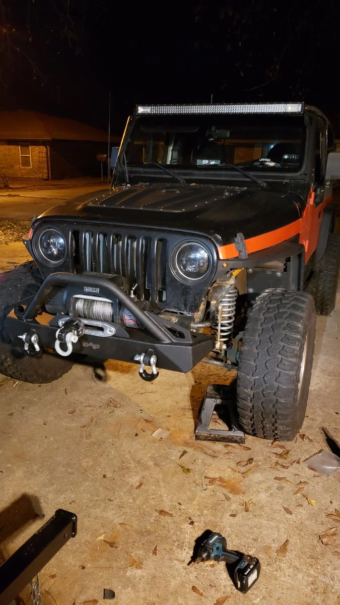

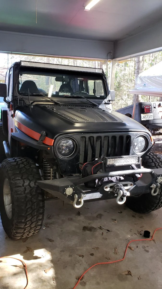

I'd go with that stubby CC front bump, once you paint it you can always touch it up later. Good progress.
I already bought the EAG one. I feel like everything gets replaced on a Jeep eventually. I'll probably change it out later down the road when I decide to make the thing more capable.
Reactions: TJ Starting
I have the EAG. It works fine and the stubby you got is cooler IMHO.

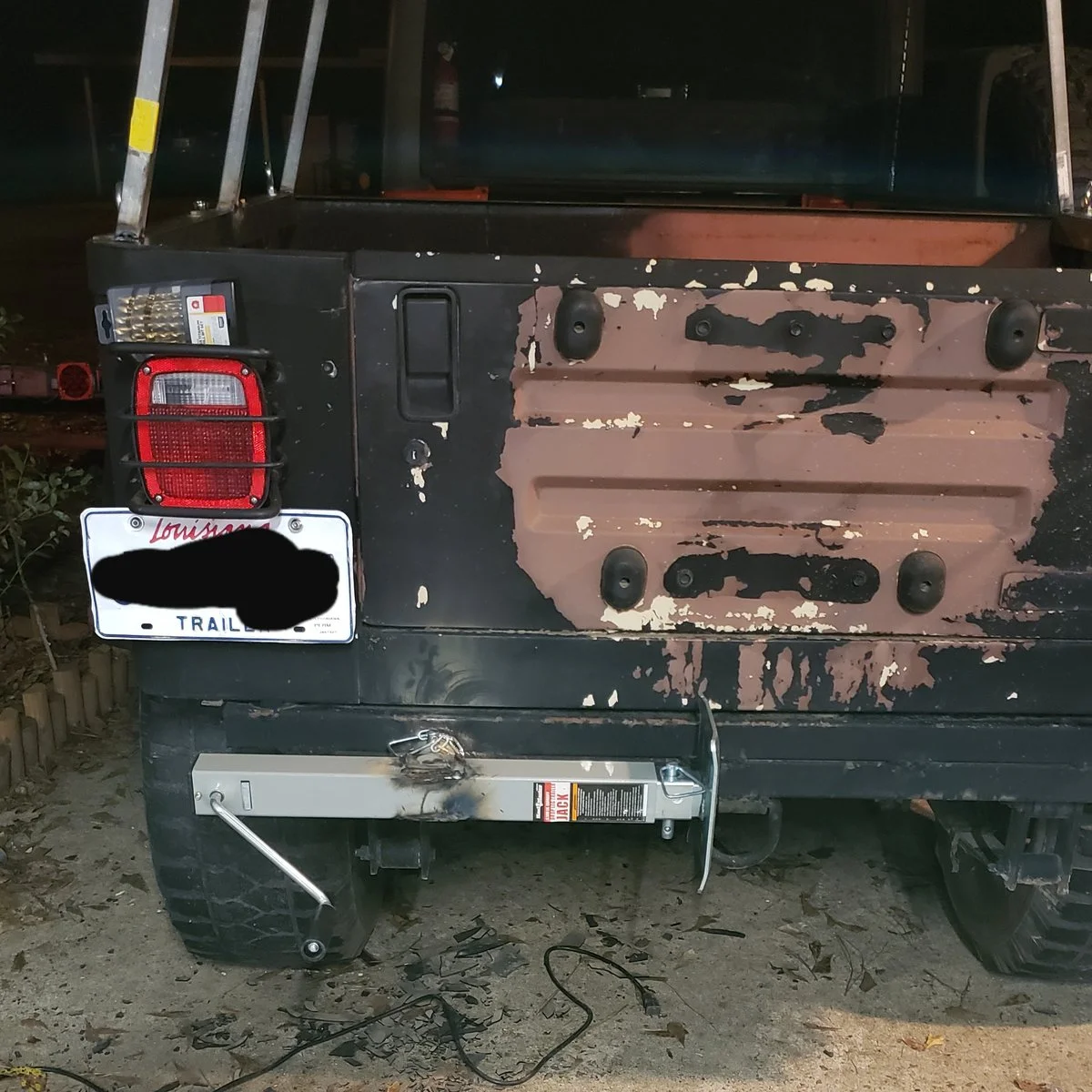

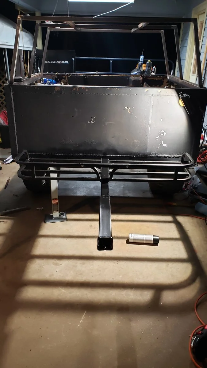

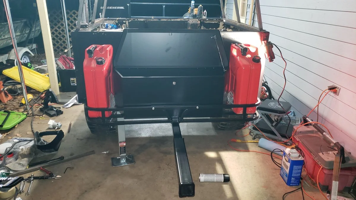

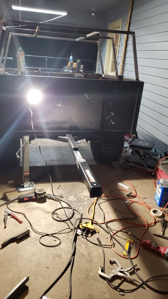

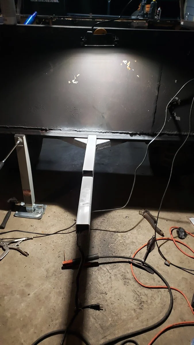

Did some more work on the trailer. Extended the tongue a foot with an 18 inch reciever tube for the pintle hook setup on it's way, and i can also upgrade to a fully articulating hitch later if I want... I cut the lift jack off so I can move it forward later... Added the front rack mount and utility box. Cleaned up some rust, primed and painted it. The weather sucked too much to pull the rack out and paint it but maybe later.

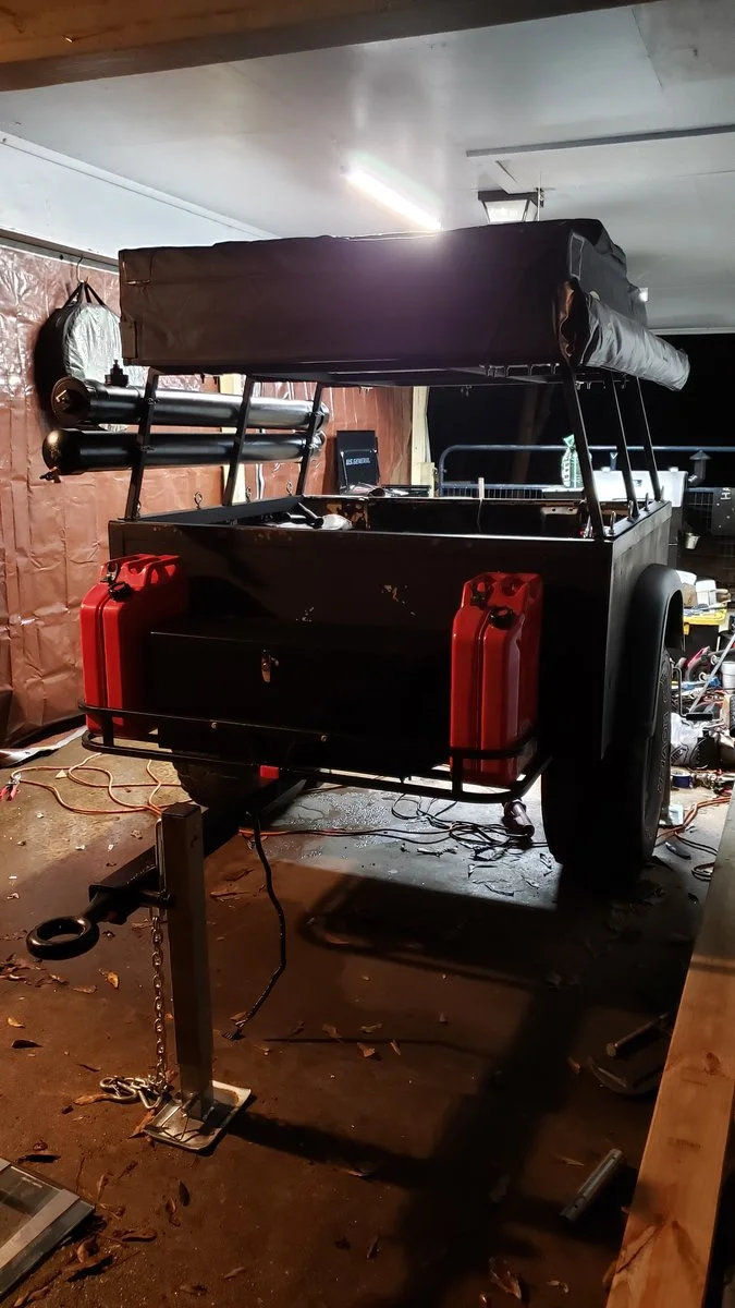

Got the trailer rack painted, made a water tank, installed the RTT and awning... I need to hard mount the tongue jack but other then that shes pretty much ready for some camping adventures. I found an awesome deal on some Lithium Phosphate battery packs that I'm going to build a 12v battery pack out of. I'm just waiting on the 100w solar panel and the battery management systems and then I'll start building the power system.
