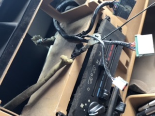

When I pulled the existing aftermarket car stereo out of our 97 TJ. I found the existing wiring wasn’t quite what I expected.
there is a two wire connector that was not connected to the existing stereo with a purple wire and a white/black wire. Any idea what those are supposed to connect to?
Also the ground was not going through the radio harness but soldered directly to the connector shown in the picture below. It was not bolted to anything but loose.
Any ideas what I am looking at?
Looks like all your factory wiring is still there which is good news.
The two pin connector is listed as connector 219, it's wired into the CCD +/- circuit between the PCM and the OBD2 connector. Your factory diagram shows it as not connected to anything:
The factory ground wire bolts to the stock radio itself, it's not part of the harness.
