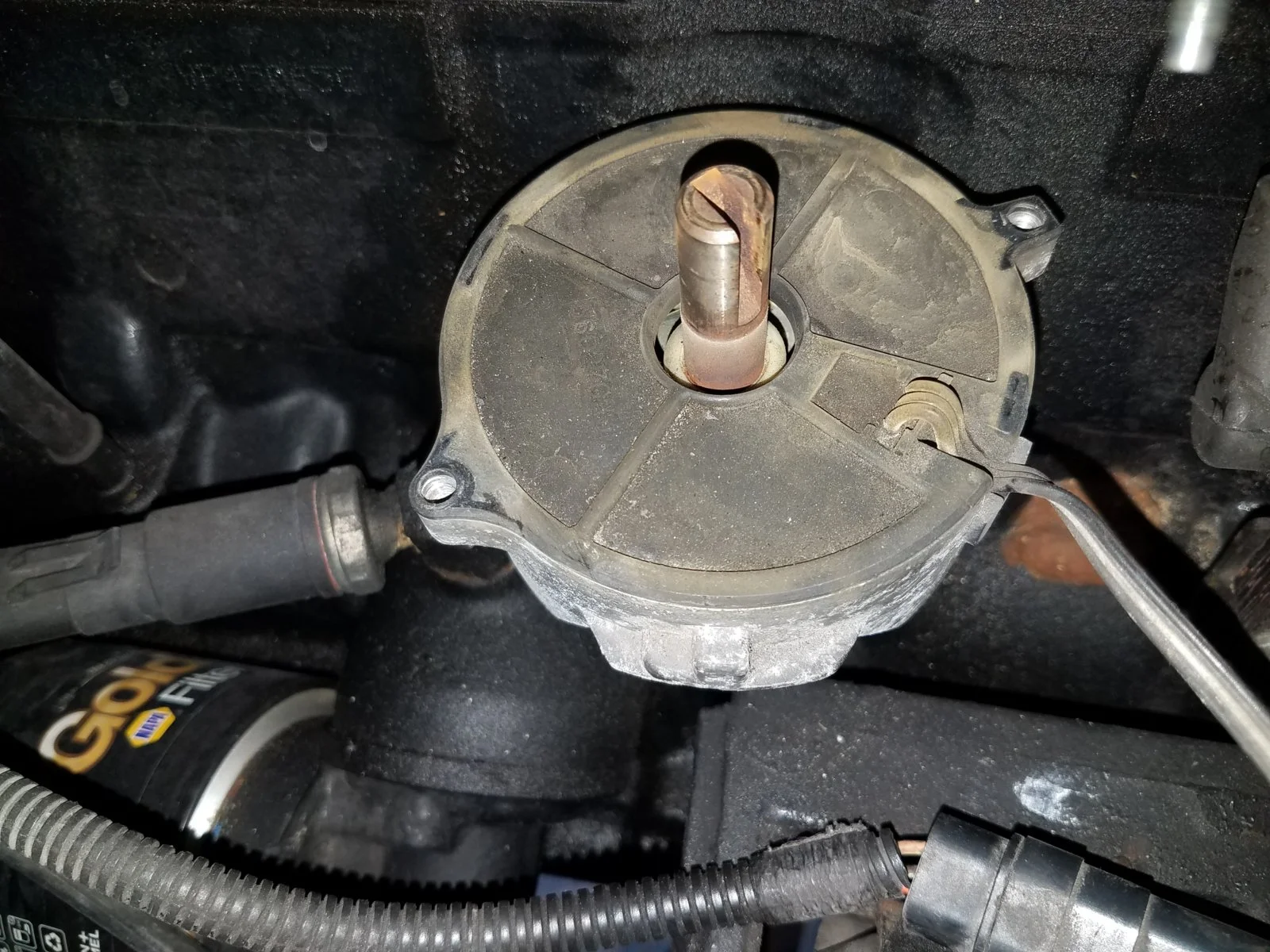

Symptoms:
  1. Hard to start, harder to start under 50F.
  2. Tach needle would go crazy right before stalling. Anytime, any speed/rpm.
  3. Wouldn't restart hot. Let cool for 10 minutes to restart.
Pulled codes via odometer/ keyswitch method. Code 54.

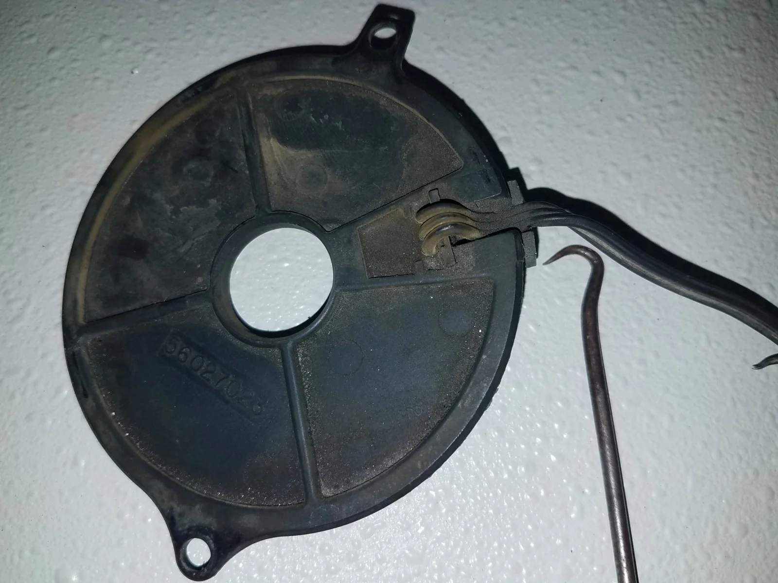

Pulled distributor and rotor to reveal CPS. Some parts houses call it a pickup. It's the plastic plate with 3 wires
75940
Now is a good time to ensure the distributor retaining bolt is snug. Mine was loose, hence the oil weepage seen in the first photo. A 1/2" crowsfoot and a long extension was all that was needed to put a half turn on the bolt. It's easier to do this before installing the CPS because the wires are in the way if you use a crowsfoot. Drop the CPS in place, don't forget the rotor, put the cap on.
I disconnected the battery for 2 minutes to reset the codes. They did not reset. Had to disconnect it 10 minutes to reset. 5602 7023 is the Mopar part number for the CPS
Results:
Starts up in 1/3 of the time.
Runs stronger with the AC on than it did without it before the fix (It's in the 80's here in S.Fla in February) .
I can do 70+ in 5th with the AC on with crappy 3:07 gears (2100 rpm).
Total time: less than an hour. If I had to do it again, probably 10 minutes
Skill level: If you know which way to turn a screwdrive, you can do this.

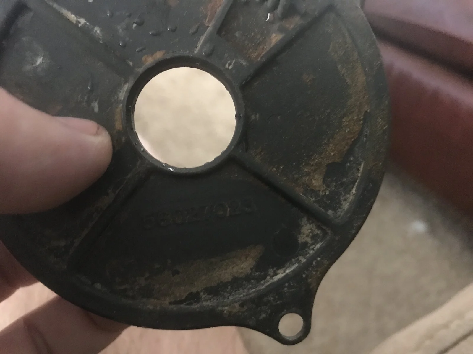

So… just put the new camshaft position sensor/distributor pickup in… was letting the jeep idle in the driveway but it shutoff still, interestingly a bit before it hit full temp with the new sensor. Can restart but shuts back off shortly afterward.
On a side note… I think the amazon seller pulled a fast one on me. Was supposed to be a Mopar sensor, came in a Mopar box… but it doesn’t have the number stamped on it like the one I pulled out
Can anyone confirm that newer Mopar sensor still have that stamped in?
Also, I’ve seen a couple places where people said the NAPA one is actually good… but for the later models. Can anyone confirm this for the early style?
+1 following. I'm dealing with the exact same issue for my 97 TJ Wrangler 4.0L. I think I just got burned by the same Amazon seller.
Hate to hear that man, I ended up returning it and cleaning up the old. Never ended up buying another one because all my issues went away when I disconnected, cleaned, and reconnected the main spark coil and it’s connection to the ecu.
