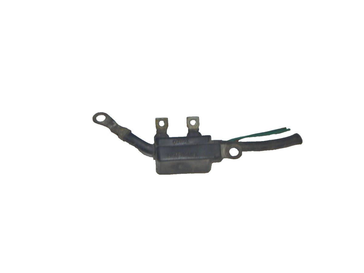

I appreciate the response! My TJ has the old style alternator connector that doesn't have a plug. Here's a generic picture of it below. I haven't messed with my Jeep yet due to weather in my area, but the plan is to probe that thing with a multimeter while the Jeeps running. I'm just an electrical novice and I'm not quite sure how to determine which point on the connector receives the signal from the PCM. I've also read various different methods of bypassing it on this forum alone, some jumping ground and some jumping hot, that I'm not sure which to follow for my specific connector.
Regardless, I need to give all wiring another thorough onceover just to make 100% certain, and if anyone could share which specific grounds relate to the alternator/PCM circuit that would be awesome. The one on the passenger side of the block is for sure fine, as I removed, inspected, cleaned, and rebolted it first.
Once I've 100% ruled out my wiring and a potentially DOA brand new alternator, I'll for sure be sending the PCM off to Mark at WranglerFix. Just hoping to get lucky and find out its a broken wire or a bad alternator.

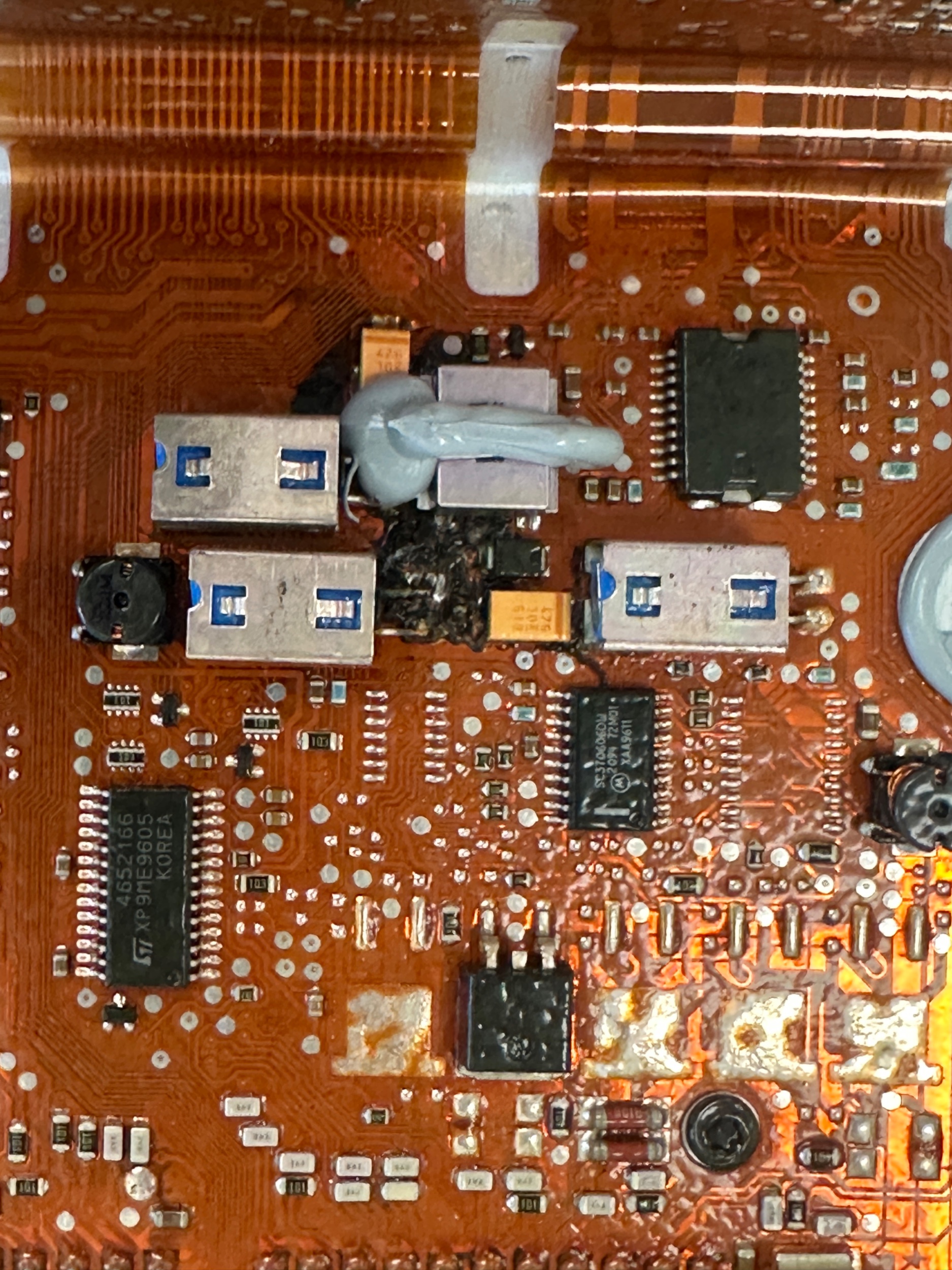

If I pulled 20 cores from the 97-98 pile they would look like this. The capacitors used are from Taiwan and are missing a critical ingredient that stops them from exploding. 🇹🇼
  • Sad
Reactions: lBasket
Ah man that's not surprising. Don't suppose there's much I can really do preventatively?
I'll be sending it off to you here in the next few days though.
