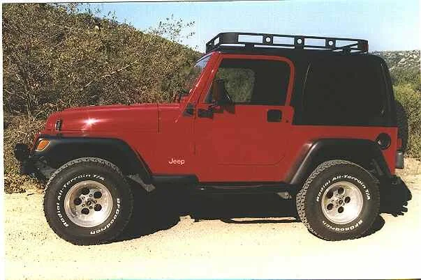

If the load is well distributed, like from a rooftop carrier that spreads the load among its mounting points like the Con-Ferr carrier I used years ago, I'd guess 75-100 lbs. would be safe. I carried a soft luggage bags occasionally on mine and my wife's alone had to weigh 50 lbs.
Mine had flat steel pieces going across that rested directly on the hard top which did a good job distributing the weight.
This from many, many years ago. :)
I agree with Jerry. If the load is evenly distributed I would think up to 100 lbs. would be safe. I would not attempt to push it beyond 100 lbs.

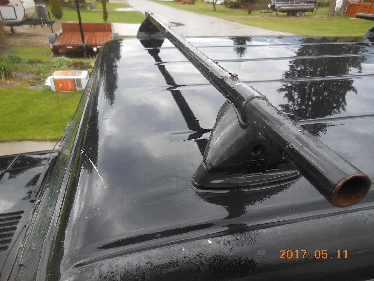

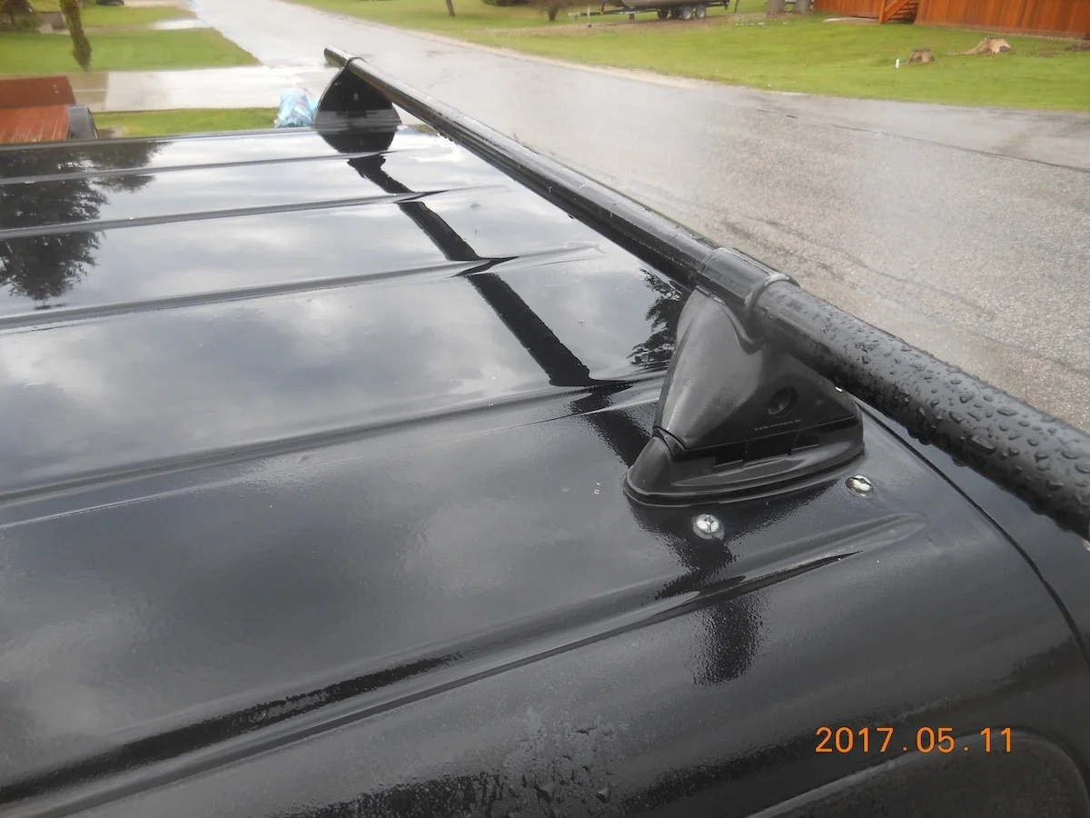

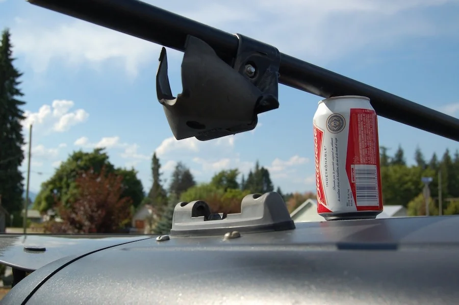

Love how quick the Yakima System comes on/off.
Any chance you have an overhead picture of where you mounted all 4 of your Landing Pads/Towers?

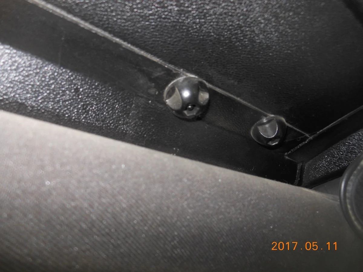

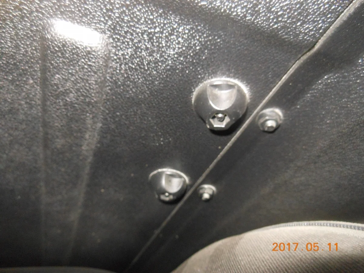

Looking for where exactly are the best spots to "drill through" on our hardtops. I just bought a new Yakima setup like yours and am looking to do the installation in the next couple days. The instructions that come with are specific to fiberglass hardtops in general but not specific to TJ's. So curious to see if you recommend any sweet spots or have any tips/insight?
Thanks!
Heres the rear. On my YJ I put the holes same distance apart but the TJ roof shape changed and the is a slope, taper to the rear on the TJ.... hence the extra holes. I'd bolt down the front, then adjust the rear till you get the bars level. Then drill in the rears.
Reactions: EJD

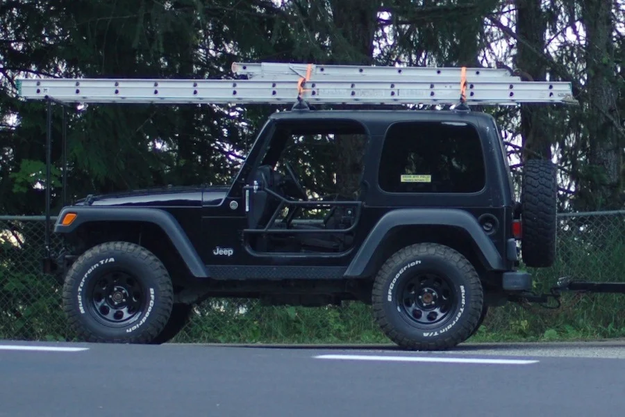

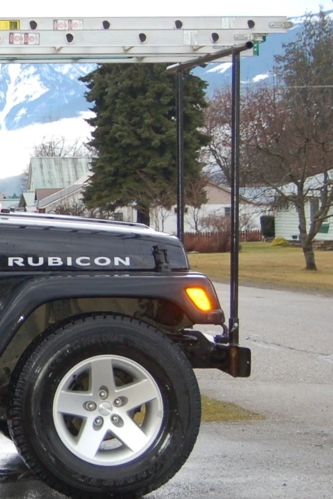

Hey billiebob is that a 32 ft ladder on your jeep? I'm about to use mine for work and I have a 32 ft, also a 24 ft. If it is how bad does it drag in the air on the road. Thanks
Thats kind of a cool contraption, did you make that custom? or is that something thats sold somewhere?
You could use that for a big canoe or kayak/SUP too I bet. Nice!
On a TJ?? You won't even know it is there. Mine is a 28'. Fits with less than 2' overhang. I have a third cross bar off the bumper too tho. I wouldn't do more than 10' without it.
Ok thanks for the info I'll send you a picture of what I've done once it's all together. I'm putting a smittybilt rack on because I use my soft top in the summer. Your the only guy I've found that's using a jeep to haul ladders. Thanks again
